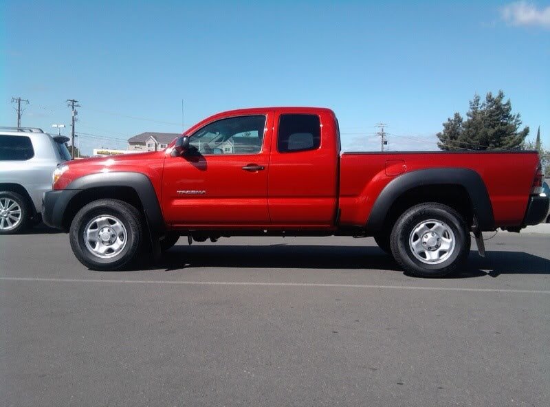

    I bought the truck brand new off the lot. It has 4,400 miles on it. The only thing I've done is put the step bars, tint the windows a tad and the wheels/tires.
    No idea. Here it is before the wheels and tires.

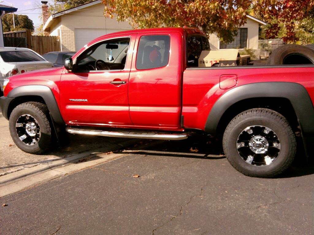

    After

    Nah, that's just the combination of 1" oversized in diameter, with a big negative offset.
    I'm with KPT - go with a wheel with more backspacing and positive offset.

    Well I went back today because he called and said he got the smaller size tires in. Instead of 265/70 he has 265/65, same BFGs. And yes, the tires are safe to put on rims that are 7-9 inches.
    That was the key. I was able to keep my wheels and the truck has absolutely no rubbing at all! It was a half inch difference in sidewall height and that's all that was needed! :)
