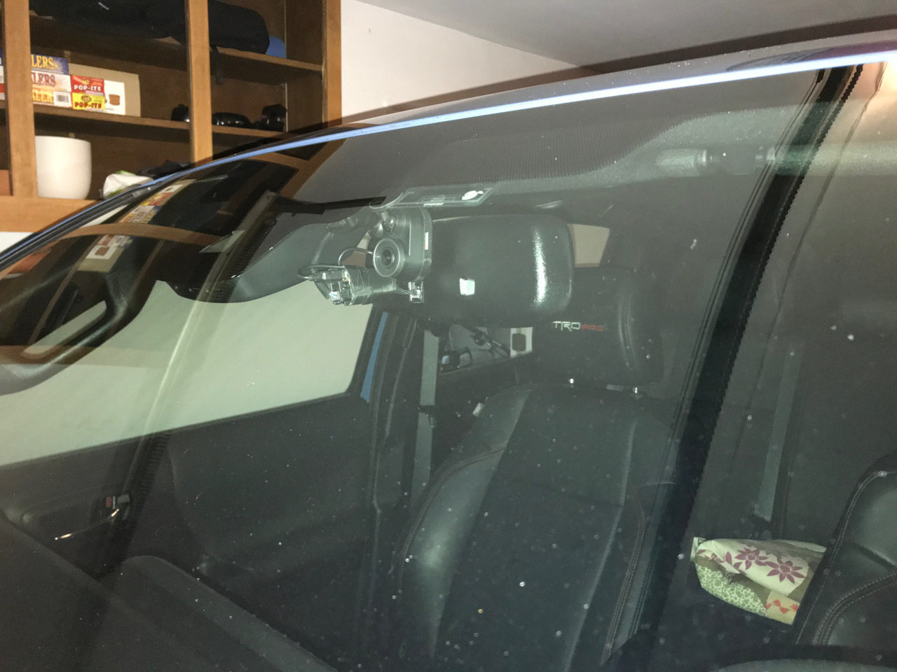

    Garmin Mini Dash Cam + Amazon Mirror to USB Dashcam adapter. It took longer to open the box than it is to install it. 1080p, 30 FPS. Test drive report coming soon. The Garmin dash cam is so small that there is no need to remove it when parked.

    What is it plugged into in the back of the mirror? I did not realize that was there. I need to tuck my setup up.

    Tech dinosaur here, just to be clear the adapter plugs into back of mirror, the mirror plug and dashcam power supply both plug into it?

    It’s a 12 pin plug, I believe it’s for the auto dimming. I didn’t know it was there either

    Yes, it's that simple. I took it for a test ride today and downloaded the videos. It was clear and you can read a car's license plate pretty easily. I tried to upload via Youtube but the compression took all the clarity out of the video. The only downside is downloading any video from the dash cam to your phone can take a while. It's way faster to just take out the micro SD card and download it using an SD card reader to you laptop.

    Super low profile so it doesn't block any part of the windshield. It tucks in nicely behind the rear view mirror.
