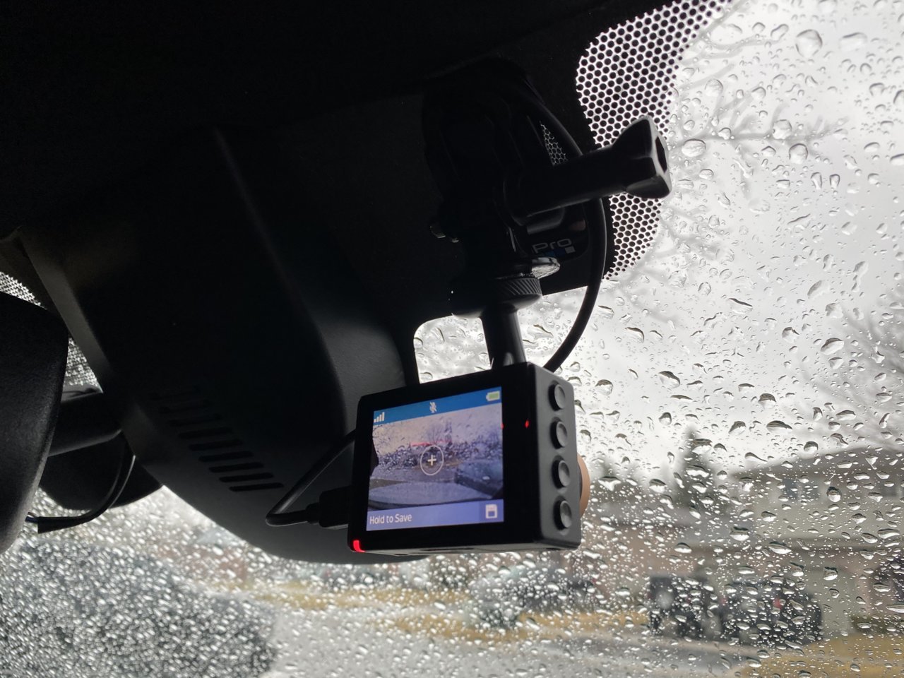

    In my case, I wanted the cam to be on while parked because there were kids breaking into cars on my street. I was able to provide pics to the police in the end. But if you don't need a parking mode, simpleUSB seems like a good solution.
    I think the reason that you are not getting the charging error, or at least it was the case with me, is that if battery is fully charged, it does not report the error. Battery is never discharged due to having a constant source of power.
    Here is what Garmin sent me.
    Hello,
    I just got into work and had an answer to the question about the resistor.
    “The ID resistor we are using in our cables is internal proprietary information. They are used in conjunction with other methods for identification of the cable with our devices, but specifics of that identification are not intended for public information.”
    Rick | Product Support Specialist
    Here's my setup, truck has been off all night. You can see that there is no "lightning" symbol on the battery status, it's because battery is not being charged. Does your unit show a lightning symbol?

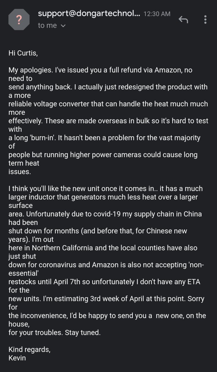

    I noticed this morning that my garmin mini didn't power up when I started the truck. I decided to mess with the wires and the simple usb connector was hot, as in melting the heat shrink hot. I sent dongar technologies an email, so we'll see what they say about it.

    It's somewhat alarming that this is now the third failure that I'm aware of. Yours and one other that overheated, and one that overheating wasn't reported @robnpatb .
    In at least one case, Dongar said to keep the broken one, and they would replace it when stock is available. But we really don't know how many of these have been sold.
    Don't throw your old one away.. the circuit board is and inexpensive repair.

    304_Taco
    304_Taco Well-Known Member
    Aug 8, 2017
    #226250
    962
    Curtis
    Morgantown, WV
    16 TRD Sport DCSB MT
    I sent dongar technologies (simpleusb) an email yesterday explaining what happened and here is the response I received. If you are having issues I recommend contacting them, he seems like a stand up guy that values his customers.
