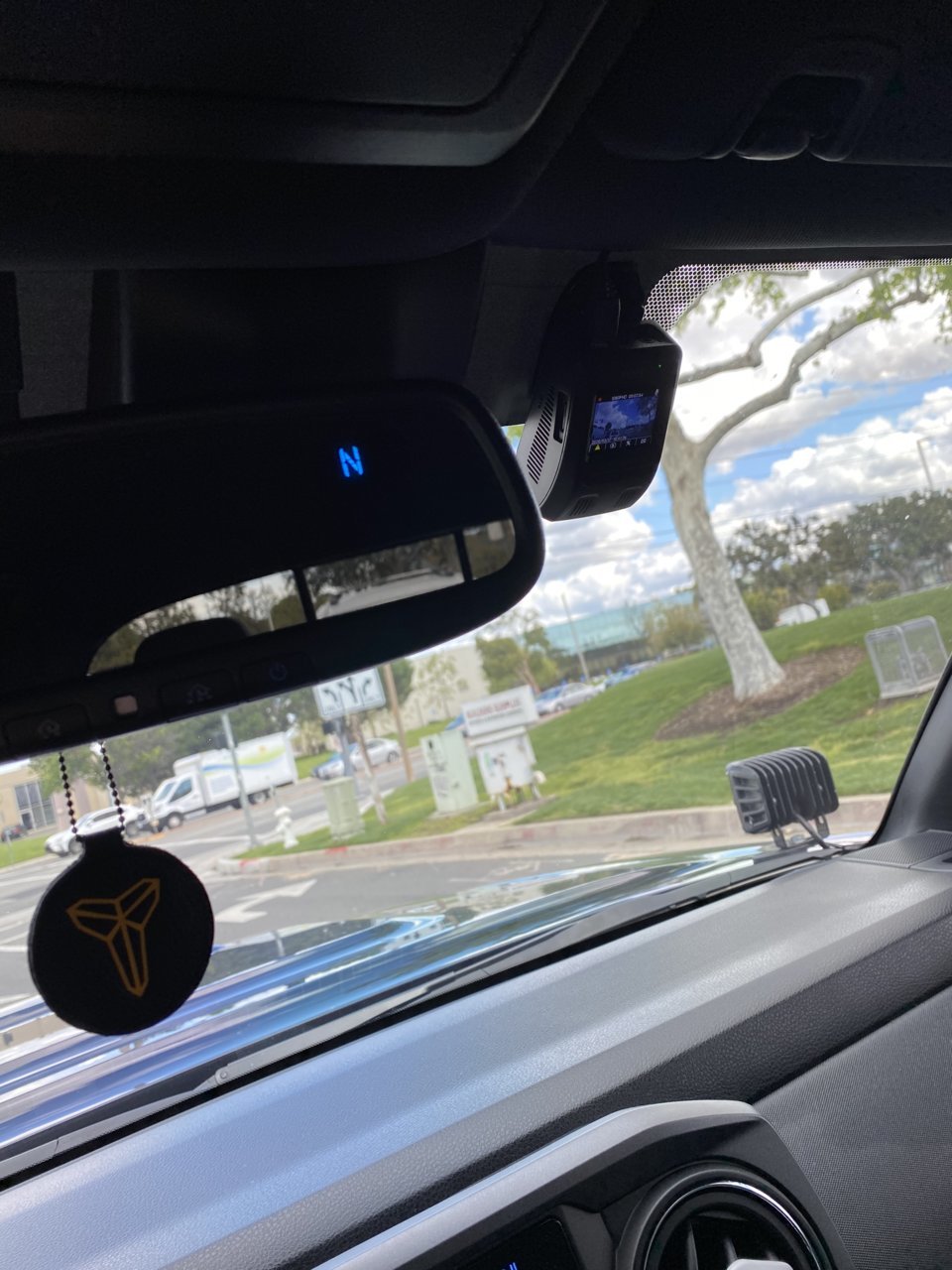

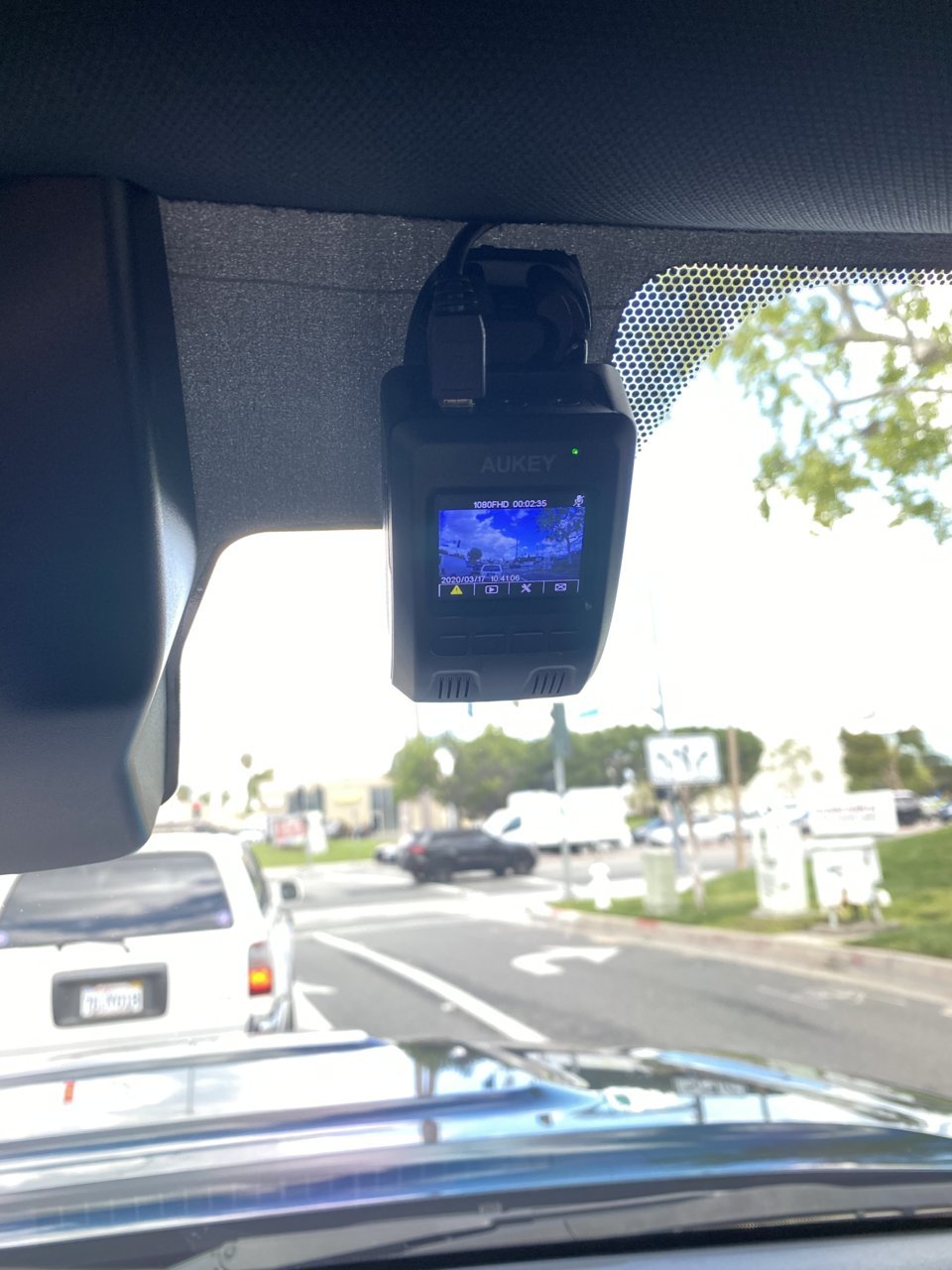

    ordered a 3d printed dash cam mount, stuck to the existing gopro mount on the windsheild, tucked the wires, and VOILA! sleek, compact, and Effective! :)

    Come on now, you cant be sayin that and not post up about the mount!

    haha sorry. heres the link to the 3d printed go pro mounts. theres 3 mounts to choose from for 3 different cameras. only con is that you are limited to 3 cameras to choose from since the guy who made the mounts for 3d printing didnt make anymore.
    https://www.shapeways.com/shops/rexing-dashcam-to-gopro

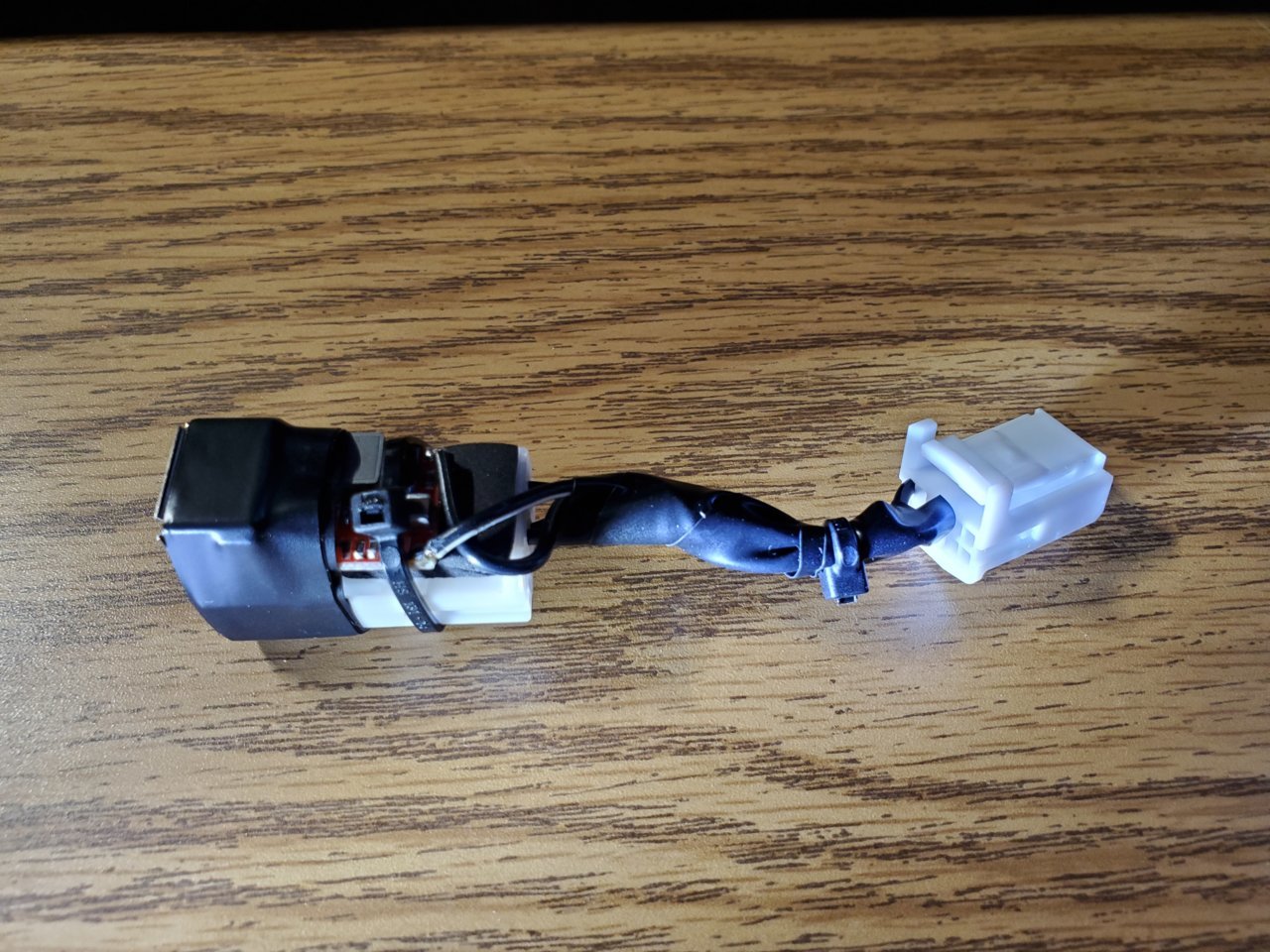

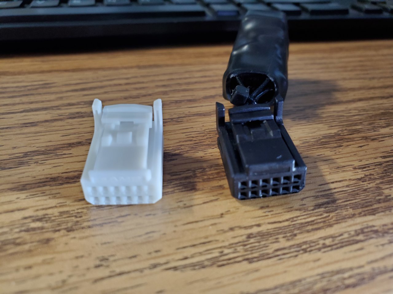

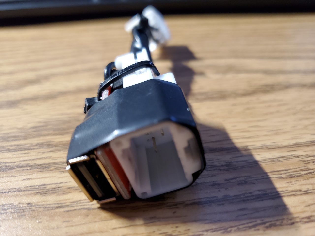

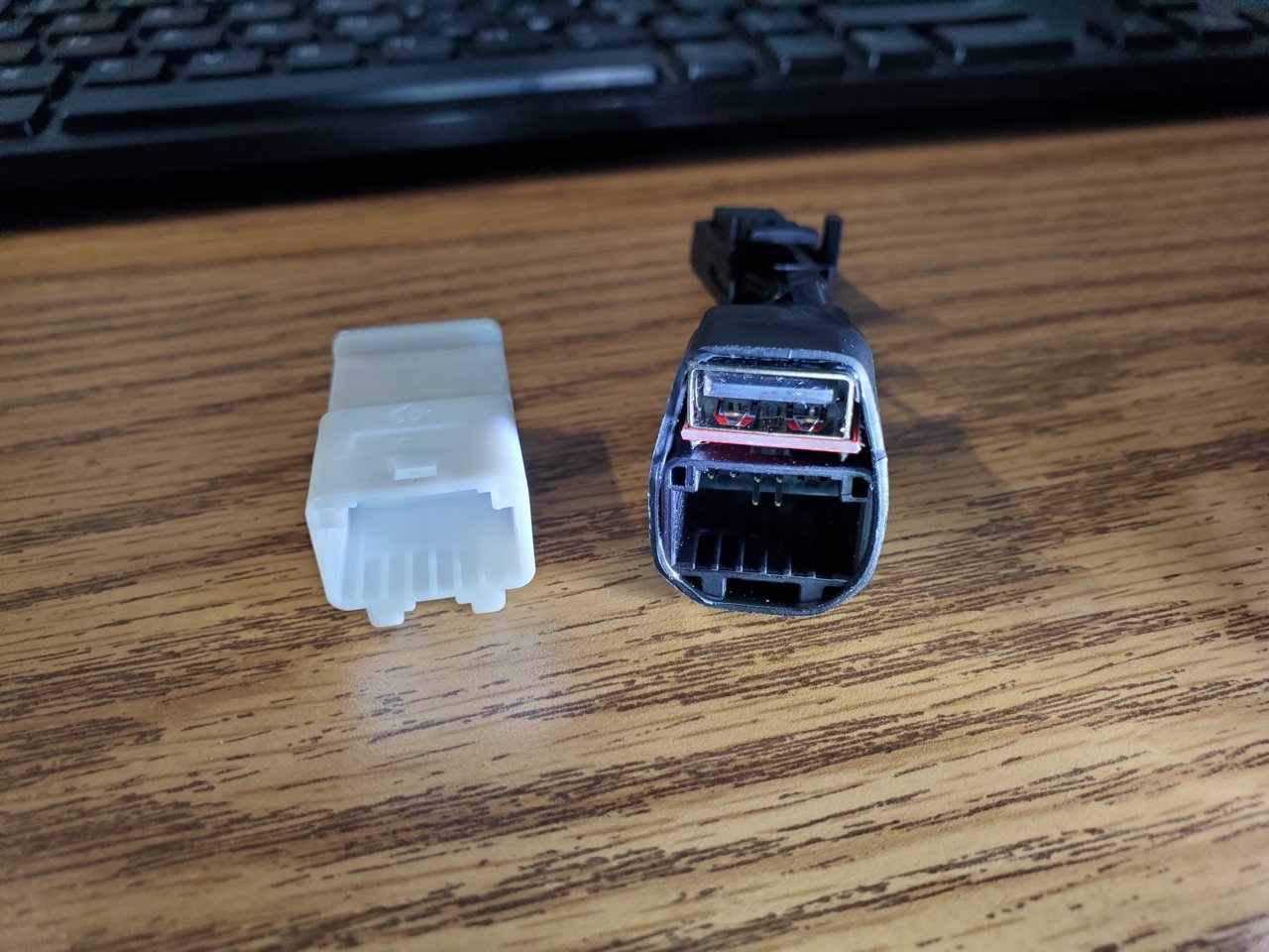

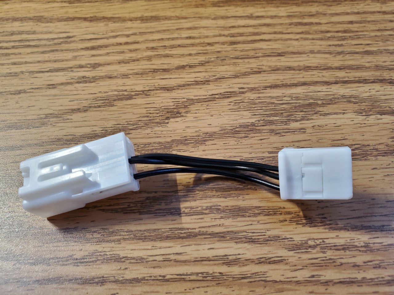

    @robnpatb posted this link to the USB board used in the SimpleUSB. The board in the link is not 100% identical (maybe it's the improved version???), but robnpatb has confirmed that it works. Anyone with an overheated adapter could easily order this board and repair their SimpleUSB.
    For anyone that may want to DIY the proper connectors are also available on Amazon, although with a substantial wait time, since they apparently ship from China. These connectors are considerably less expensive than the ones from Mouser that I linked in an earlier post. But the ones from Mouser are available for immediate shipping.
    This picture shows the pinouts on the 12-pin SimpleUSB device. I've since determined that terminals 4,5,9 (YEL,GRN,VIO in the picture) do not need to be wired through (at least not for a 2017 Limited).
    The connectors in the picture are the ones I got from Mouser. The ones from Amazon are likely identical. If you order connectors, don't forget that you'll also need to order the terminals.
    I haven't yet assembled a SimpleUSB clone. I had to order a crimping tool because the one I have wasn't going to handle these terminals. Being just retired, I no longer have access to all the tools we had at my office . . . :annoyed:

    Only three terminals on the mirror connector are identified here. Does anyone know why the other three pins (4,5,9) on the SimpleUSB adapter are carried through?
    Maybe pins 4,5,9 aren't required to be carried through for the Tacoma?
    Are there any other circuits that go to the Tacoma mirror that aren't shown on the diagram below? @caribe makaira
    EDIT: Confirmed that there are only 3 wires on the mirror connector on my 2017 Limited.
    So if no other years or trim levels require more, then only wiring through pins 3,6,10 should be sufficient for a "Tacoma" SimpleUSB clone.

    My new crimping tool came this afternoon. I can confirm that this 3-wire pin-to-pin jumper works with the rear view mirror in my 2017 Limited.
    The three additional pin-to-pin connections that the SimpleUSB carries through are not required, at least not for my Tacoma. That's a good thing,
    because these tiny connector pins are a real b-i-t-c-h to deal with. There was no way I was going to be able to get TWO wires crimped to a pin terminal
    in order to connect to the DC-DC converter board. Now that I have this much built and tested, I will splice and solder the wires from pins 3 and 6 to
    provide power to the converter board.

    It works just like the real deal. I can say that it's MUCH easier to just pay the $29 for the authentic device.. if/when the authentic device is available again.
    But this works if you want to go through the trouble to build it. I didn't have any super-size shrink tubing like the SimpleUSB uses, so I just used black tape and a couple of Ty-Raps.
    I left the circuit board partially uncovered to help promote cooling since there have been several reports of Simple adapter failure by overheating.

    I kept trying to get the hook up with the harness, but it is out of stock so I bought this:
    https://www.amazon.com/dp/B07R7JGCL1?ie=UTF8&psc=1
    Does anyone know the correct places to put the pins? I am having issues with putting it in the correct slots. When I connect them in the slots I think are correct (ground + slot that only powers with the truck on) it just turns on my truck. If I put it in the ground + slot that always has power, it keeps my dashcam on all the time and just kills my battery.
    There weren't really any instructions that came with it.

    It should be pin-3 (GND) and pin-6 (12VDC+). Pin-6 is only energized when the ignition is on, which is what you want. These pins are the Black and Red indications in the picture.
    The white connector at the right in the picture is identical to the male connector that plugs into your mirror. So you can use this picture to identify the required pins for your adapter.
    Pin-10 is also 12VDC+, but is continuously energized. Connecting to that pin will drain your battery since the SimpleUSB will always be "on". Refer to the diagram in post 229 above.

    @kayaws Please note that I edited my post after you quoted it. In the first sentence I mistakenly indicated that "pin-10" was the switched 12VDC+ terminal. I should have said PIN-6. I've revised my post.
