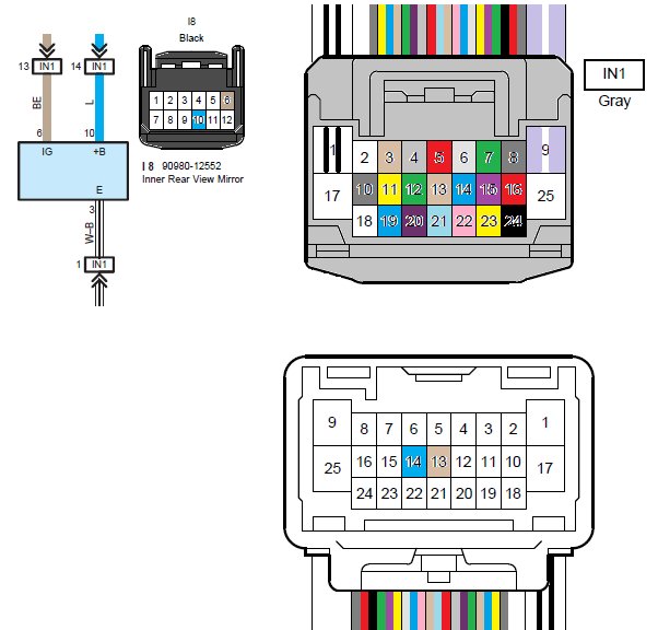

    Well @DES2009 u can add me to the V1 failure list. Idk if mine smoked a wire somewhere or I’m just missing the fuse. I checked both the under hood and drivers dash but couldn’t find a popped fuse.

    I had posted the relevant schematic here. You could check the two fuses shown in the lines going to the mirror if you haven't already done so. If that's not it then I dunno. Maybe @caribe makaira may have an idea...

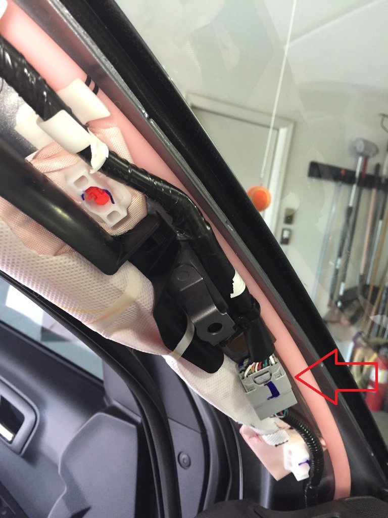

    DMM to the I8, then to IN1 (sail panel connector driver's side.) Maybe an added item is intervening with the flow.

    So,
    pin6 on I8 to pin13 on IN1
    Pin10 to pin14 for continuity?

    Tbh, idk where in1 is. I’m looking up connector diagrams right now haha.
    Edit, it’s literally in the sail panel lol. Idk where that circuit runs, but I’m almost positive that’s the only thing.

    So in1 comes from the A pillar then goes up towards the headliner then the mirror / console area up there?

    yes, but I8 is another branch to the roof area.
