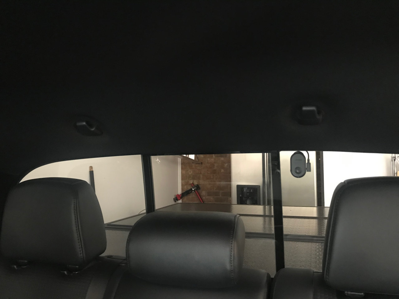

    I installed another Garmin Mini Dash for the rear. I routed the cable around the door and powered it via USB hub. The Garmin App itself syncs the video with the front camera so you can download a video within video if you'd like.

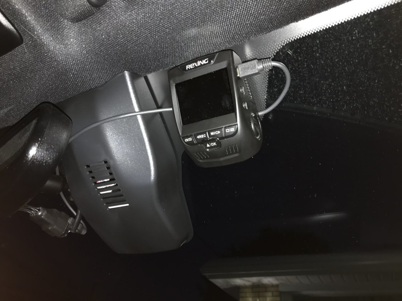

    Finished my dash cam install the other day using this adapter, and a Rexing V1-4K cam. (Starts right up in -30c temps, btw, which is deeecent) The adapter seems of trustworthy quality and runs the cam well. The USB portion of the adapter does not run too hot, especially if the cameras screen is off. I’m happy.2AD0360A-47CA-4BAC-BFD7-458256405C92.jpg

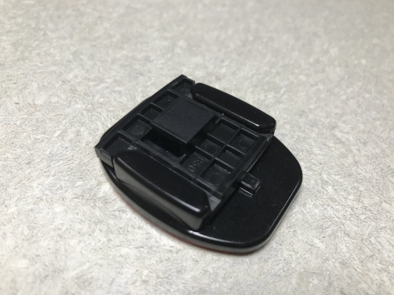

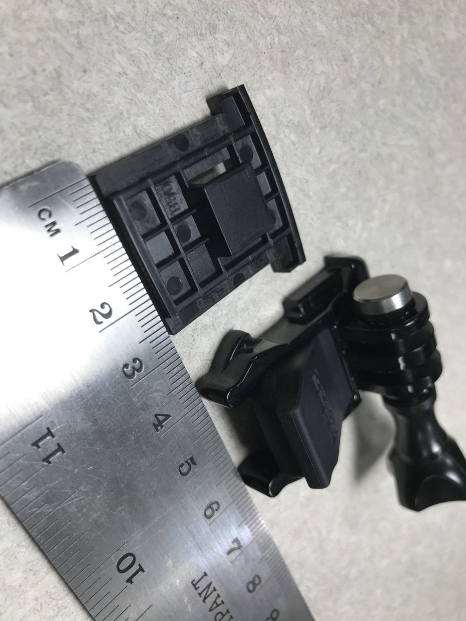

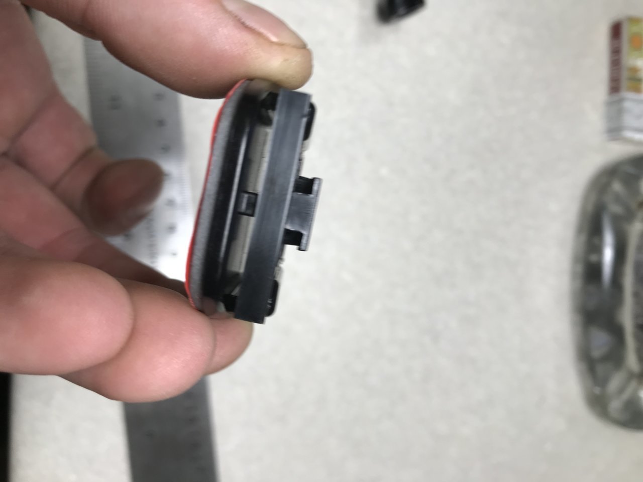

    Since the Rexing comes with a spare mount, I thought I’d attempt to modify one to fit the Tacos Gopro mount. Worked perfectly. All you need is a pair of small side cutters, and file. And Ideally some foam on the back for a tight fit. Pics are below, test fitting with spare Gopro mount parts I had. Now I just need to route the mini USB nicer. Those 9” right angle ones on Amazon are an inch too short, lol.
