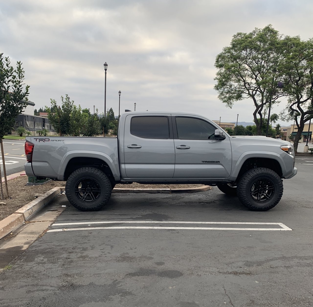

    Oh boy. Where to start....
    First: Here’s my truck ( see photo ).
    4 inch Maxtrac. Bilsteins.
    295/70/17 Nitto.
    Second: I’ve developed a Squeak... when I accelerate...or take turns.. or sometimes when I go over a small bump...
    I’ve stepped on the bed and made it rock ...no squeak.. stepped on the side of the door area... made it rock.. no squeak. Gone over speed bumps slowly ... no squeak.
    My shop says it’s my Leafs. They used some type of ... Lube ? Spray... WD-40 material. They checked my lift. Everything is nice and tight. However. I still squeak.
    My next stop. The dealership. The squeak is driving me insane. Has anyone else figured this out ?
    EDIT: Squeak coming from the rear of the truck.

    The dealer isn't going to do squat with a lift kit

    Can say for sure, but I watched a video the other day that showed them greasing the little plastic pads between the leaf springs. Worth a shot?

    Cut some pieces of bicycle tube into small strips. Lift the truck and then use a prybar to separate the leafs. USE PLIERS to put a small strip of the bicycle tire rubber where you can see that the leafs are making contact.
    Technique I used and have had zero squeaks in about 5 years.

    OP: And from which end of the truck is the squeak? You really have not told us. We will all be :notsure: without that simple little bit of direction.

    OP I would look at your front shock bushings, I developed a squeek similar to what your describing on my 2015 a year in and that was the culprit.

    Also check the bushings for the leaf hangers.

    Probably the body mount.

    That’s what I thought too, especially as the shop tried lubing the leaf springs and that didn’t help. But it could also be the front bushings too- OP has to do some directional sleuthing for us to know for sure.

    Don't have experience with 4'' lifts, but arent those usually DB, I could see that bolt on the cross member causing some squeaks.

    He has a spindle lift.... 2wd
