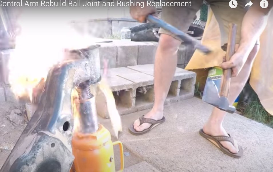

    I tried putting em back in the press to persuade them back into shape. Decide to cut my losses when one shot out and tried to kill me lol. Ordered a set of Duralasts for now just to get back on the road, will build a proper pair when I have time

    What video was it?
    I seen one where they heated the old with a torch and used a bottle jack.
    I think it was some young guy and his dad?
    Seems like they used a press to get the new in?
    I honestly can’t remember?

    Yeah it was a younger guy, maybe with his dad. He did use a torch, which I did too. Maybe not enough heat, maybe my arms were a little older and weaker, idk.
    Im sure the technique might work just fine for some, but it’s not a shortcut I ever wanna chance again to save time.

    FWIW to anyone else who stumbles across this thread and wants to swap LCA bushings, the bottle jack between the arms is a tried and true method.
    https://www.tacomaworld.com/threads...lacement-2005-tacoma-4x4-the-easy-way.437693/
    As OP learned though, the most important thing is patience and also recognizing that it may just not work if the bushings are too rusted in there. You've gotta use some judgment as to how much pressure on the bottle jack is too much. It didn't work for me either and I had to burn the bushings out and cut the sleeve out of the arm with a sawzall. 0/10 don't recommend, what a pain.

    FWIW2, I have replaced the bushings in many LCAs. I have a press and all manner of trick specialty tools I can use but the technique I prefer is the use of heat on the eyelets and a bottle jack because, for me at least, it takes the minimal amount of work and creates the least amount of damage. Just go slow and pay attention.
    Also for those who state they do not bother to orient the void spaces in the bushings relative to the LCAs, I have found that the life of the bushings is shortened (for the OEM bushings at least) if not oriented as prescribed in the FSM. The honeycombed areas like to crack and break through prematurely, particularly when off roading.

    This method does work if you're careful, like mentioned before. If the outer shells of the bushings are rusty AF and cooked to the LCA itself, sometimes its better to pop the bushings out minus the shells, then cut two slits in the shells, and remove that way.

    This method does work, but you have to follow the steps precisely without improvisation. You probably used a regular hammer, gotta use a small camp hatchet instead. You probably also had closed toed shoes on, and for this method to work properly you have to wear a pair of thongs, though some parts require you go go barefoot.

    Yeah, like I said, i'm sure this technique works for many people. I guess I was just in a hurry and not paying attention to how much pressure i was applying. I figured the rubber would let go before any damage was done, maybe I didn't apply enough heat as well.
