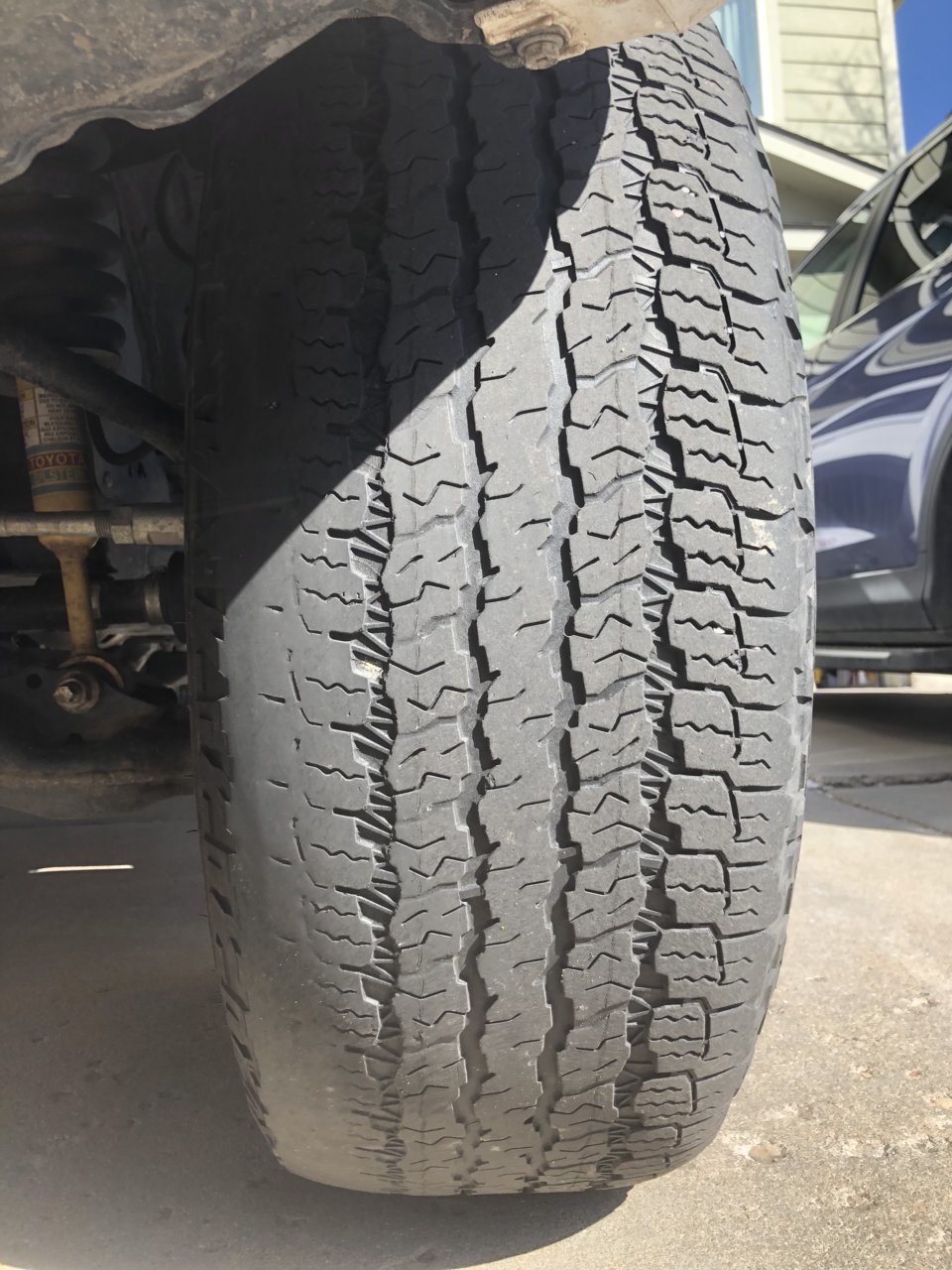

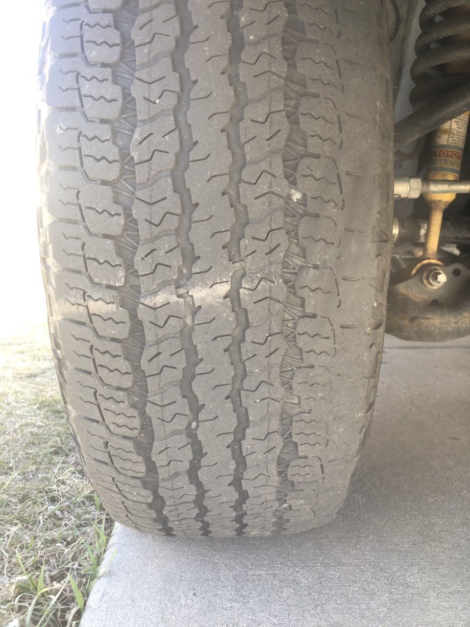

    I recently rotated my tires, and then when I got my oil changed at a firestone, they also checked my alignment. When I was rotating I dont remember seeing an significant wear, but I also wasnt looking for it. Does this look like an alignment issue? Ive never seen any of my cars wear their tread on just the inside.

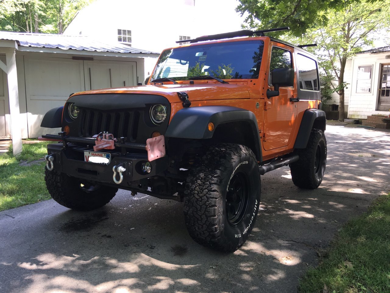

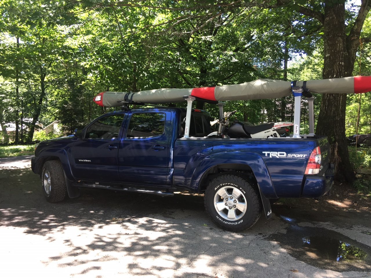

    Had one size over BFGs on my Taco (and Jeep, and Scout) and will be putting them on my Tundra this month. Love em. Wanted a good looking off-roady yet quiet tire, contrary to some complaining I've seen I've never had an issue with the KO2s in the rain or snow up here in the tundra. White letter out, of course *cue Falken argument* Paid $920 for the set of 4 on the Taco. Jeep was a bit more because they were 31"

    Yes that looks like wear caused by the alignment being off. I would have your alignment checked a little more frequently.

    If you want your new tires to wear properly and not end up in a similar situation, get an alignment. Looks like your tires are slightly under inflated and your camber is too far negative. I'd advise not going with KO2s. I have them and I can tell you that the additional weight of all those plys really trashes your gas mileage. They're a great tire, but the truck really has to work to keep them rolling.

    Classic alignment wear. Common on rear wheel drive because when pushed from behind the suspension opens up and you get a positive toe. When you get it aligned, you usually have a little negative toe to compensate for the push. Ideally when you are driving, you have zero toe. I'm guessing it has been a while since you had your alignment checked.
