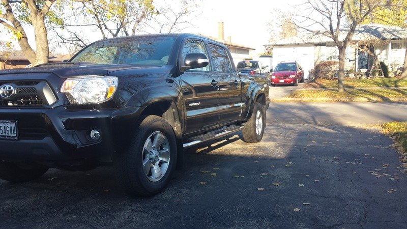

    I received them yesterday and installed them this morning in my driveway. It was about 40 F but it went well. The install is a breeze. Used Anti seize on all the bolts or it would have been done in 45 minutes Total time about 1 hour with prep time done before in the warmth of the house. I put all the bolts and washers together so I was not fumbling in the cold and sat them in a tupper ware container. I had all the tools ready and bought a 6 MM hex head socket for the hex bolts. They supply an allen wrench but the socket and ratchet are way quicker. I can't figure how they expect you to torque the hex bolts with an allan key. The instructions are pretty good but I have watched videos on You tube. They don't sit as high as I might like but it would make no sense if they were higher. The brackets are all clearly marked and in separate coloured bags to designate which side. And the steps are in a clear bubble wrap and red bubble wrap so you know which side they go on. There was one flat washer missing and one extra lock washer. I torqued the bolts to 25 lbs as per instructions and they are pretty sturdy. So far I am pleased with the look and using Partsengine.ca was very good. They are on top of their game. I called after less than 2.5 work days and they were shipping that afternoon. They gave me a tracking number and they were delivered the next day by Fedex. I am in the Niagara region so not too far from Richmond Hill where their warehouse is.
    The steps have some minor marks and a couple of little dings but over all they are look excellent. With the beating they will take, it will be a while before I can report on how durable they are.
    Oh and I know I will get asked. From the ground to the top of the tread 15.5 inches. From the tread to the bottom of the door sill 4.5 inches.
    That is with TRD package and 265/65/17 stock rims and tires.
    I will put some pictures up later.

    Sorry can't get the pics to work.20151125_105820_zpsvz3acp6e_4e7c94ae4271d730520bbea5bbffc32ff84f8401.jpg

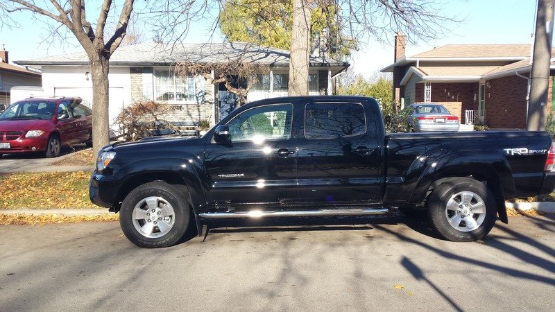

    I had the mods fix the pictures. I guess I was doing it wrong. It is hard to get used to the steps, especially getting out. Getting in you step up and then down into the seat. Getting out you turn put one foot on the step and step down. It will be good for my wife and Grand children.
    Not too sure about Black Friday and the delivery was free. The box is 90 inches long. 7.5 feet.
    Another picture.
