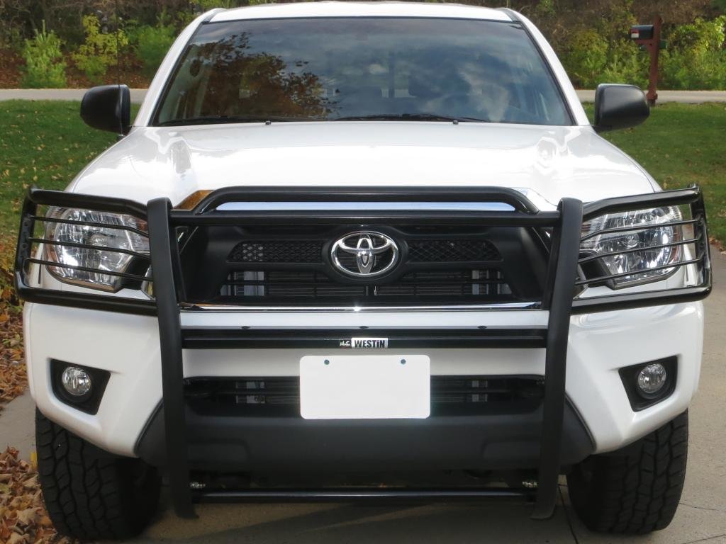

    I recently installed a Westin Sportsman brush guard (part 40-1605). It's main purpose is to reduce the chances of radiator damage after a deer hit. We recently had an $11,000 deer hit on our other truck, and the damaged radiator stranded us far from home. I do not care if the guard might spread the body damage from a small hit, and I like that the factory crumple zones will still absorb a truly huge collision as this guard will bend back and fail.
    It is rock solid and does NOT vibrate when driving. I am very pleased with my choice. The black finish looks good, and I like how the back of the vertical sections are contoured to match the lines of the truck.

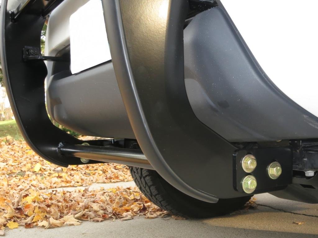

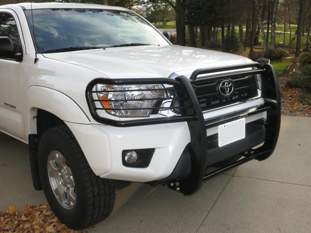

    The brackets are very thick: the bottom brackets are 1/4" thick and the top brackets are 3/8" thick. The most visible bolts and nuts which attach the front end of the top brackets to the guard are entirely black, to match the black finish. These contours, brackets and bolts are shown in the 3rd picture below.
    The instructions list the required tools, and are incomplete. In addition to the wrench and socket sizes mentioned, I also needed 17mm and 19mm sockets to fit the included nuts.
    Many of the holes in the mounting brackets are actually ovals to allow position adjustment. This gives a lot of flexibility in guard location, including how far it is from the bumper. I wanted the guard to be fairly close to the bumper, yet not touching.
    To accomplish this I loosely bolted the guard to its brackets, then sandwiched two small wood blocks between the backs of the vertical guard sections and the top of the bumper front edge. These wood blocks were temporary spacers which could be pushed against the painted bumper without damaging anything. I had my son press the guard against these blocks as I tightened the bolts and torqued them. After removing the blocks I had about a half-inch of space between the back of the guard and the front of the bumper.
    I took a few pictures of my installation.

    Question: how much space do you have from the front edge of the hood to the top bar that runs horizontal to the hood? I have the OEM bug guard on the hood, wondering if it's going to hit the top bar of the guard?

    Unchained_5150: 5 years warranty against manufacturer defects in several things including the word "finish", excluding damage caused by gravel, etc. Seems reasonable. I plan to touch it up as needed. Since taking the pics, I have painted the 3 big bolts visible in the 3rd picture where the guard attaches to its brackets. I used spray primer then flat black in that bolt area - took lots of masking tape and newspaper. Mainly done for cosmetics, those zinc-colored bolt heads were ugly in the middle of all that black metal.
    ArmyRetired: The smallest gap is just over 2" from the closest (lower) edge of my chrome upper grill piece to the lower of the 2 horizontal top bars of the guard. You could make this larger via the adjustment range in the initial installation - just have the entire guard be more vertical and less leaned-back towards the grill (see my section on the wood blocks).

    Can you remove the headlight guards? I really like the look of the push bumper but don't like the coverage extending to the headlights. Looks great though!

    Yes and no.
    Yes: the thin headlight guard bars inside of the thicker outer bars are removable, though I have not done that. These 3 thin bars are one assembly (per side) which attaches to the thick outer bars with black bolts with allen heads, separated from the thick outer bars with small black spongy "gaskets".
    No: the main thick bars protecting the headlights are welded on.

    I have one like yours but in stainless steel . It is my opinion that unless you upgrade those two flimsy upper brackets to withstand the force of the impact of hitting a deer, I highly doubt it would get you back home. Hitting a turkey, you'll be ok. Hitting a deer, that damn thing will crumple like noodles.
