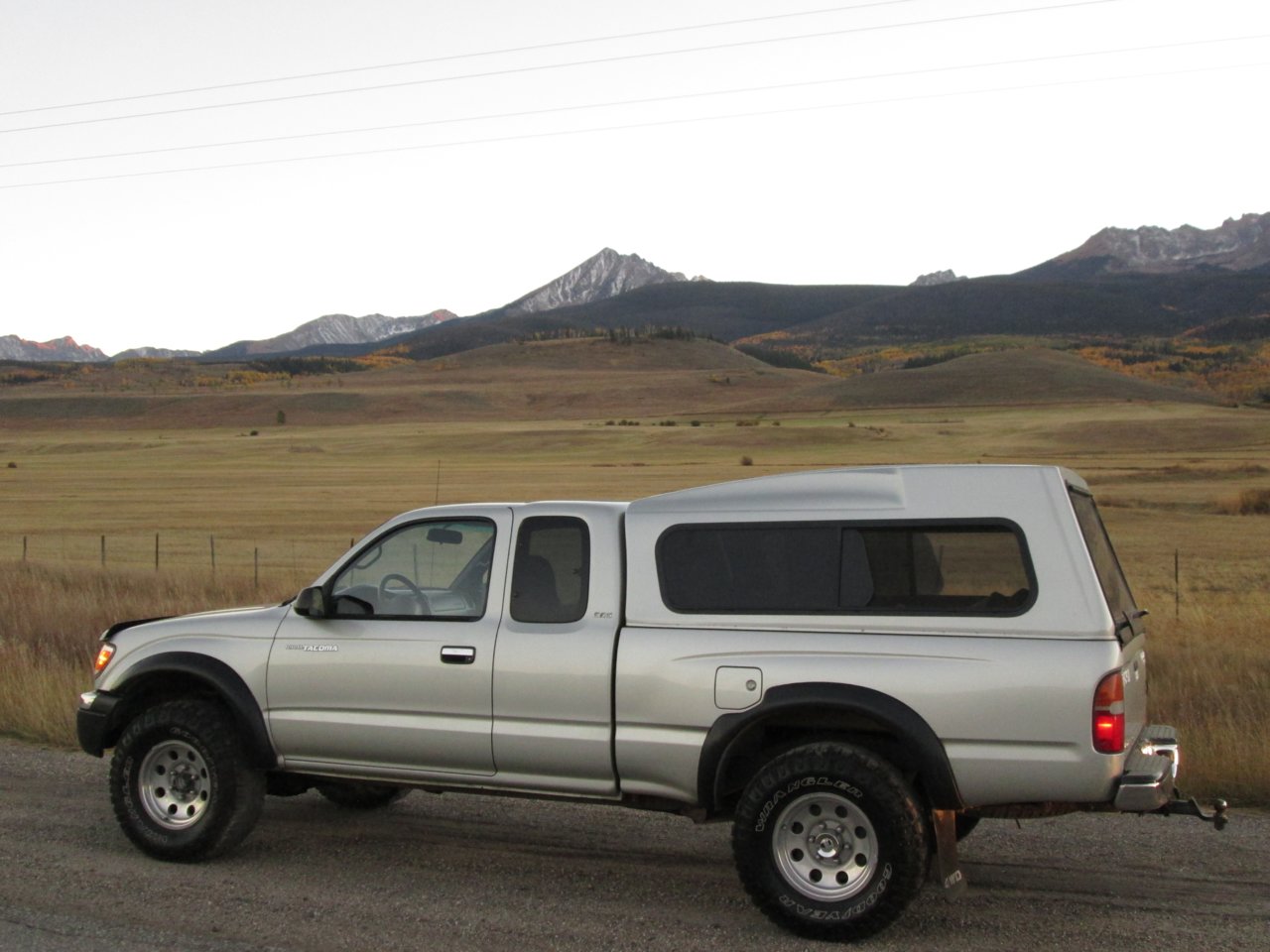

    31x10.5x15" on my 00 Tacoma. 2000 was the last year for 15's, 01's came with 16". I had a little rub at full turn, heat gun and a couple whacks from a small sledge hammer, no more rub. Bought it new in September 2000. 4 wheeling took the front mud flaps off 15+ years ago.upload_2020-7-5_23-45-24.jpg
