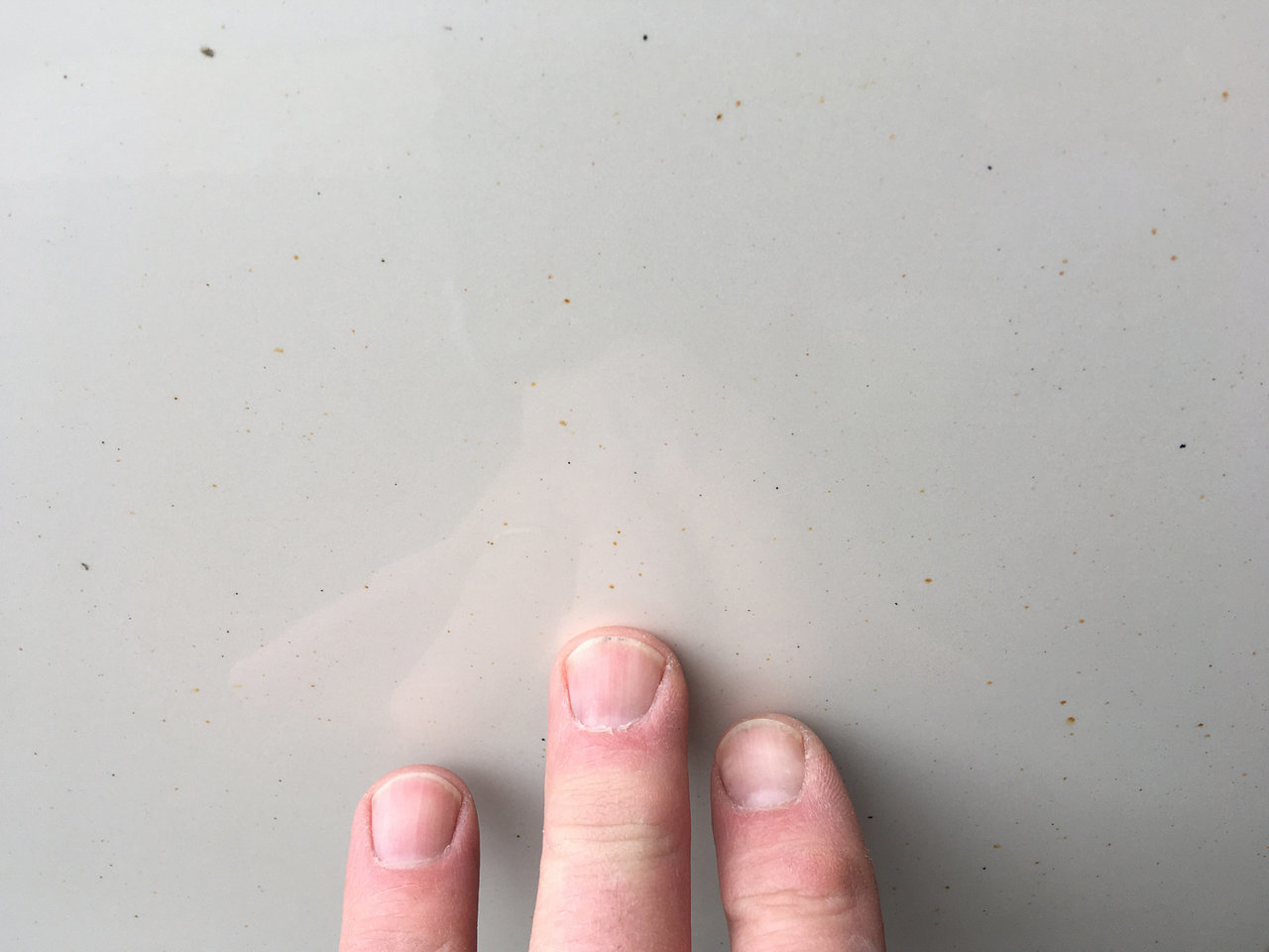

    I just happen to have some pretty decent pics from several recent details that show surface contamination. Here's one from a pearl white Mercedes S550 that had a terrible case of iron contamination. Note what looks like little rust spots.

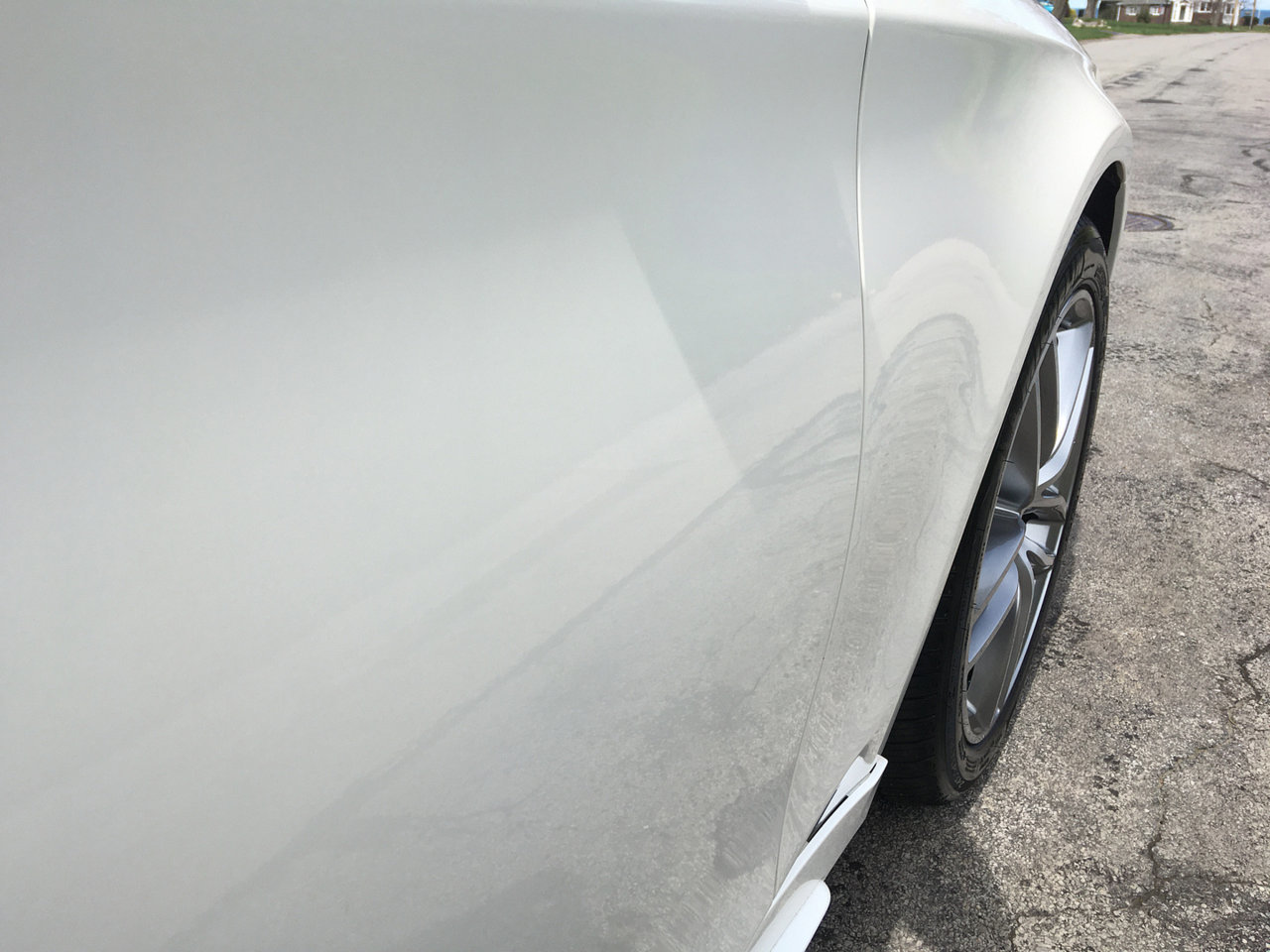

    Although you could definitely feel these spots, the white paint made them very visible. Most any darker color would pretty well hide them. That's where the plastic bag test comes in. I removed the contamination on this particular car with a Nanoskin Mitt and detail spray as a lubricant. As others have said though, by removing the contamination, you do induce some surface marring that needs to then be polished out. Said another way, the situation gets worse before it gets better. So how did it look after (2 stage) polishing and a coat of Jescar Power Lock?

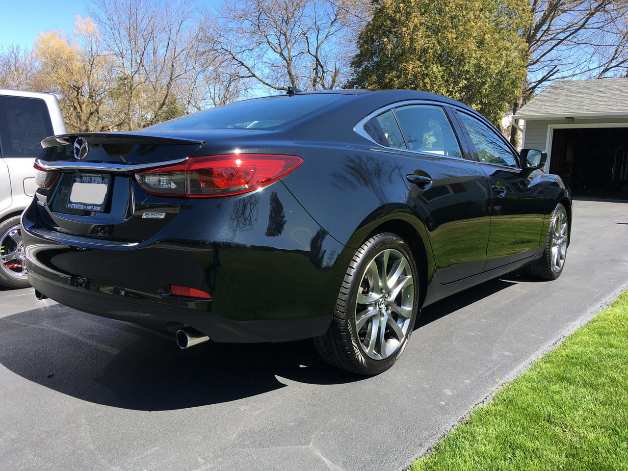

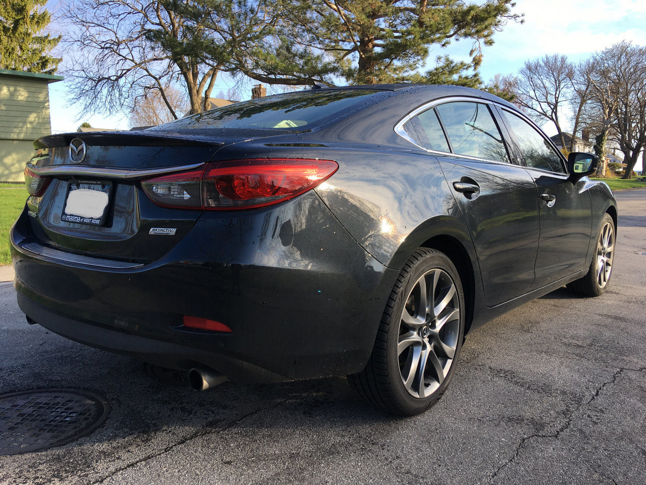

    Given that any type of white paint tends to hide surface marring, I just happened to do a Mazda 6 the other day that supposedly had metallic black paint, but due to a serious case of marring, looked flat grey. Here's what it looked like before washing, decontamination, 2 stage polishing, then the same Power Lock.
    Here's the same car 6 hours later after the marring was removed. The owner didn't recognize it.
    See how removing surface marring improves the way the paint looks and reflects light?

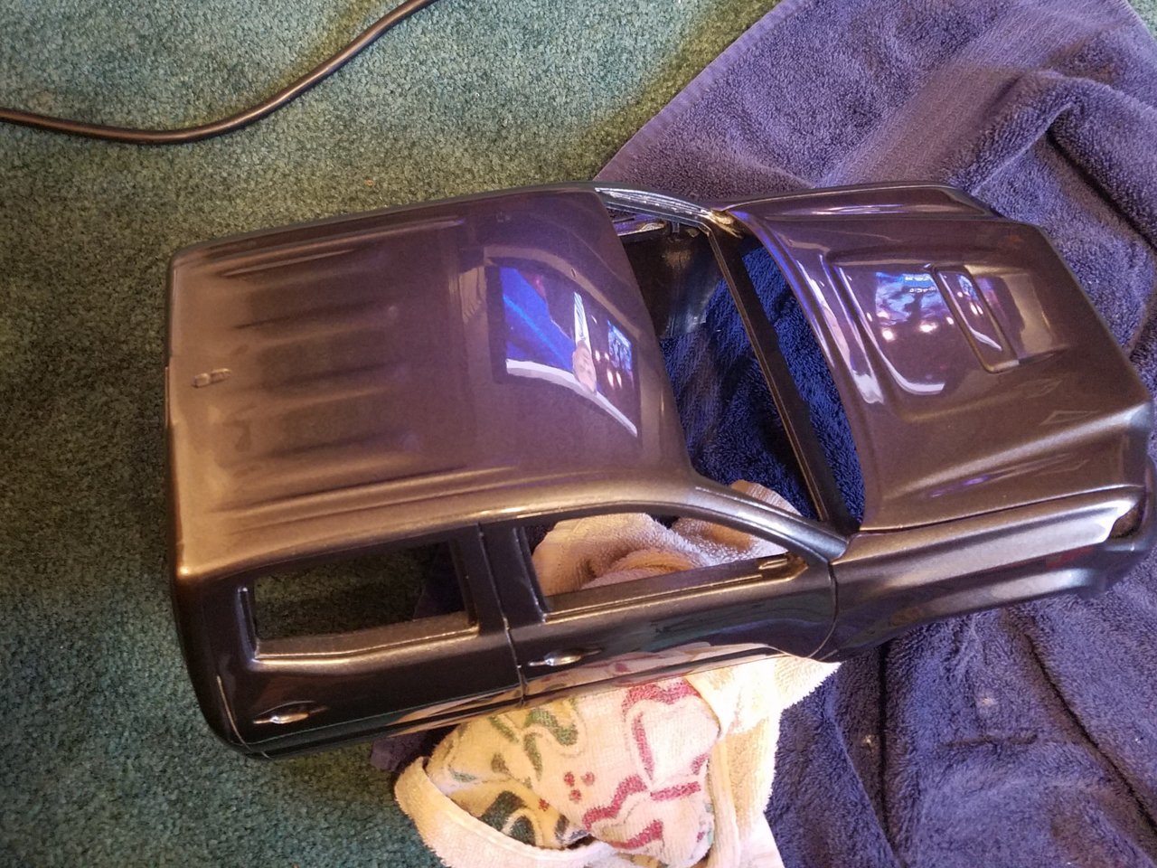

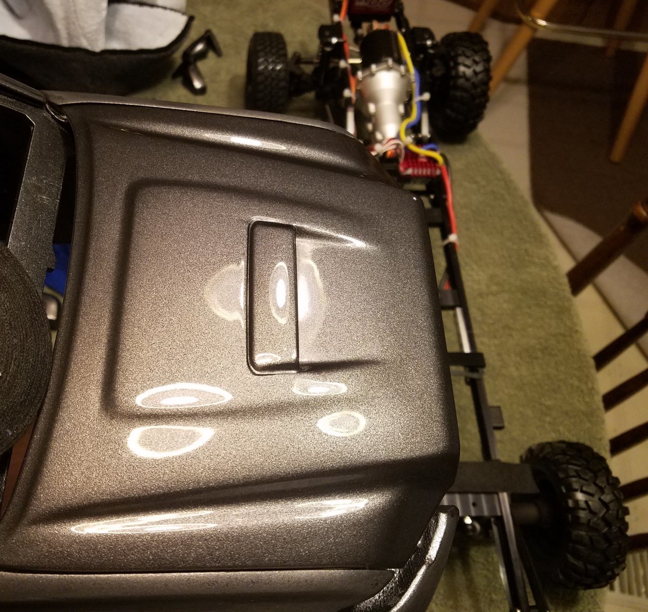

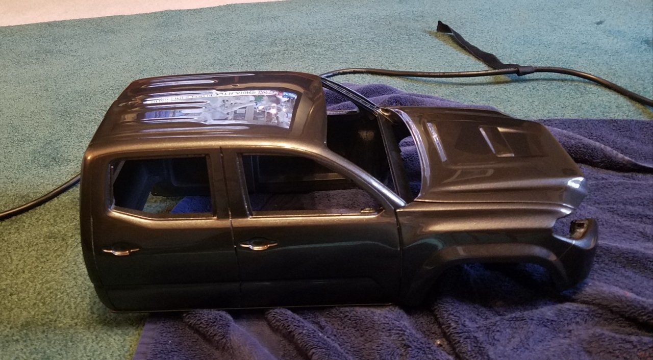

    Here's one I just did but its fresh automotive paint. Just wanted to remove the orange peel. Just glad it was not much surface area. :rofl: wish my real vehicles looked this good.

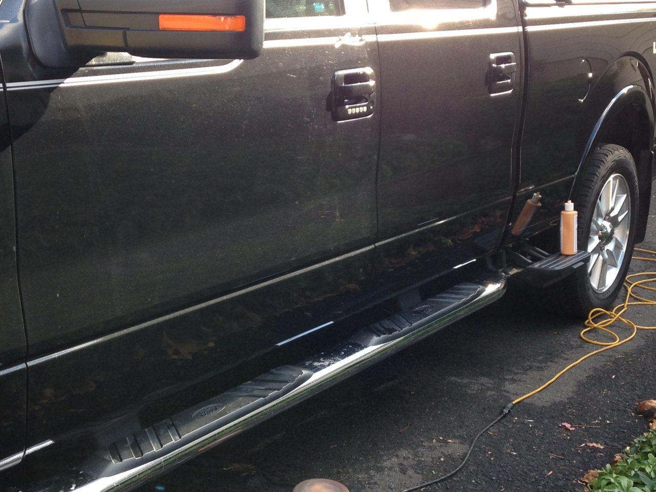

    Yep! I have about a gazillion photos too, from when I owned a detailing biz (and online store). Here's another example of what polishing can do to improve appearance. Rear door and back is done, front isn't.
    Almost looks like the front half was never even washed, but in reality, it's just how the light reflects off the paint.
