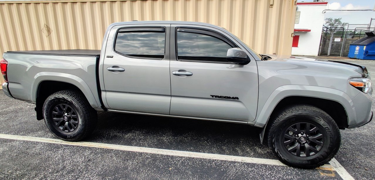

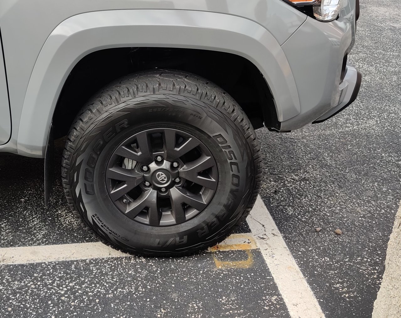

    Here you go. These are the Walmart/pep boys version the tread May be a little bit different than the AT3 but should be the same size. I have black side out. IMG_20210610_092834.jpg
