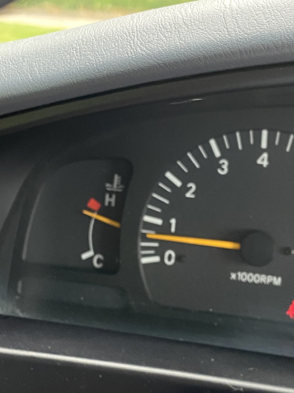

    Replaced my coolant thermostat. Replaced coolant with regular green coolant. Drove it and burped it. Put more coolant in to “F” line on tank. Today the temp gauge got super high (see pics) and the coolant was literal boiling hot (see video)
    What’s wrong?
