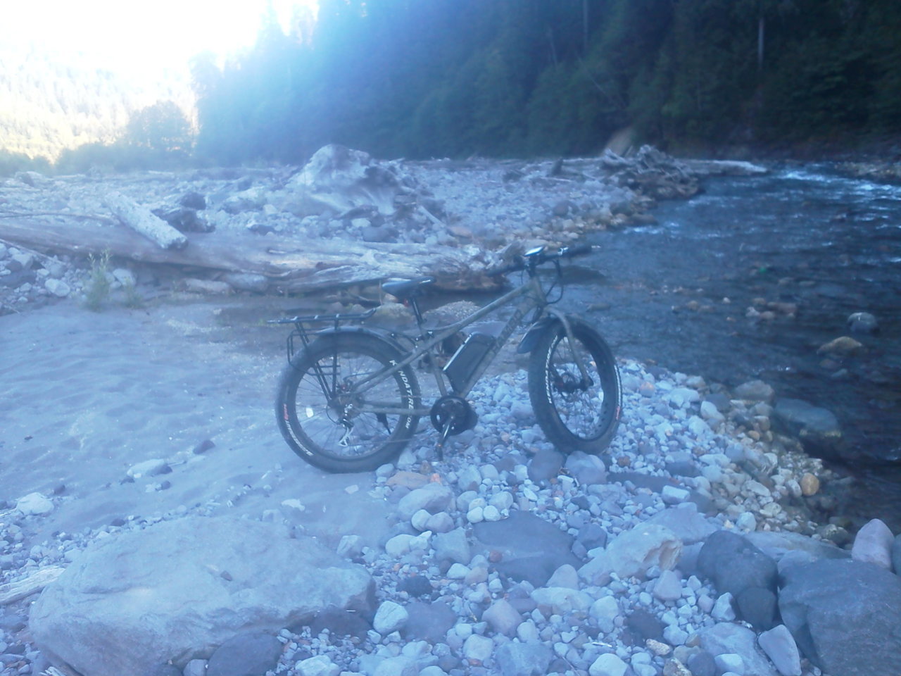

    Make sure you spend the extra money and get a bike with a mid drive unit. I have a fat tire bike (4.5 wide) with a 750 watt mid drive unit. On low power settings I can climb up some of the steepest trails.
    My old hub drive units sucked unless I was on flat ground.

    I have a Bosch unit. I only got 150 miles on my first motor. But I beat the snot out of it, motor got hit a few to many times on big rocks, and logs. Was lucky and the place I bought it from sent me a new unit. I wouldn't of covered replacing it but they did. Since then, I have not had any issues, yet I've slowed down now I know the limitations.
    Mid drive is down near the pedals, lots of tq.
    Hub is in the hub of the wheel.
    My mid drive gets way better range than any of my hub motors that I had. My hub motors would only get me around 15-18 miles with me doing most the work. My mid drive on low power mode will get me close to 40 miles up in the hills. Wish I lived closer to work, id have a sweet e-bike for commuting to work.
