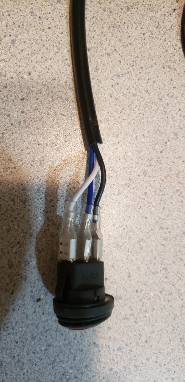

    Trying to install a light bar.

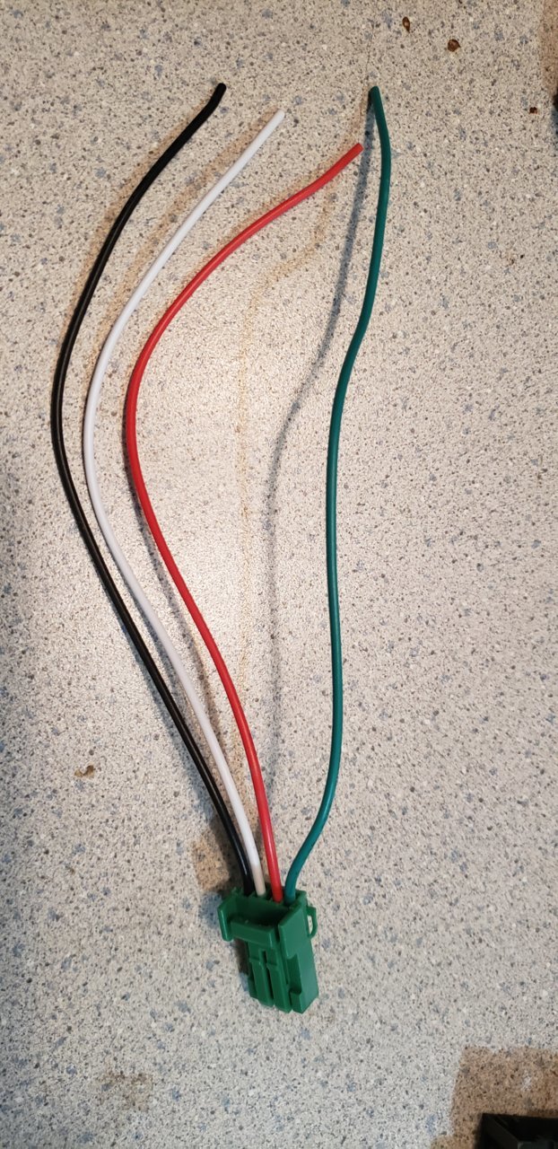

    My switch has black blue and a white. My new switch oem style has a black white red and green. What connects to what??

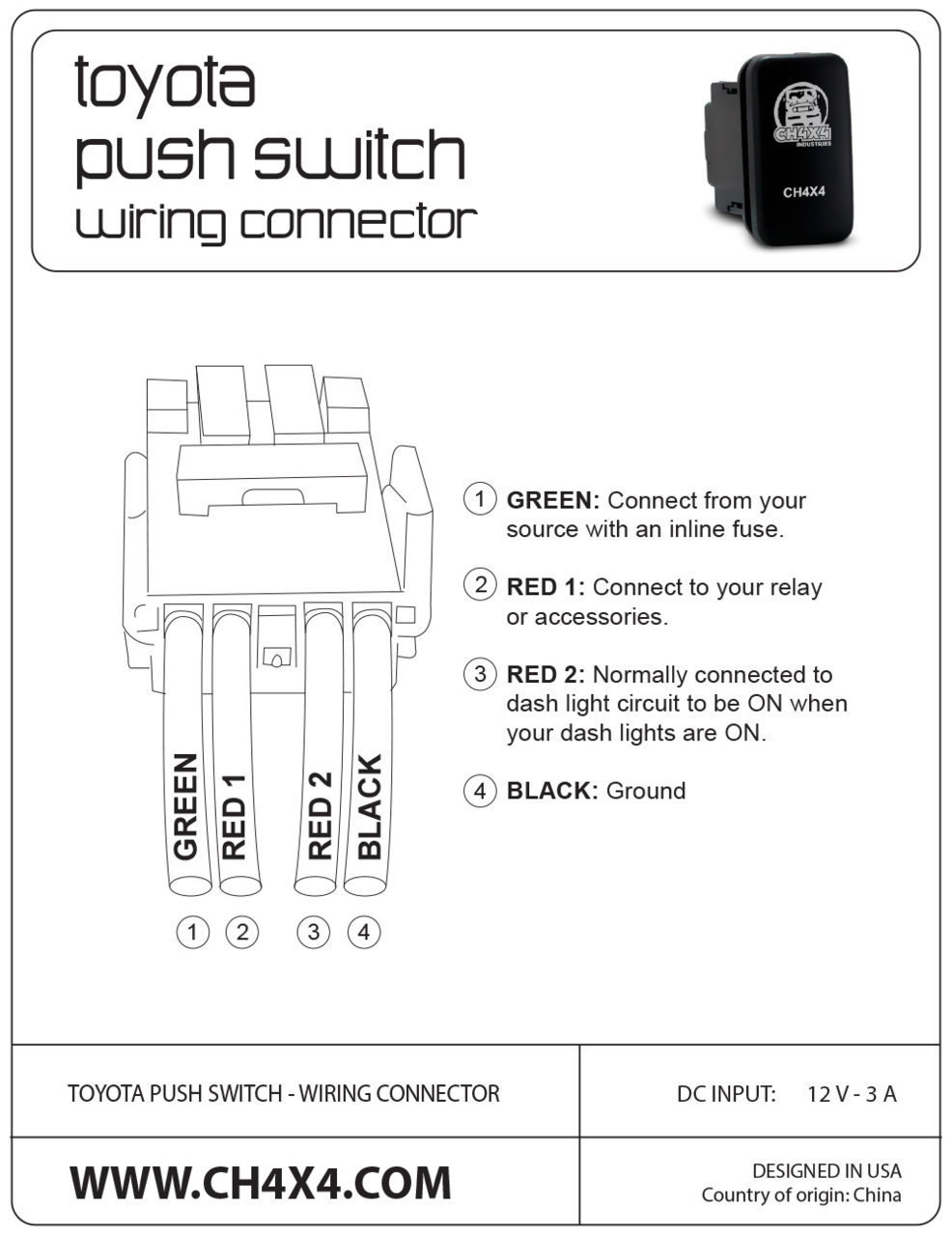

    What kind of light bar?
    Is the above the type of switch you have? I see it doesn’t have a white

    Your white wire is likely red 2 in the above diagram.
