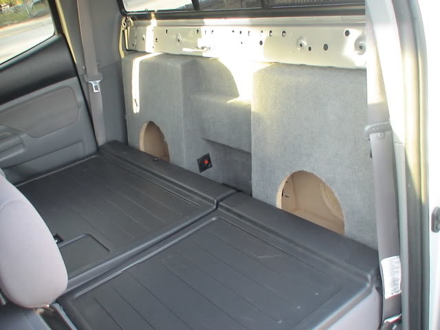

    i just got 2x jlw3v3 10 inch 4 ohm subs with this box
    http://www.supercrewsound.com/shop/detail/11/189.htm
    i know the mounting depth on the jls is 5.8 something and the box is 5.5 standard but i talked to them and they can increase the mounting depth by a little and it still fits nicely in the back when the seats are up

    I just ordered that box and got some IDQv3s that I'll be dropping in, and yes mine should fit, not to sure on yours you have to consider the magnet width and depth..that box might slim down fast and make the speaker stick out a couple inches.. good luck I had a tight fit on my last truck that made me panic, but then I just lifted the seat 1.5 inches and the went under. Good luck, but behind the seat you either fit or you hit...then you would have to move the seat forward..major PIA. I can advise on the IDQs later this week.

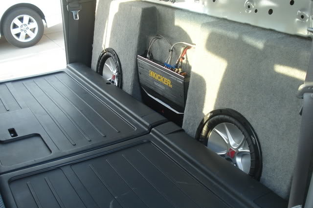

    I just got that box installed and you should have ordered the extra mounting depth for those speakers. I have 2 kicker cvr subs with a kenwood 1000w amp and it hits harder than my friends 3 10" JLw3v2's. I have seriously lost some hearing within the first week of using this setup even with the bass at -8 and the subwoofer level at 0 and the amp not bridged, these subs are too dam loud! and i'm no old man. Just get a decent amp and you won't wan't to push those speakers to their limit.

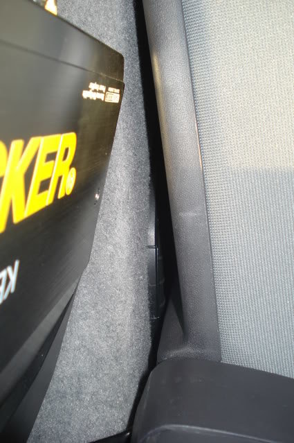

    Sure looks to me like the subs are smacking the back of the seats to me considering the pics you show. Lets see how long they last with that "extended box"

    supercrew enclosures are pretty good, the one thing i didnt like was the screws for the terminal cups extended at least an inch into the space. I replaced them with the right screw. In those pics i see a kicker amp not a 1000watt kenwood???

    It's a kenwood amp with a kicker sticker on it Kenwood is mounted upside down

    the subs aren't actually hitting the back of the seat, there is no rattle either. the extra mounting depth is for the top mount depth of te speaker, which increases to 5.9" mounting depth. I added Dynamat behind the box which also took up some space. The speakers should last a long time, and even if they don't, I'll just get some new ones.

    well i ended up getting the alpine m1000 watt amp for these subs. centurion those subs fit perfect with this box if you get the extra mounting amp and they hit hard. it looks like the subs would hit the seat but thye dont once you put the seat up there is plenty of room back there for the subs to hit. supercrew sound made a very legit box for the double cab tacomas and sounds nice :p
