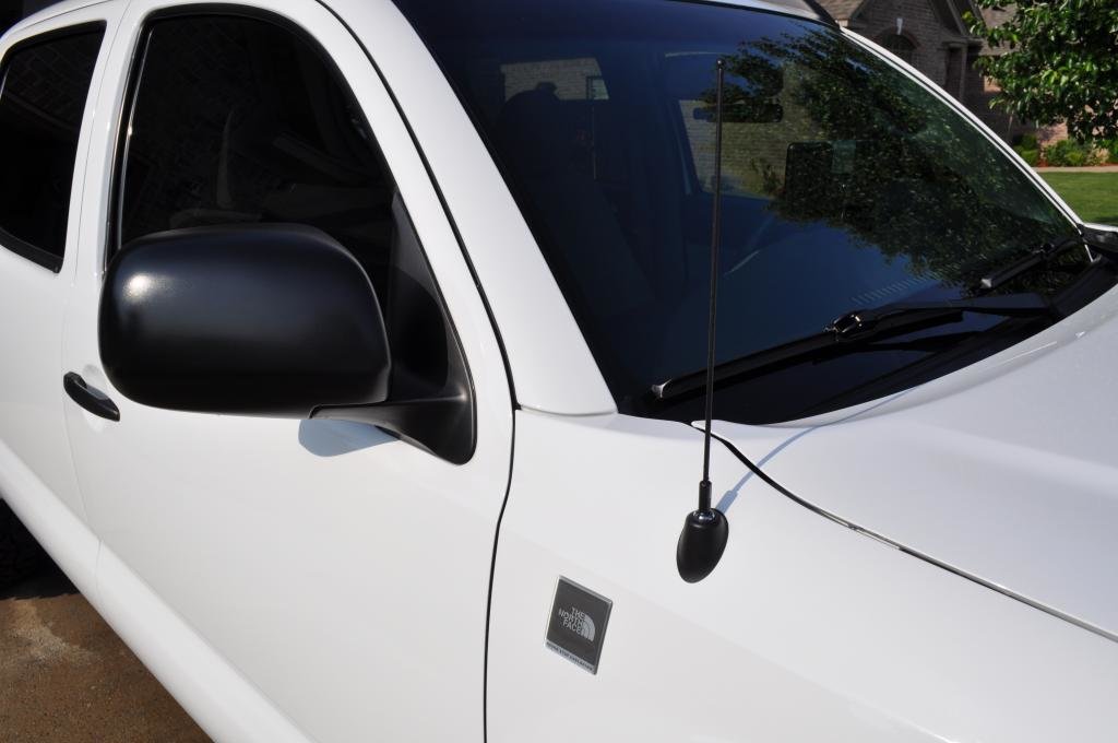

    Stock, but I chopped about 6 inches of the top, pulled the ball tip off and put in on the remaining antenna length.

    Yeah... Just curious why you guys don't do this.
    12" with the ball replaced. Like I said, around town I didn't notice any difference but I don't listen to FM that often so I don't know the distance outside of the city. I listen to XM, Pandora, or my mp3's on my phone mostly.

    Same thing I did just didn't go as short as you. Mine is about 14.5". Cheap quick and easy.

    Yeah... I don't get it? Spend $20-$25 on one or cut yours for free? I've got plenty of matte black paint and epoxy laying around. I took the wire off the outside so it is smooth and since it is short there is no wind noise (not that I could hear wind over my tires anyway lol).

    I'm in the cut stock club. Just a tad above the roofline so it can still serve as a low ceiling warning, but doesn't rub in the garage at work. Ball just pulls off, doesn't need to be cut off. Cut the mast with a hack saw, replace ball (with a drop of super glue for good measure), scuff and spray paint (optional, since the ball covers the cut end). Less than fifteen minutes and free - can't beat that.
