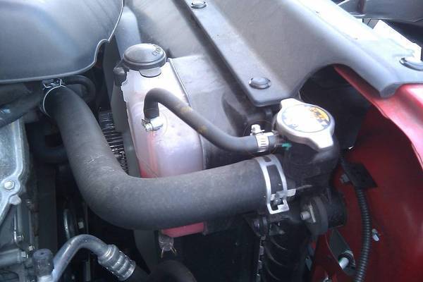

    I was losing some coolant around the hose connecting the radiator to the overflow reservoir. I picked up two small hose clamps and snugged them down at both ends...no more loss of coolant.

    I had a slow leak from the weep hole at 19000 miles. I couldnt see it until i crawled under the truck with the skid plate off and saw a thin pink crust trail coming from the hole just under the water pump shaft. The leak was so slow that it was evaporating halfway down the engine block. Might be worth checking out next time youre under the truck.
