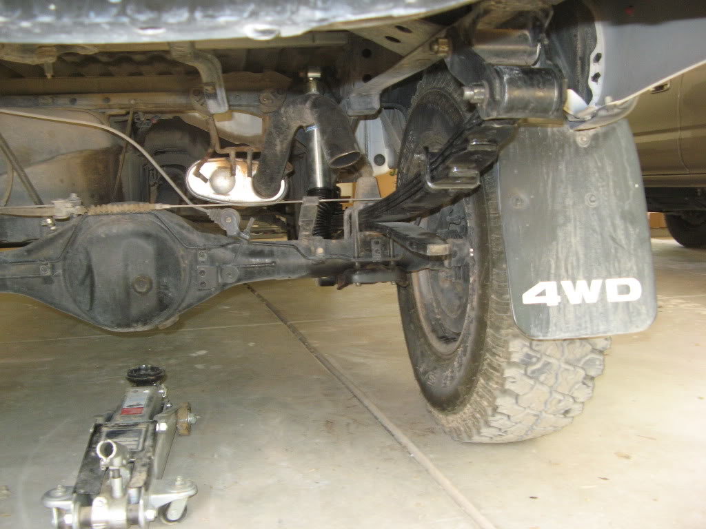

    Post up some pics so we can see how bad yours are. If they're really bad an AAL won't do much and new leafs would be the answer. There is a group buy on the wheelers 5 leaf pack, link in my sig.

    here's what they should look like: these are the wheelers 5 leaf pack just after install.
