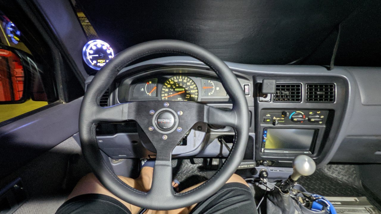

    My old first gen, I bolted an aftermarket tach into the plastic of the steering wheel column and hooked up a few wires to something under the glove box. It was really easy but it’s been 8 years, don’t remember too much. Something like this but smaller and it was blocking the temperature gauge

    Desmond Regamaster MP
