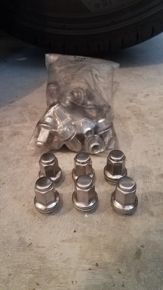

    Dont know if you are changing out wheels, but if so you can't use oem lugs with aftermarket wheels. You need acorn style lugs like these 20170612_192900.jpg
    Stock oem lugs have a seat or washer that wont fit aftermarket wheels

    Toyota sema wheels = stock type lugs
    FN or aftermarket sema replicas = cone seat lug nuts
