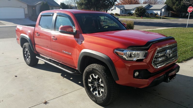

    ZipTy Member
    Jan 30, 2016
    #176569
    19
    Oregon
    2016 Tacoma TRD Sport AC

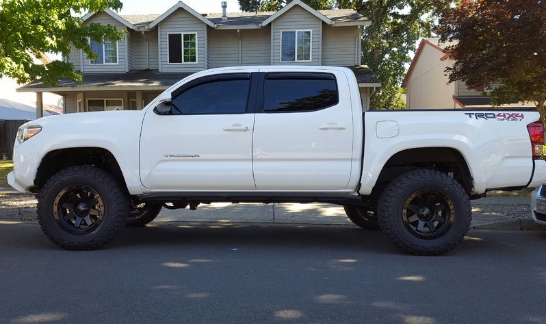

    I went with the N-Fab RKR-Sliders w/ detachable steps. Mostly because my youngest daughter needed steps to get in and out of the truck, but I didn't want to drag them if I decide to off-road. They don't stick out as far as I thought they would, but they work for my purposes.

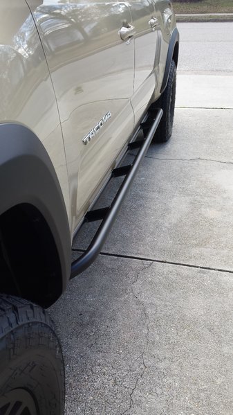

    Picked up my BAMF sliders (black powder coat) for my TRD OR. Should have them on by Thursday and will post pics up.

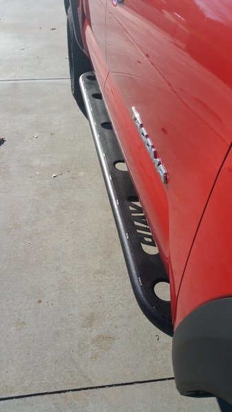

    RCI here

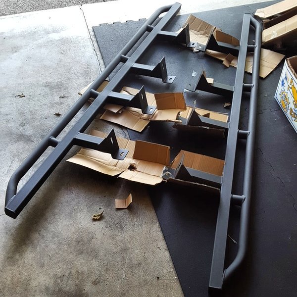

    Mostly stuff I built.
    Are you guys doing anything to prevent rust between the sliders and the frame? I hit the beach quite a bit during the spring and summer don't want to trap contaminants and moisture between them.
    Undercoating, fluid film, waxall??
    Building my own sliders btw here are the back halves of the frame plates I designed. Plates are 3/16" laser cut and cnc bent The circled slotted holes will have 10.9 14mm x 1.5 bolts with 2"x3" 3/16" plates with weld nuts in the inside the frame. The flange on the bottom extends past the frame 2" so that it can be used for the mounting flange for my transfer case, belly and fuel tank skids have planned.
    -40, monteredondo and Diablo169 like this.

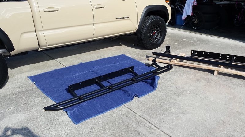

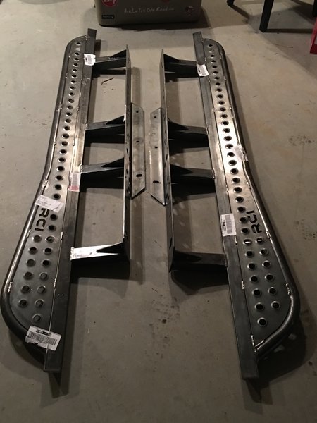

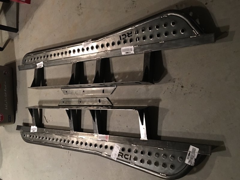

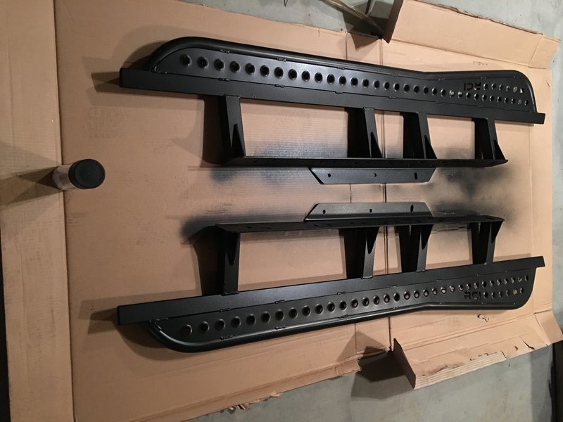

    Step 1: receive sliders
    Step 2: take trip to lowes/Home Depot
    Step 3: Buy Rustoleum Truck Bed Coating, #3 steel wool, Dawn soap & brush. If your sliders have stickers on them from shipping buy Goof Off and a paint scraper.
    Step 4: Use Goof Off & scraper to get stickers off
    Step 5: Wash thoroughly with Dawn and brush.
    Step 6: Let dry thoroughly
    Step 7: go over with steel wool. Make sure all residue from steel wool is gone.
    Step 8, 9, 10: apply a coat of Rustoleum, let it dry, repeat several times.
    Step 11: install sliders
    Step 12: enjoy your bad ass sliders.
    I didn't take pics of the actual process but here's before & after. They'll be installed tomorrow.
