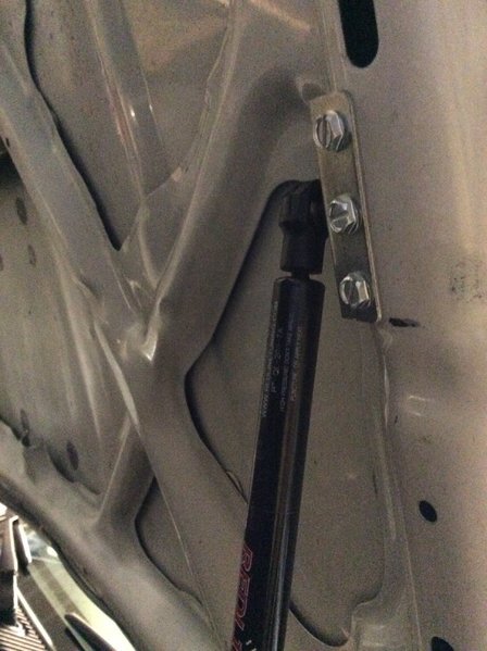

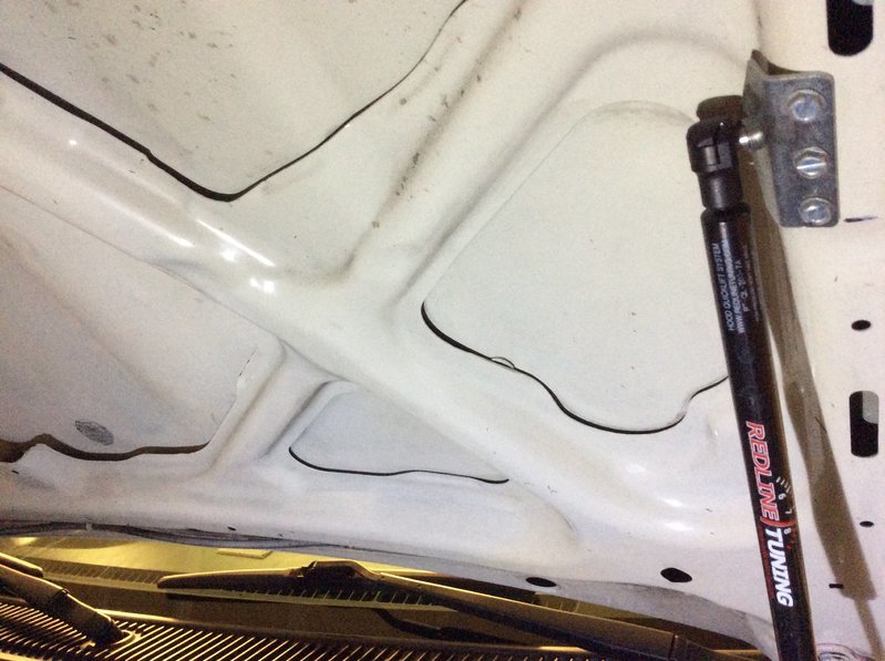

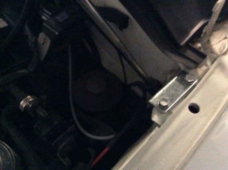

    So, third riveting gun and the Redline Hood lift kit is installed. I'm so darn happy.
    But before I show it, here is the story of the first riveting gun that cost about 3 dollars in local "Walmart type" store. I thought, for just 6 rivets to pull, I don't need a fancy tool. Man, I was so wrong.
    After the first rivet the gun locked up and did not want to grab the "nail". I disassembled it, check all guts, and put together. It started grabbing again. It pulled the second rivet no problem. The third one was a bit of struggle as after each pull the gun did not want to release the nail that easy. But somehow I worked my way through third and fourth. When I started to pull the fifth rivet, the gun did not want to break the nail. It started to crumple instead. Up to the point that there was no useful "pump" movement anymore. Here is the picture of mangled 3-dollars gun.
    As you can see the "pump" went into the handle and there was "no pump action" anymore.
    I left the truck with the nail sticking out under the hood and drove to hardware store to buy some better riveter. In "Home Depot like" store I got 15 dollars heavy duty riveting gun MacAllister brand. When I used it to pull this stubborn rivet the nail broke in the place where the jaws grabbed it. It could be because the nail was not "notched" at the head correctly or maybe it was to much mangled by the previous gun. Anyway I took my dremel and cut of the nail flush with the rivet (the upper rivet on this picture)
    Good, only one left. The last rivet started OK, but just before it supposed to break, the handle of riveter snapped. That was it. MacAllister is no more. Out of 5 years warranty it lasted just 2 minutes.
    It was late and I had to goo to work so next day I drove back to store, returned broken gun and there I found a little more robust looking riveter "Rapid" brand. It supposed to be top shelf quality of hobby type and cost me 25 bucks. If this one brakes, they have a heavy duty model of it for 45 dollars.
    I drove back home and put this new gun against the last rivet. I squeezed it hard with quite force and suddenly something snapped with loud "bang". I checked the gun, still in one piece, the nail snapped by the head. I don't know where Redline gets rivets for their kits, but they are for sure military grade. You can rivet tanks with it.
    Anyway after that the remaining work was as easy as it is described in provided instruction. As I mentioned before the upper bracket does not follow the shape of the hood's frame, but still feels solid there. You can see it on the picture below:
    There is a visible gap between the bracket and the side of the frame as the ball stud is sticking out of the bracket on the other side.
    On the other hand the bottom bracket is fine. It lays flat on the inner fender mount and feels solid as well. The car's body has enough meat there to support self tapping screw provided with the kit. Just one note - the instruction says that impact driver is recommended. I can't even imagine how difficult it would be without it. I have DeWalt driver, so the job was super easy.
    I was worried a little about the clearance on both sides. I have California Emission truck with charcoal evap canister under the hood just on the fender next to the brake pump. On the other side there is windshield washer piping. I'm happy to report, that neither one is an issue.
    Also following the instruction regarding brackets' location I found that the hod now opens about 3/4 inch higher than it was with stock support rod. As you can see on the picture below, when the hood is supported by Redline gas springs the top of the rod is almost touching the hole where it originally hooked up.
    So the bottom line, I love this kit. Pricey (I paid for stainless version) but very functional. I will keep the stock rod just in case Redline quality turns up to not be as they say however I don't believe will ever use it, but it is easier to store it under the hood instead of on some shelf in my basement.
