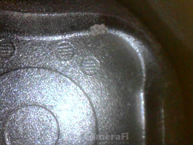

    This is another HG symptom. Do you notice any gurgling sound from the air in the heater core when the engine is cold? A sure way to check for coolant leaking into the cylinders would be to use a borescope / endoscope. If a cylinder had any coolant passing into it, the piston would look like it was steam cleaned. This is my #5 piston. I'm planning on replacing the HG's. Still driving, but really warm it up before moving.
