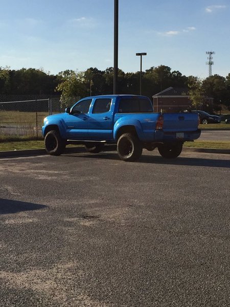

    This is my truck on 884s and a deaver AAL. Still has some rake but I like it for when I carry any sort of weight. Got right about 2" from the 884s and a round 1.5" from the AAL. With the plate bumper though I would go 885s to account for all of that extra weight.

    I do now but did not in that picture. The height didn't really change much. It just doesn't sag quite as much under weight now.
