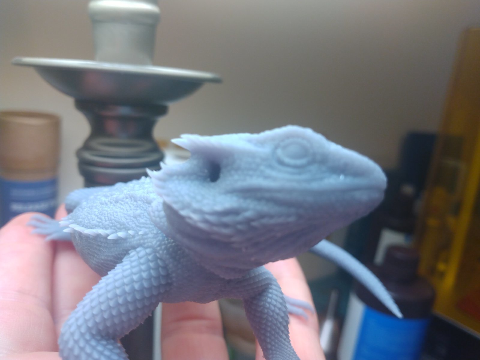

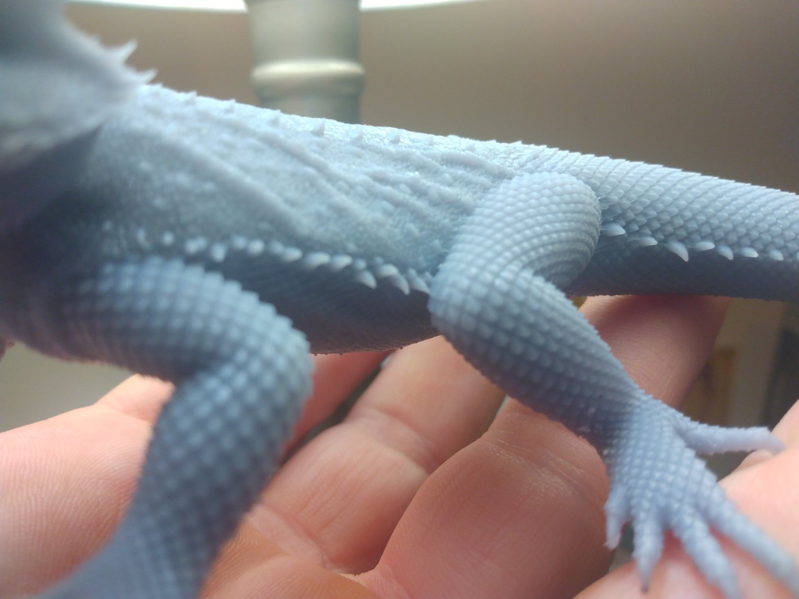

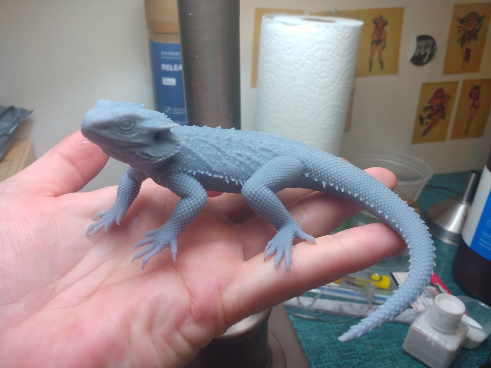

    Printed my daughter a 1:1 scale baby Bearded Dragon. This thing came hot off the printer with 0 need for any sanding or filling, quite amazing honestly.
    After printing another one, one of my very first prints ever on the machine, I finally figured out the need for a new slicer program that offered more versions of support, and more options overall.
    Im now using Lychee occasionally and even sometimes the OOB AnyCubic slicer, but am transitioning to VTS (Voxeldance Tango) but have yet to fully explore it. I can confirm it offers some new options, but need more time with it.

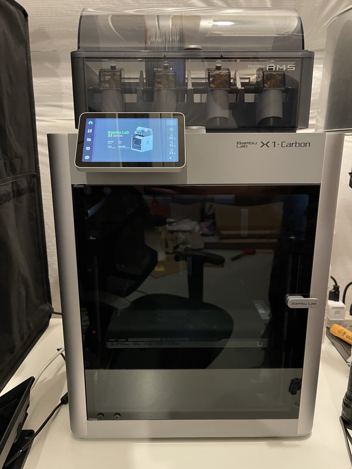

    Fancy! and pricey....

    How does the sword assemble? I cant see the seams.
    Also, holy crap that's big money, but the automatic spaghetti detector would have me sold. :spending:

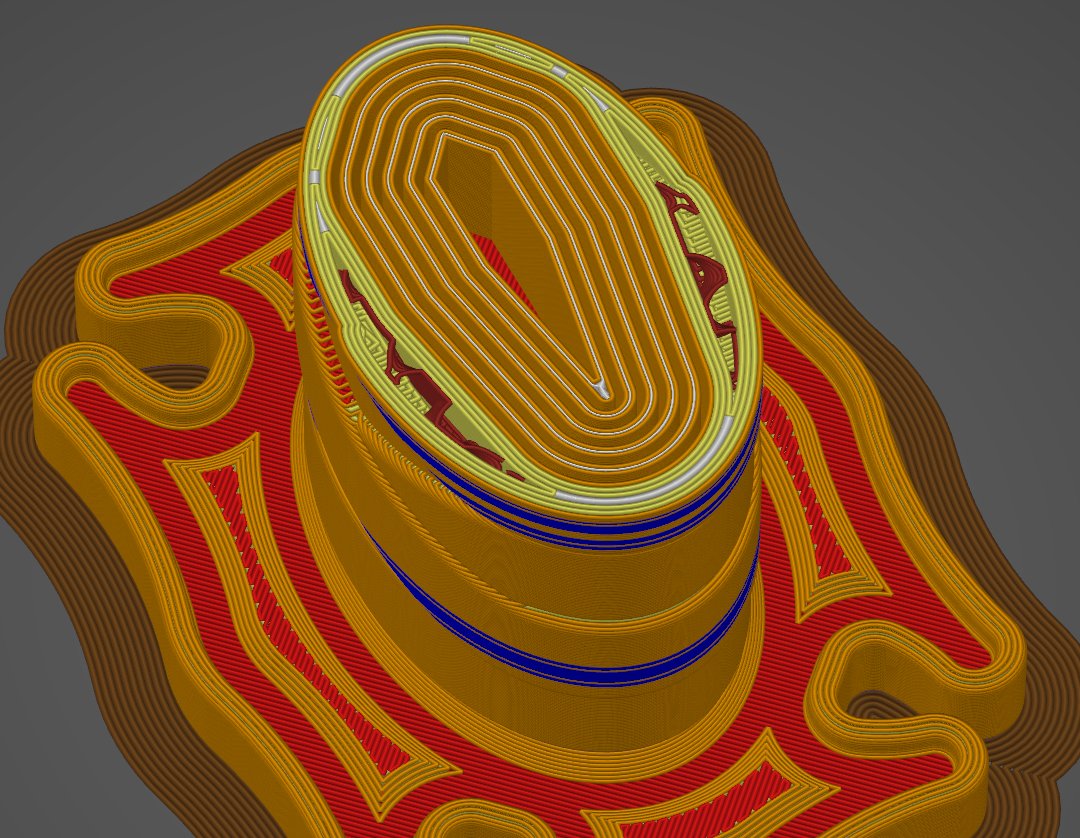

    Yeah, big money for sure but most of what I print these days are structural parts that need stronger filaments. Plus I'm at a point where tinkering with and troubleshooting my Ender 3 is getting tiresome. The AMS/multi-material unit also gives me more options even if there is more filament waste (though some of that can be mitigated a little).
    The katana is a collapsible print-in-place model that I scaled to 200mm height: https://www.printables.com/model/543260-collapsing-katana-v2-print-in-place
    How it works makes more sense when you see it in the slicer:

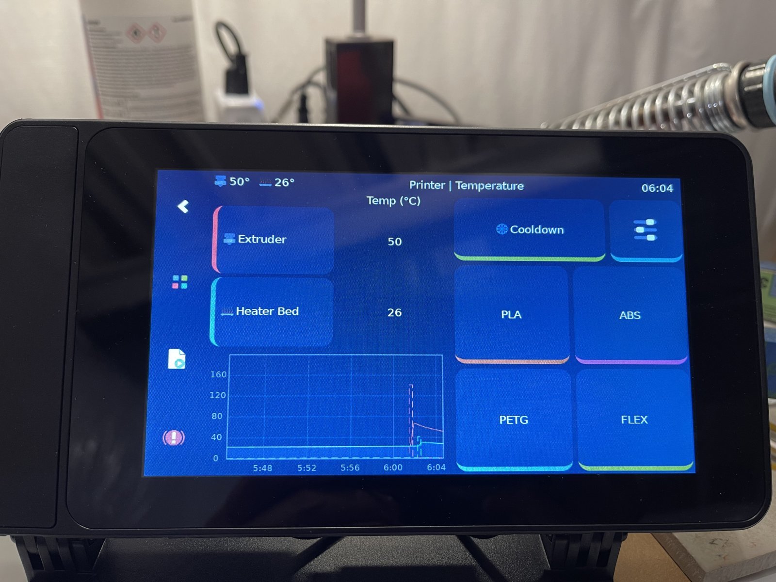

    Speaking of my Ender 3, i started running into an issue where the printer would just halt mid-print after about 45 minutes. This was happening whether it was enclosed or not, so I replaced the Creality 4.2.2 mainboard with a BTT SKR E3 Mini V3 and switched to Klipper firmware using the RatOS image. Took some manual tweaking in the config file and I still have some tuning to do but it’s running. I had a 7” Pi touchscreen sitting around so I’m using that with Klipperscreen. Using the touchscreen is so much faster and easier than navigating the menus with the click knob. The Raspberry Pi is piggybacked onto the display in the case so in essence I made a DIY Creality Sonicpad.

    Cool....so, multi-material, does that mean FDM and SLA/MSLA both, or other FDM options?

    It's still all FDM but it lets you automatically switch to different color filament for certain parts of your print, for example. Or if you have a print that requires a lot of supports, you can have it automatically switch to a specialized filament at the support interface (easier to remove or if you want fancy you can use a dissolvable support filament). The unit works with the printer to automatically cut and unload the current filament and load the new filament and purge the nozzle over a specialized chute, which is what leads to filament waste. Some mitigation can be done by purging into the infill where it's not visible, but for smaller models it's not as effective.

    What is the working volume/area?

    256x256x256mm, so slightly larger than my Ender 3.
