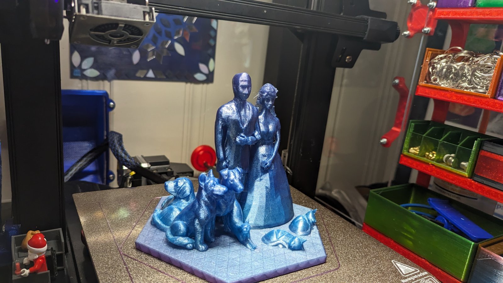

    Yes, higher layers, and only on silk. I have been reading that this seems to be a common problem amongst certain silk colors. My observation is that one layer doesn't want to bond and will curl up, causing collisions and further delamination. You are probably right, its cooling too quickly. Its a big print so its suffering the temperature swings that the house is going through this time of year.
    Well its not the color I wanted, but the PETG version turned out alright for the upcoming white elephant party. Fiancee is already arguing that she's going to try to win it back. :rofl:

    That looks awesome :rofl:

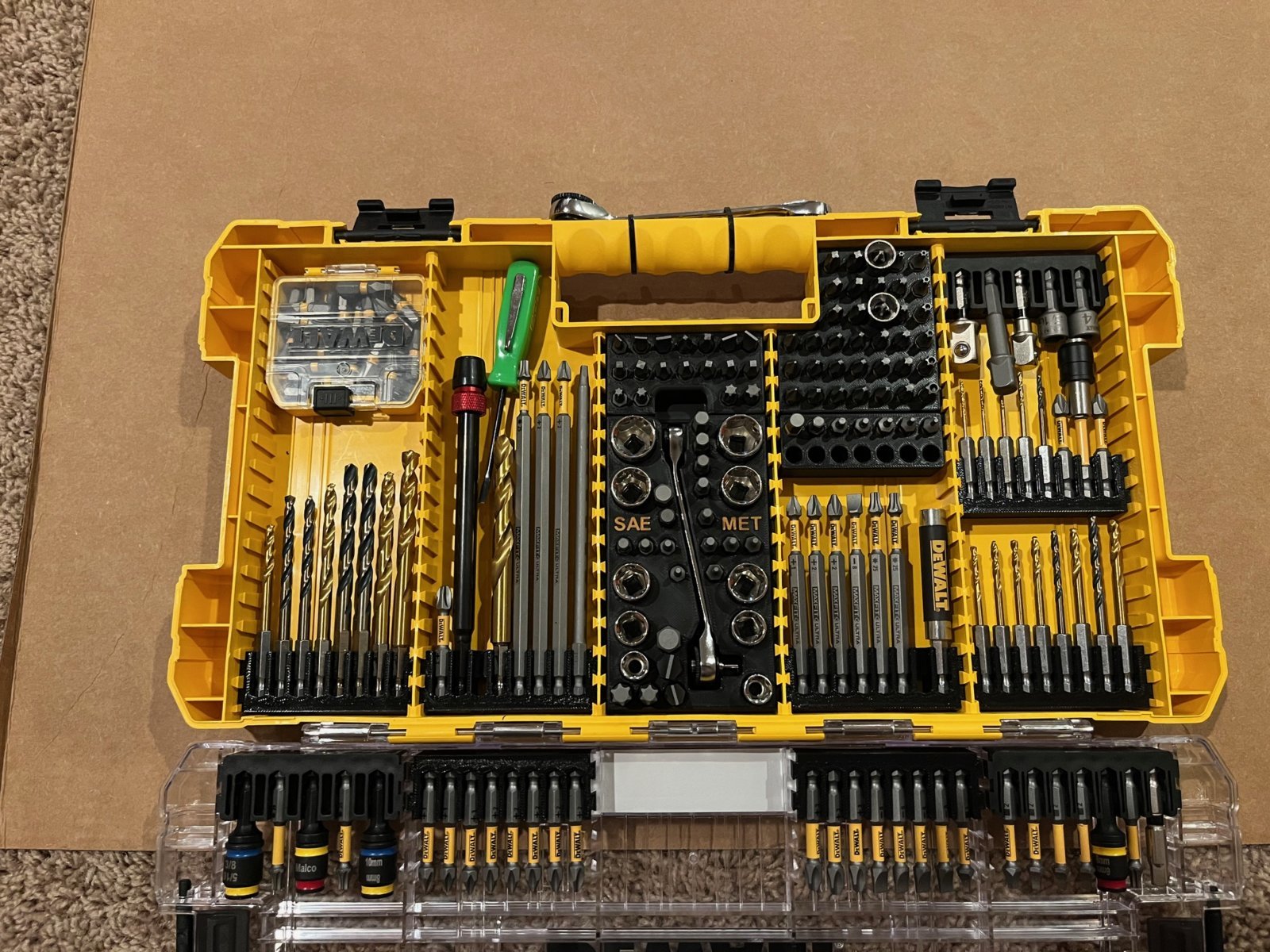

    Finally got all the pieces together for the Christmas gifts.
    Added several kits together for the ultimate bit set. There's always room for improvement but thought this was a pretty solid kit.
    Dewalt 120pc bit set kit
    Milwaukee 15pc drill bit set
    Gearwrench 34 pc micro driver set
    Vim Micro ratchet
    Makita 3 pc sq. drive impact rated
    Diablo 6" locking extension
    Dewalt locking extension
    Malco 4 pc driver set
    Kreg 6" sq. drive bit
    Tekton 9 pc metric bit set
    Drywall bit set 2 pc.
    Amazon mini pry bar.
    3D printed the socket set, bit set and most of the bit holders.
    All bits have magnetic backers so case can be inverted w/o a complete catastrophic event. Bonus: NO RATTLE!

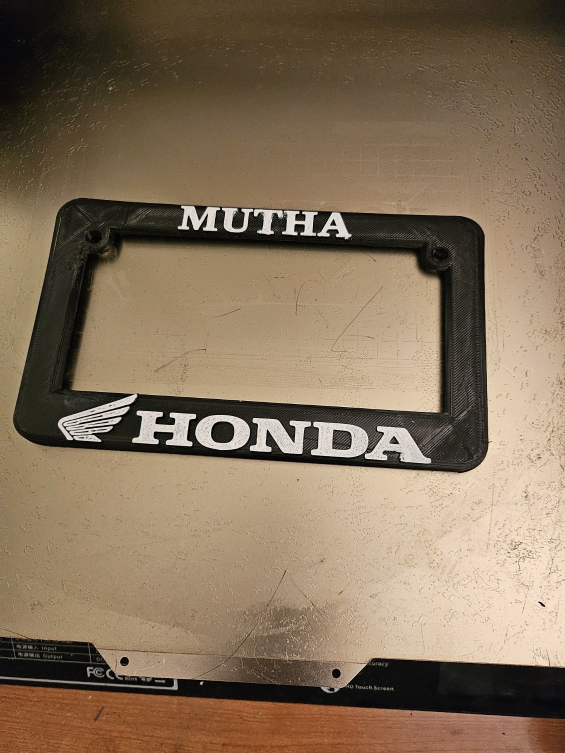

    for an etsy customer..

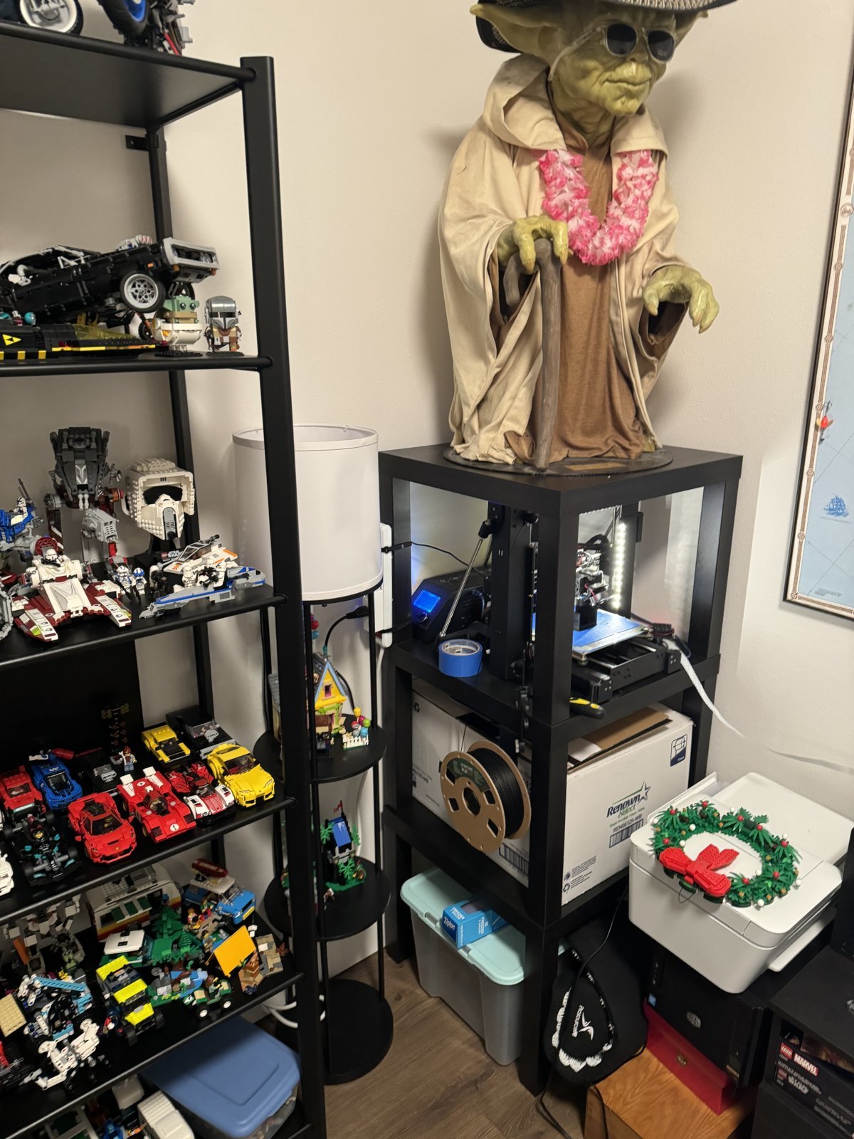

    Moved a few months ago and just fired up the 3d printer for the first time since then. I remember fussing about with bed leveling for hours when I first got it, didn't even bother checking today :anonymous: Damned if it didn't print pretty well though. Maybe a touch low on one corner but overall not bad.
    3d printed a grill, then cut a big 'ol hole in the front of my pc case.
    Currently printing a new spool holder to clip onto the ikea lack tables I have stacked in the corner. Small office and I had to do what I had to do, so Lack stack it was hah.

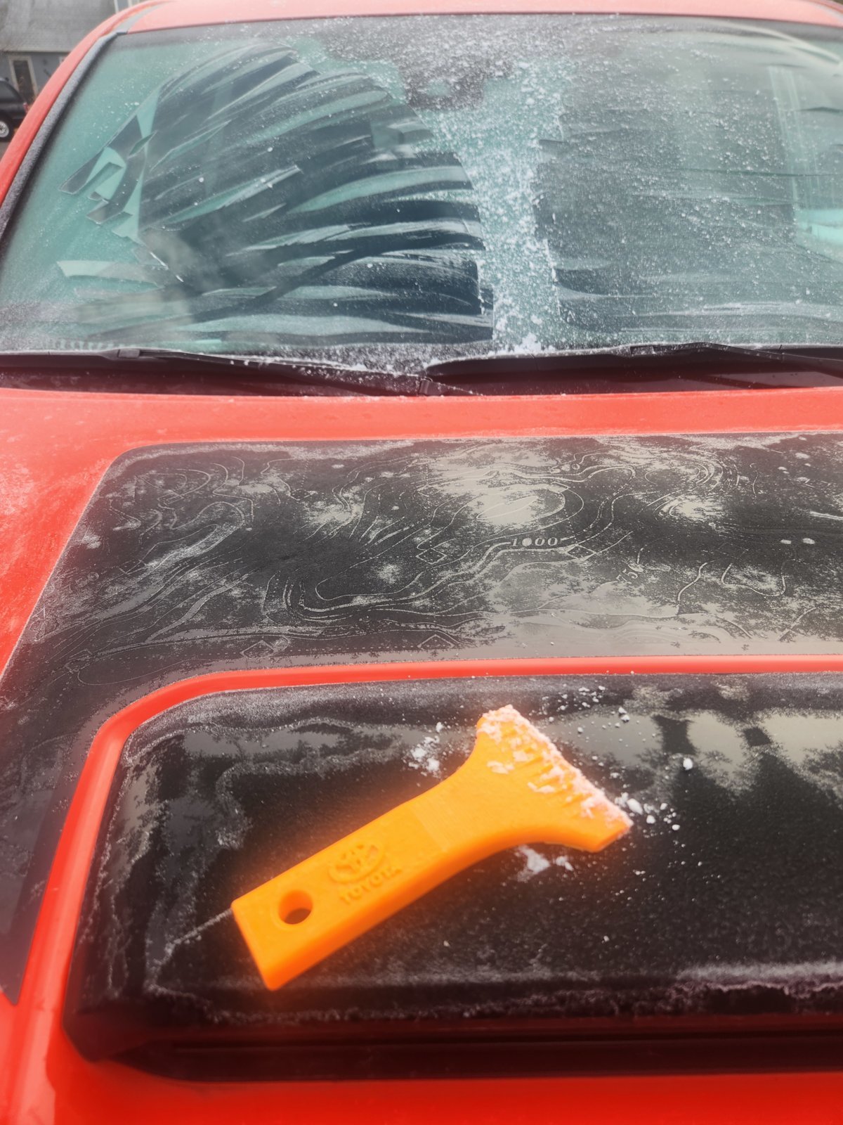

    I let my 10 year old save up mowing lawns for a printer. He made me a Custom ice scraper.
