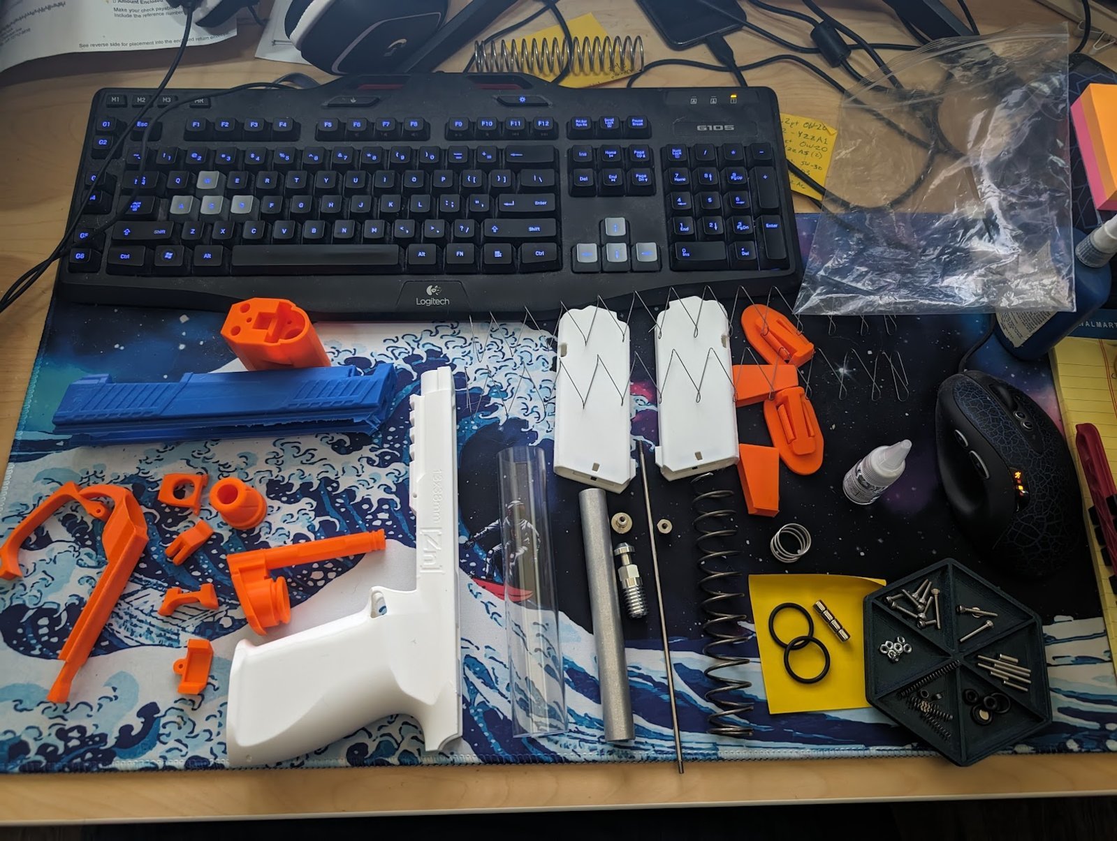

    Figured there was a thread here. My wife got me a Voxelab Aquila X2 for xmas (Ender 3 clone) and I headed down the rabbit hole. I had no idea you could get a printer this cheap (she was worried that she overpaid at ~$150).

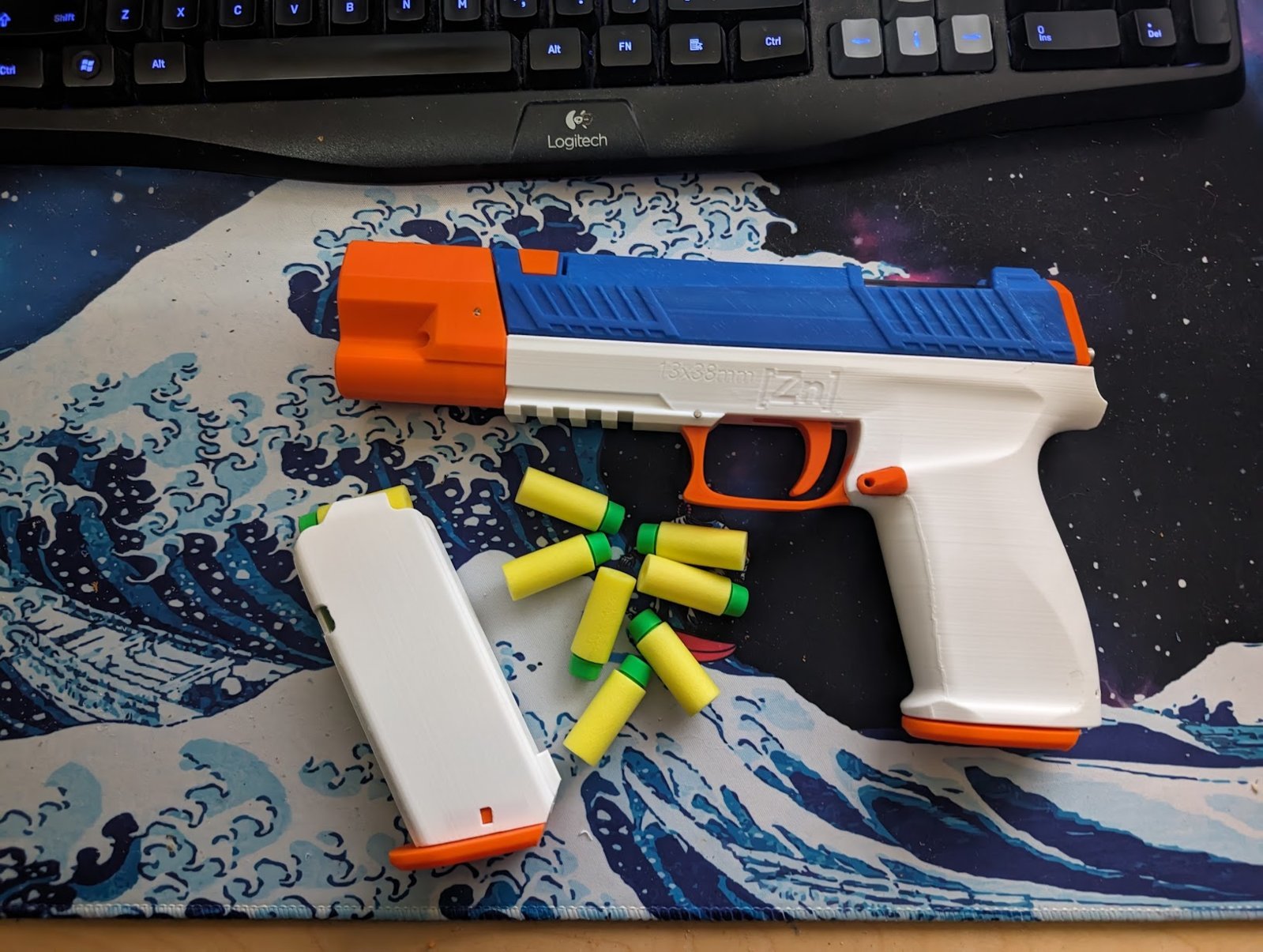

    Anyway, started with printing stuff to upgrade the printer like I guess we all do, some useful items for the kitchen, then decided to take on a "project." Did a Zinc 2.0 Nerf gun with some "improved" parts. Fun project, and it works well!
    The printed parts and the overpriced hardware kit:
    ABLVV84NjTPzlL7VBaLgjlFbZdDv9clZz2Ao6mE2_75b4a628d79d1386d6bfcb300072630afd3cec42.jpg
    The finished product:
    ABLVV87gmLRKamVc_-4RE0wnkStCeVFrKFe1Eqkw_aef091ffcc773e3c5ba409c78c1e63eae3d13ace.jpg

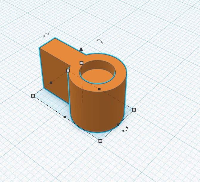

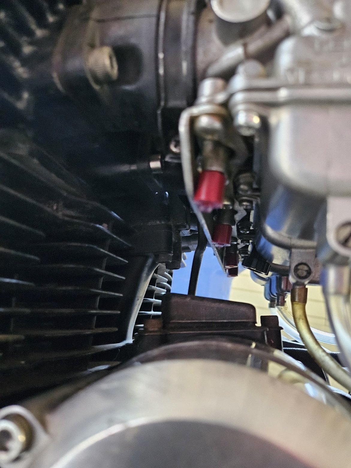

    needed some limiter caps for my carbs

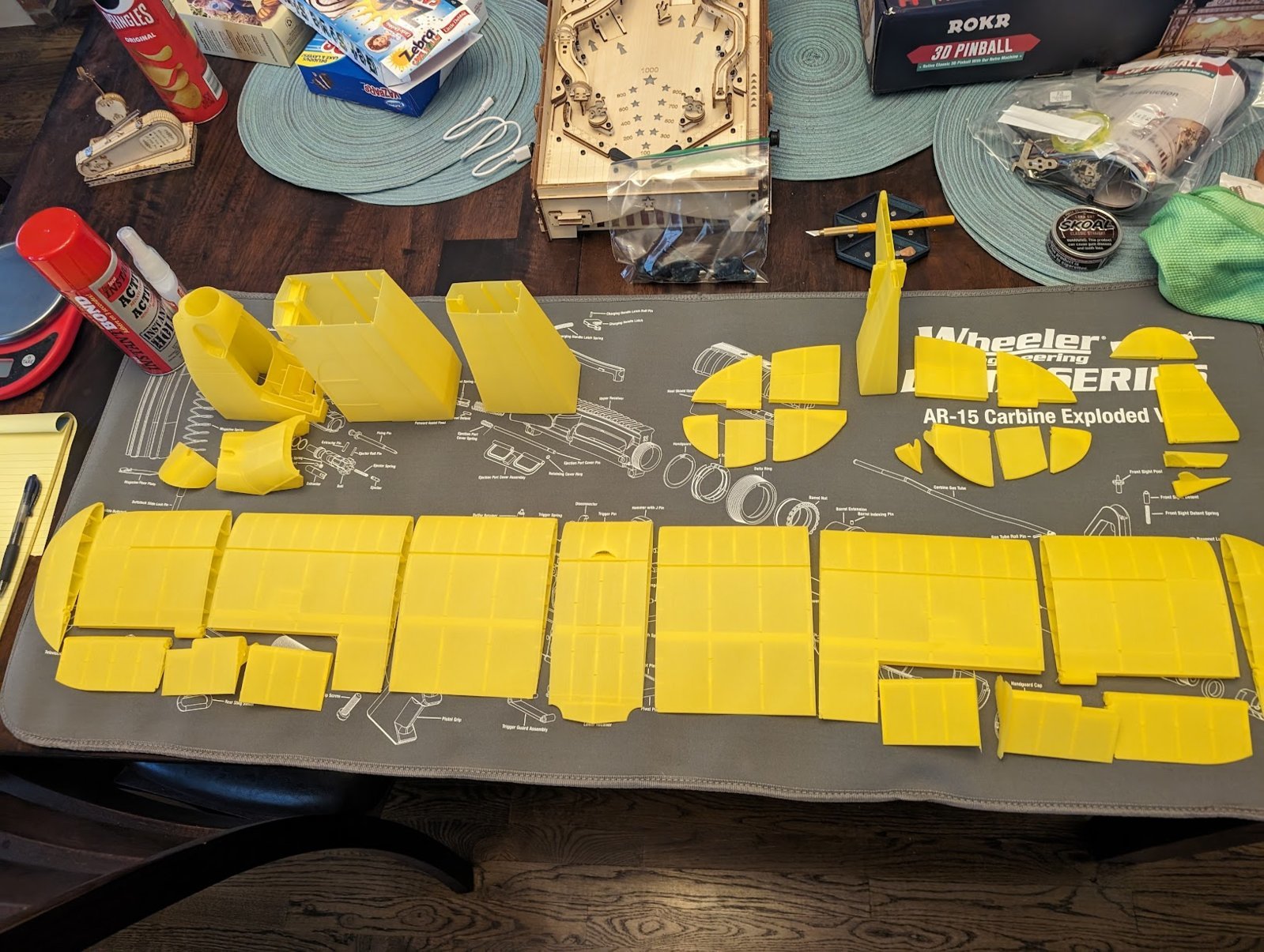

    Shared in the Helldivers thread when Kwikvette asked about 3D printing, figured I should share here. After about a month I finally finished up all the parts for the 3DLabPrint Piper Cub (free model). Most parts were printed at least 3 times. I was using Cura, which was terrible for these particular models since they are single-walled and not solid. I didn't realize that a lot of internal structures were not being printed properly, and sometimes not at all. So, I eventually tried PrusaSlicer and followed the printing guide provided and they printed beautifully (mostly). The Overture Air PLA (pre-foamed) likes to eventually clog the nozzle, so it was important to clear the nozzle out after every couple of prints. And since it is lots of tall, single-walled parts and I don't have auto-leveling, cleaning the bed with IPA and making sure it is level at the same time was important.
    AP1GczO-bG647RywBTS1ocabgh4WiFATs2PqfQye_6afece1aaa330017f30783ce9c69b8b93a41ba69.jpg
    Wingspan is 42", and fully assembled with ailerons the wing weighs 156g. That's pretty dang light! With LW PLA, total printed weight should be around 224g, so I will be over that, but as long as I am not more than 200g over it should still fly.
    Well, anything can fly at least once.

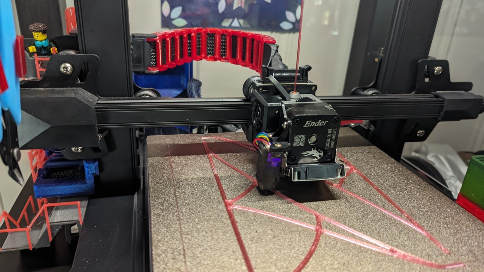

    New print head arrived today. I decided to just replace everything from the carriage forward and strip the old assembly down for spare parts.
    :anonymous:
    Leveled and offset-ed, and new PIDs fine tuned. Now we have the .6 nozzle on and are banging out a couple of quick parts.
