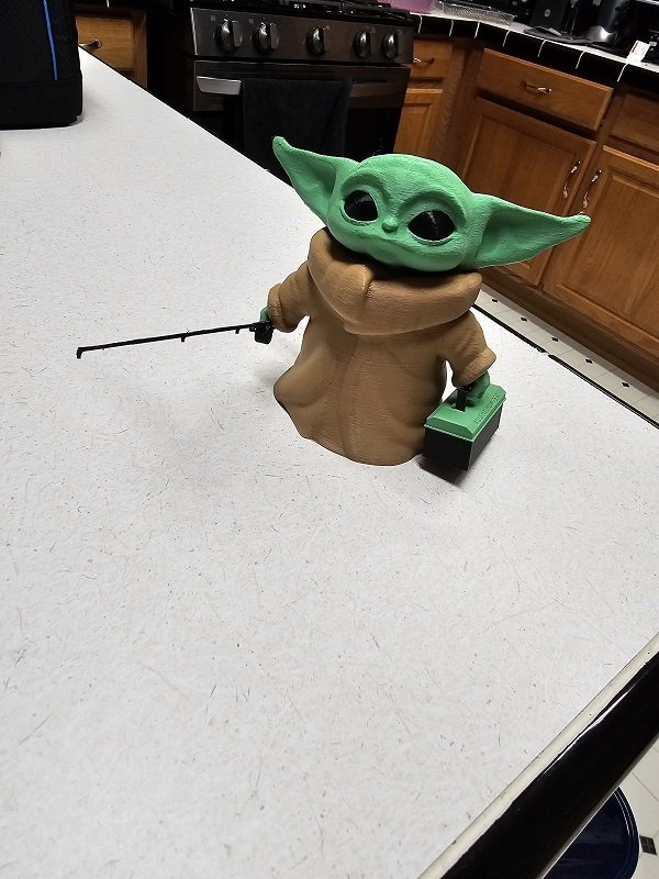

    Finished this the other day for my mom. My dad passed away in Jan and he was a huge musky fisherman, and my mom likes baby yoda.
    I found the baby yoda on thingiverse, pulled the hands into blender and learned how to add bones to models so I could make his hands like they were holding something, then I made the tacklebox and fishing pole in Fusion360.

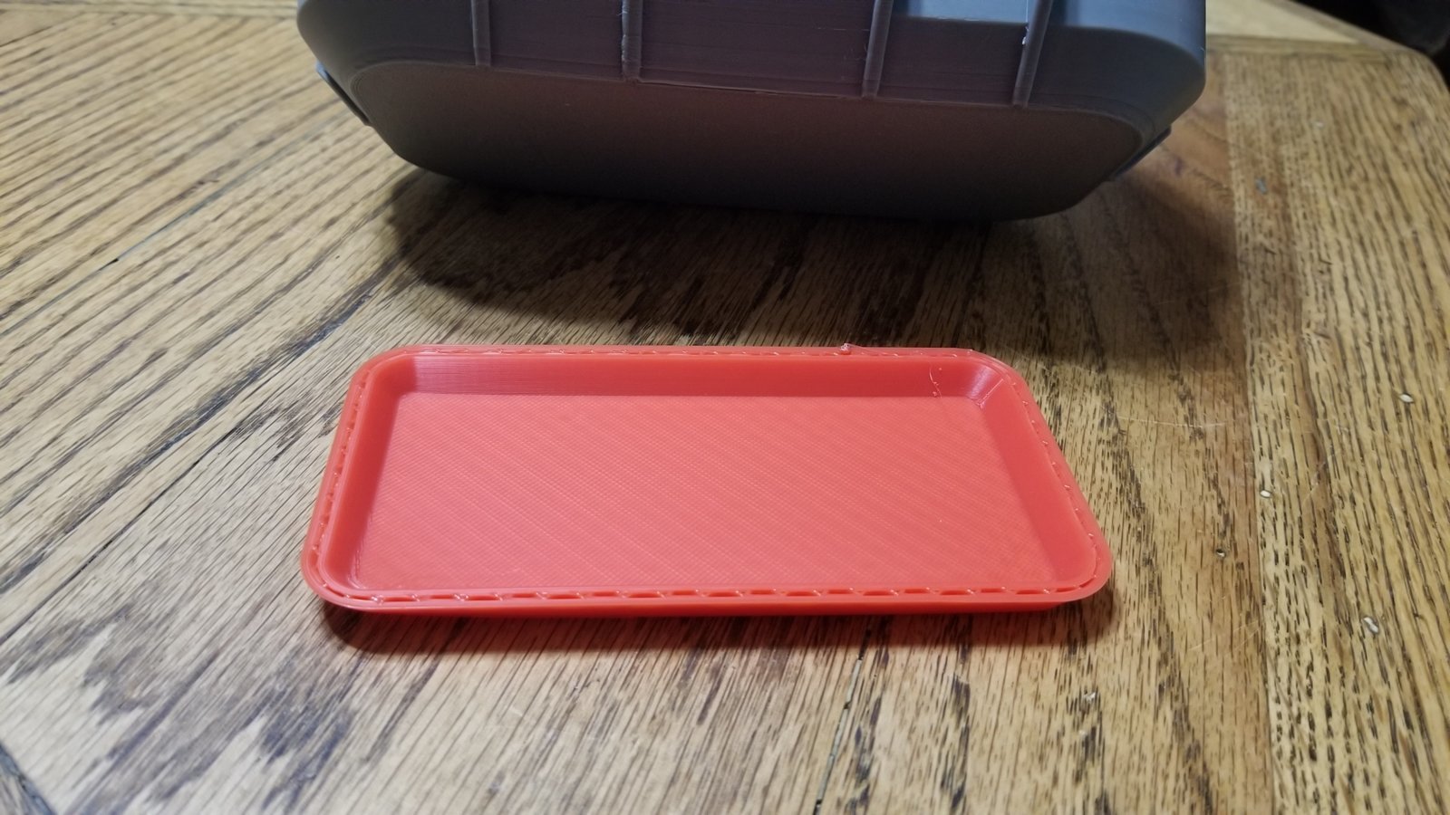

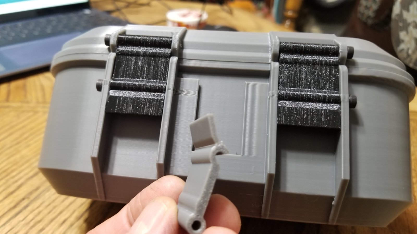

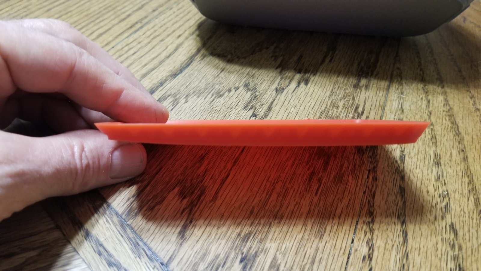

    Just happened to have a roll of PETG delivered yesterday, and re-did the latches for the box as one of the PLA ones snapped pretty quick.
    It is definitely stronger, and fits better, like it's more dimensionally correct.
    Not sure if the rough surface is normal, but it's fine for latches.
    I just switched the filament in the slicer and the machine went with 235C and 70C.
    Then switched to PLA for a snaplock box, and forgot to switch it in the slicer, so it raised on the corner, I assume from the extra heat. The rest was stuck pretty tight.
    But it makes a nice little parts tray.
