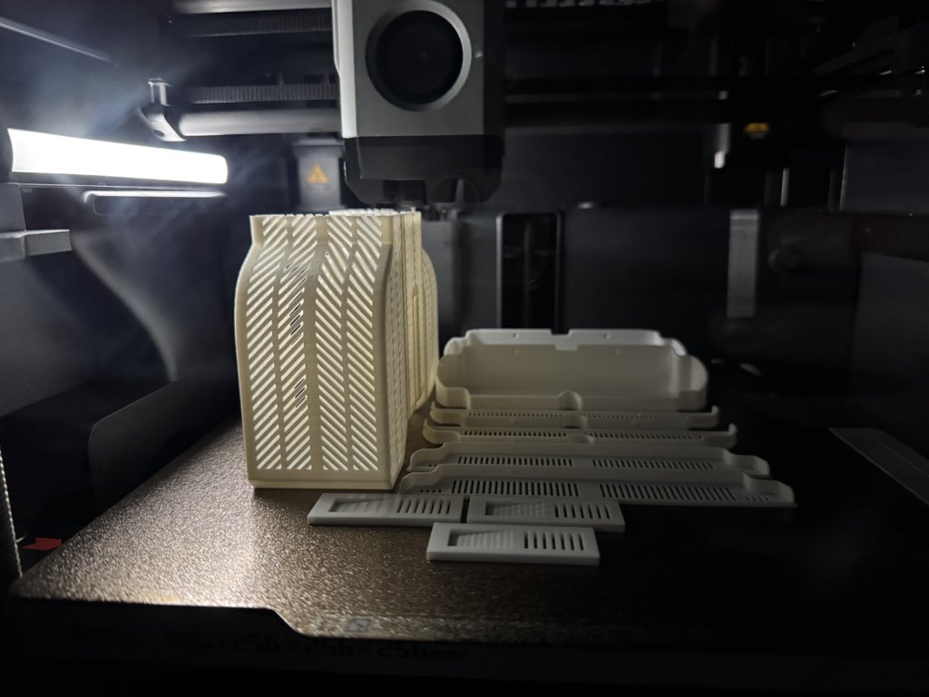

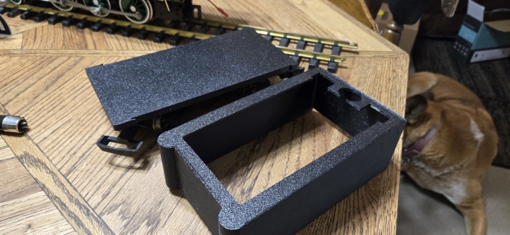

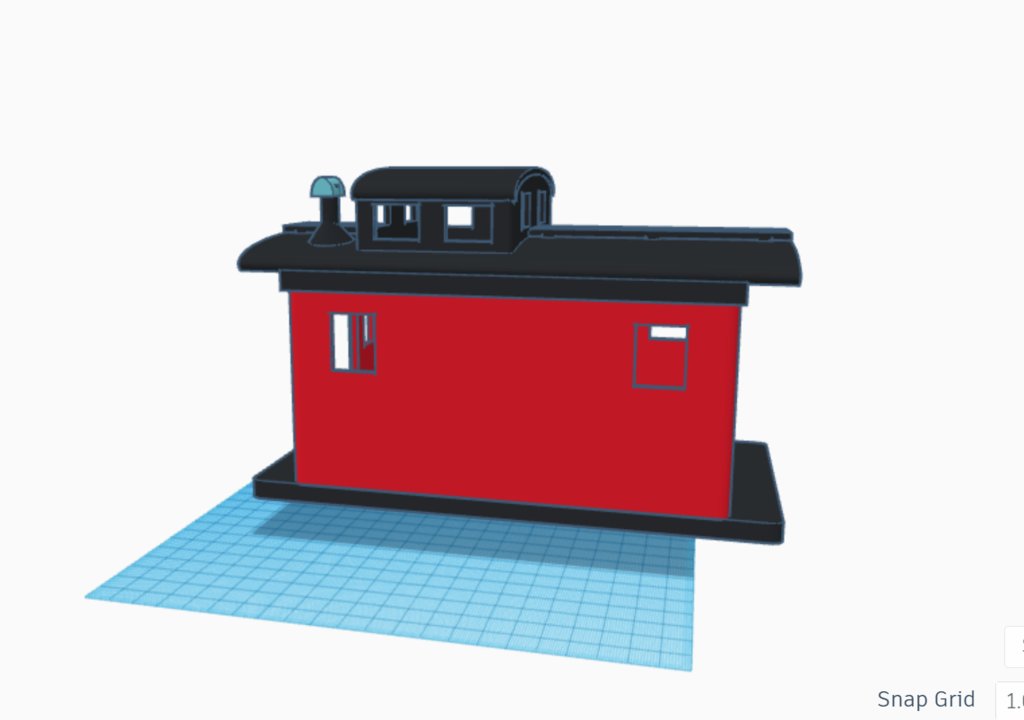

    Printing a tender for a G scale locomotive that I kit-bashed into another model.
    The top should be done sometime today.
    and a caboose for the weekend.
    I may redo the shell and try to get more of a board like, wood grain kind of surface.
    By next week I might have a short consist of home made cars to pull around.

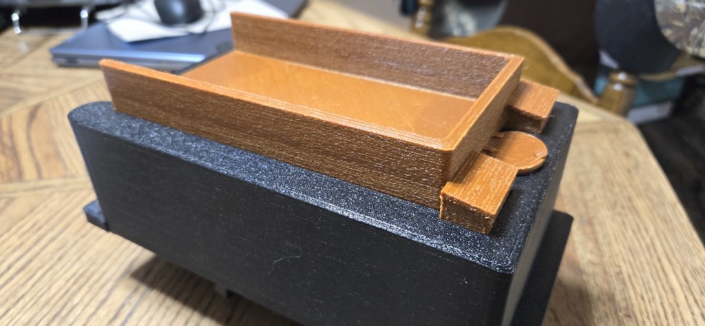

    I like this brown. Gonna print the caboose shell with this.
    It has a nice wood grain look to it.

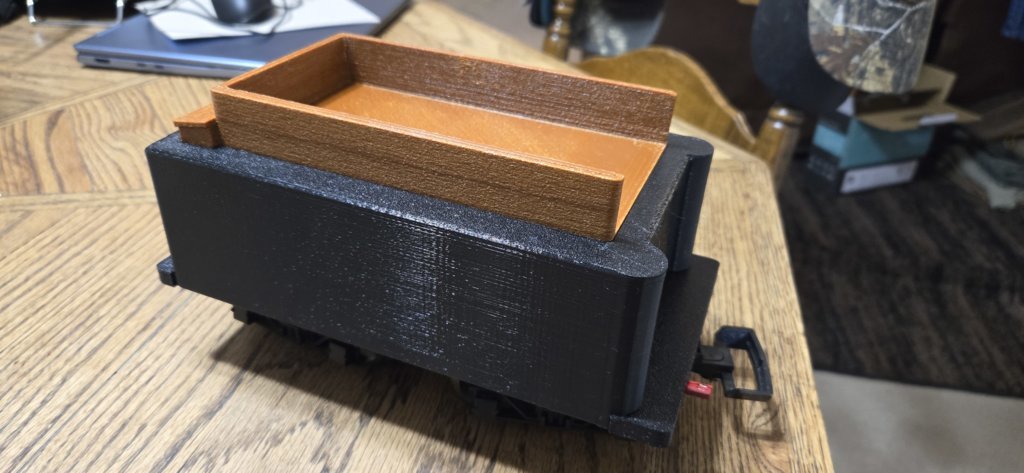

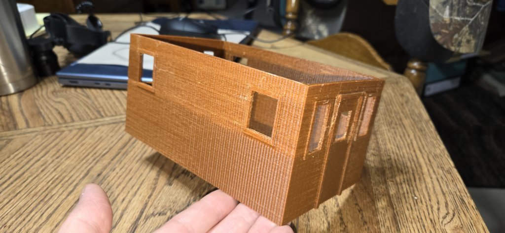

    I could have made the boards a bit wider. I'm gonna roll with it. :D
    Still needs a little cleaning up.

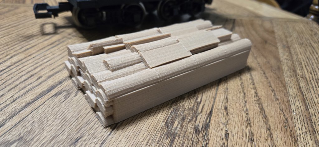

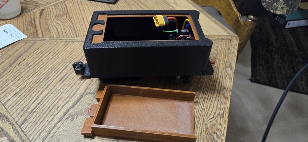

    Load of wood for the tender.

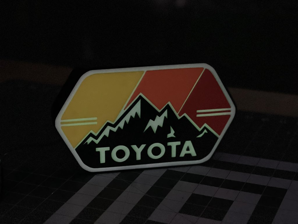

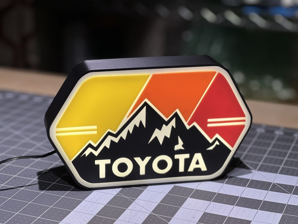

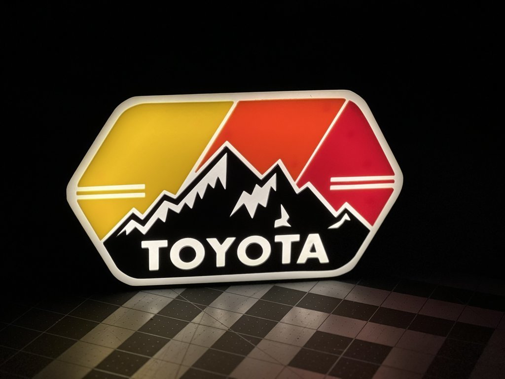

    I like this one quite a bit. Just released by user jamisonusmc on Maker World - it's called "Toyota Retro Sign LED Light Box Shelf Display". I happened to have all the colors to print it today. Instead of white for the background I used glow in the dark for funsies and I swapped around the red and yellow to match the actual livery color order.

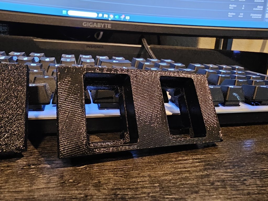

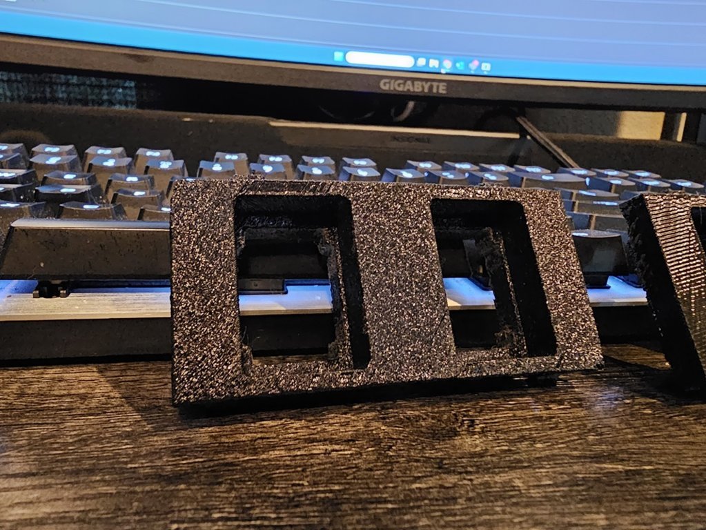

    Printed a upper console switch panel yesterday. I didn't like how it looked so I tried Creality fuzzy skin. It's better, it gives it a more OEM texture but I still don't like it, but I'll use it for now.
    I really don't like how this Overture PETG prints. I've tried many different settings but it always strings like crazy and globs in spots. It also ends up shiny even though the filament is supposed to be a non-glossy black. After seeing ITmaD prints I think I'm going to give PET-CF a try.
    non fuzzy skin:
    fuzzy skin:

    What printer are you using for that?

    Bambu Lab X1C with AMS. Makes it easy and lazy for me to do multi-color prints.

    Are you running multiple AMS units to be able to get the 5 colors?

    I think you'll love the P1S. If I get another I will probably just get a P1S. I actually had to untrain myself from diving too deep with my X1C because of my prior experience with less-easy printers. These really just need the basics to work amazing. I just have one AMS, so 4 filament capable. On this one I just did two prints, one with 4 colors and one with the black parts. And applying different colors is pretty easy in the slicer once you do it a few times. You can 'paint' using face selection, or better yet, just apply a different color to an object itself.

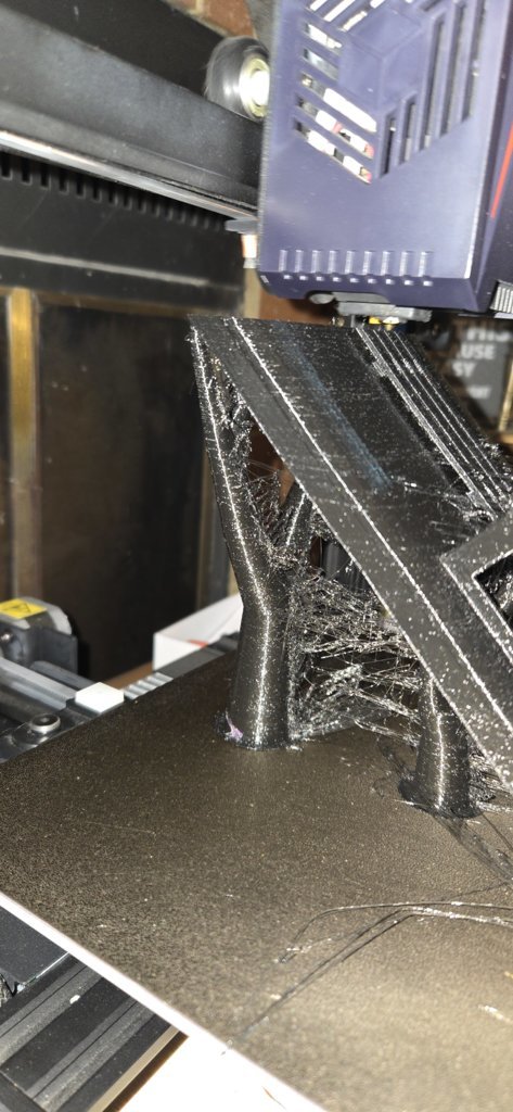

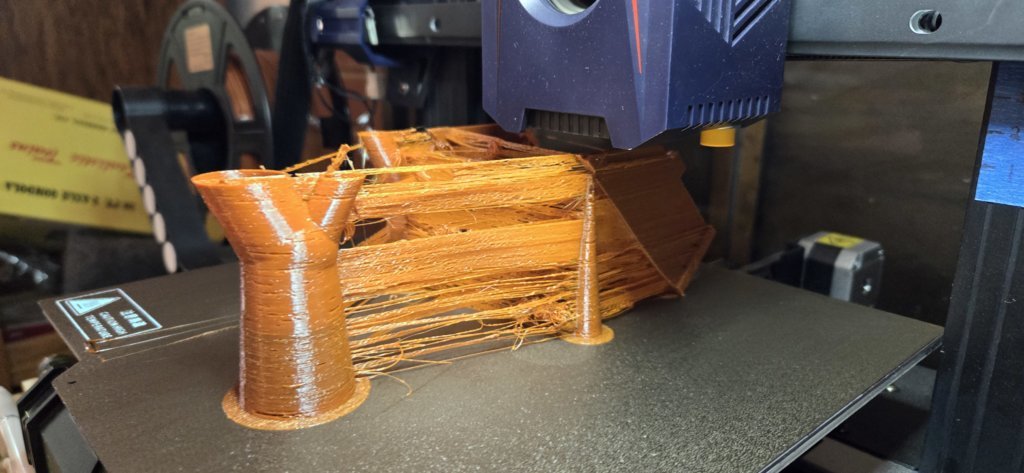

    This stringing is almost structural. :rofl:
    Previous prints I had the pullback speed set to 10mm at 100mms and set the print speed at 70mms and had pretty good results, minimal stuff and it was thin.
    This print I slowed the print speed down to 50mms and left the rest. This is the result.

    Yikes! What material is that?
