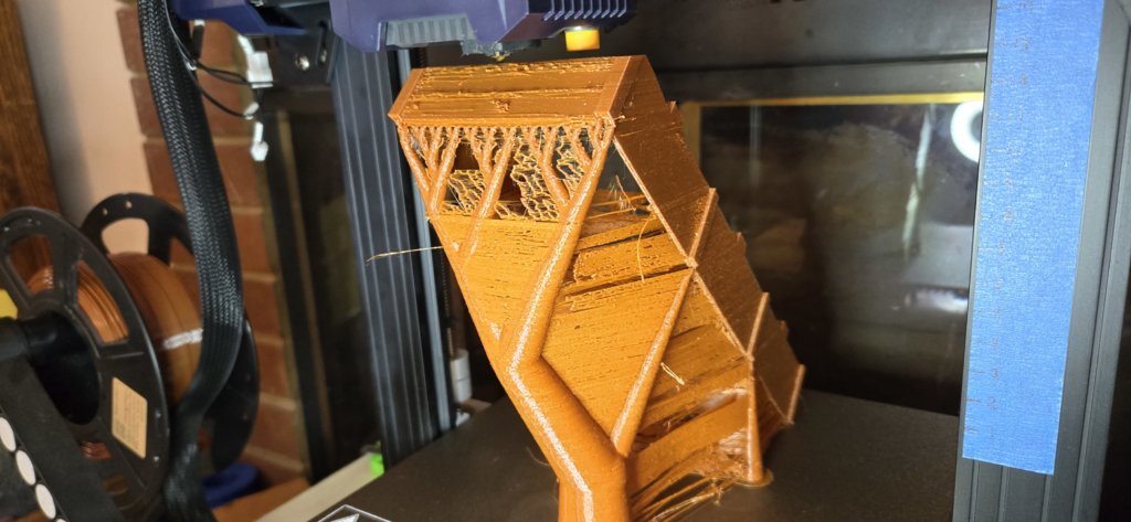

    Elegoo PETG. I guess the "goo" is somewhat descriptive. :D
    The Anycubic black doesn't do it near as bad.
    It trims/snaps off fairly easy.

    Dropped the heat from 235 to 220 an hour ago.
    Should have tried that 5 hours ago. :rofl::anonymous:

    Looks like the last time I used wood pla, with zero retract (any retract would just jam up the nozzle due to the wood burning)

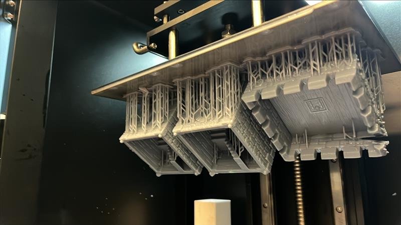

    Resin printing anyone? Took some .STL files and converted them to .ctb and off we go.....except its not always a success.

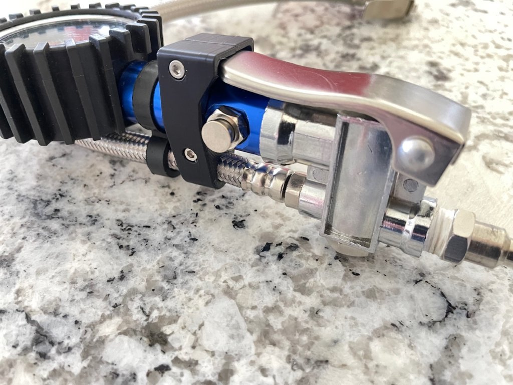

    Even though I haven’t used it for a couple years, I hated fiddling with a zip tie so I made a sliding trigger lock for my ARB tire inflator.

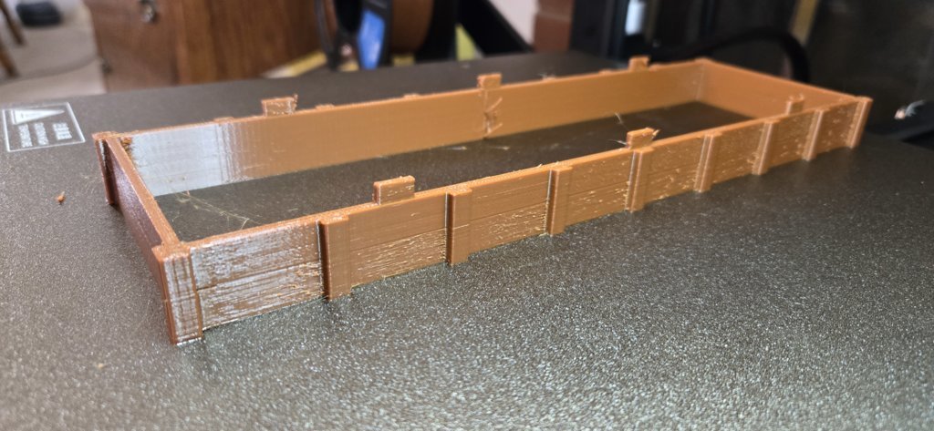

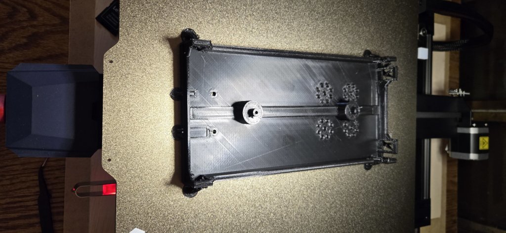

    This turned out way better than that last mess. Same material and piece. Almost using the same settings as the Neo.
    The P.E.T.G. Short line.

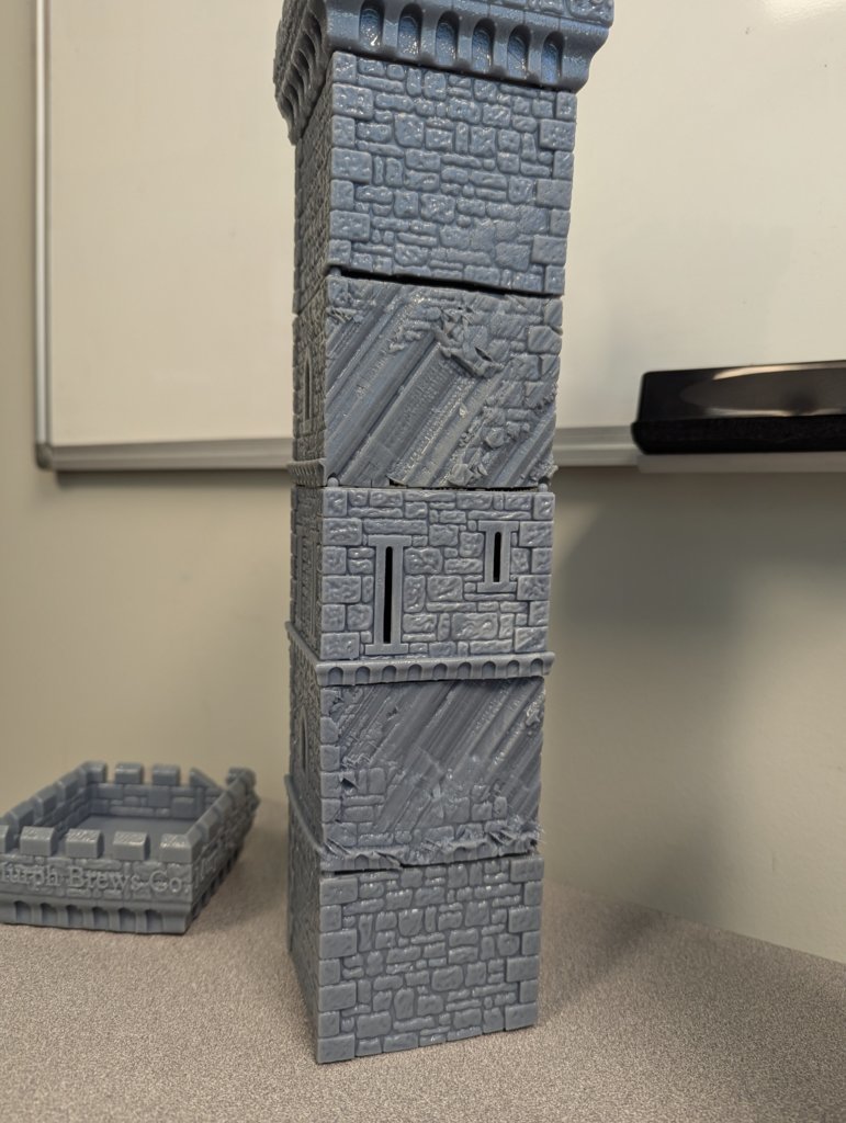

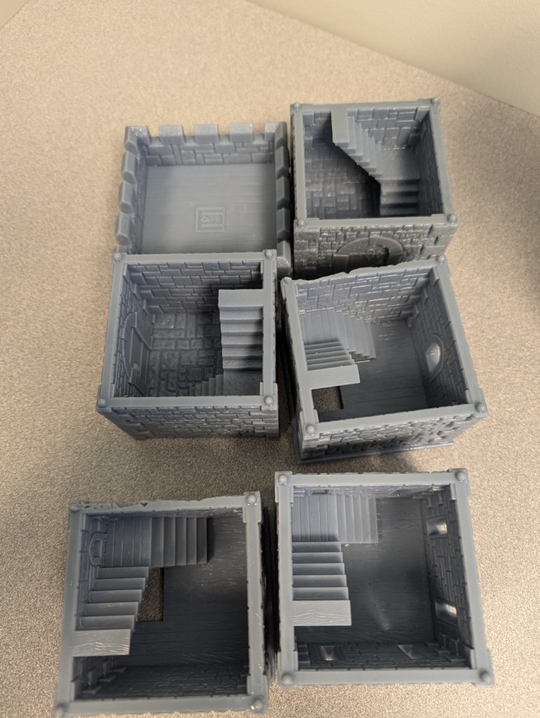

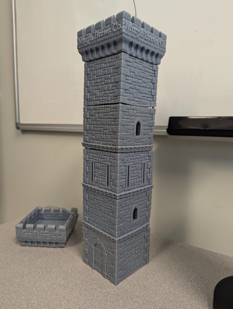

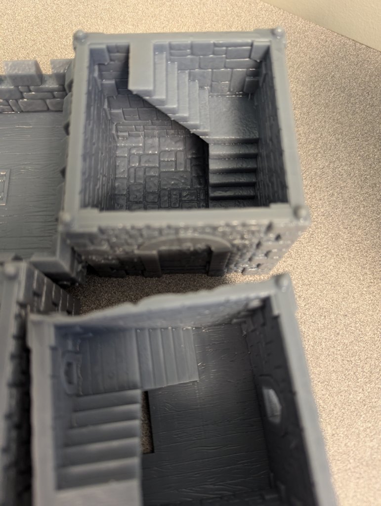

    making a beer tap tower for the kegarator. Had some defects show up but might use those for where the taps go.

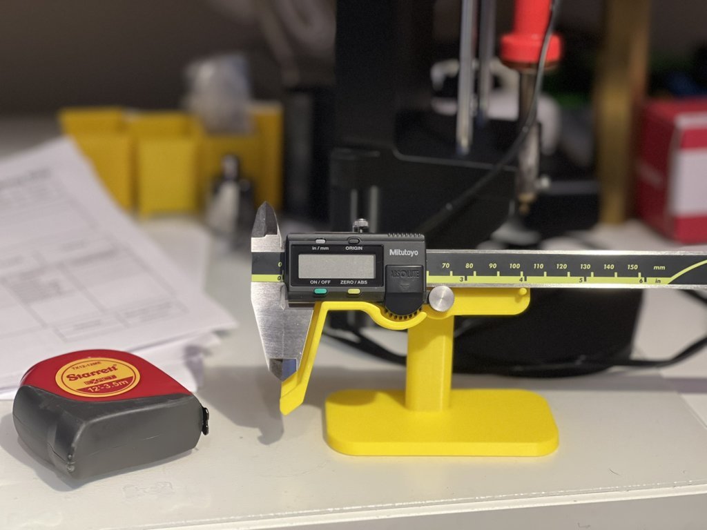

    Simple little stand for my desk digital calipers. I wanted something that kept them vertical instead of horizontal. Found this for the 8"/200mm version, but it works fine for the 6"/150mm (which has smaller jaws) too.

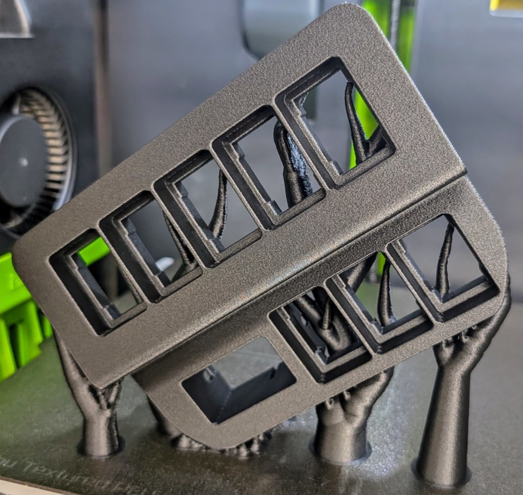

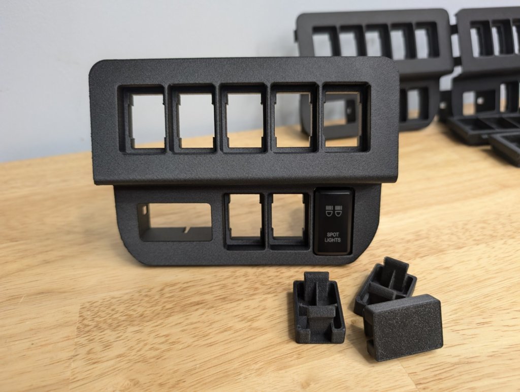

    It's been a minute now with work picking up a lot as we open a new hospital but I finally got around to making a final design ready for the truck panels as well as got the quality tuned to how I like it.
    This is the final version panel quality below. First "production" print with no more tweaking (till I get ideas again lol).
    Probably will create a post and list them up in the next 2 weeks or so with the different configurations.

    Nice........did you make plugs for any unused switch cutouts?

    Yeah, I got a blanks for unused spots too. Photo of them too along with the manual panel version that has a spot for the clutch button.

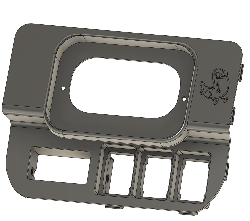

    Special Edition Dickbutt anyone?? :rofl:

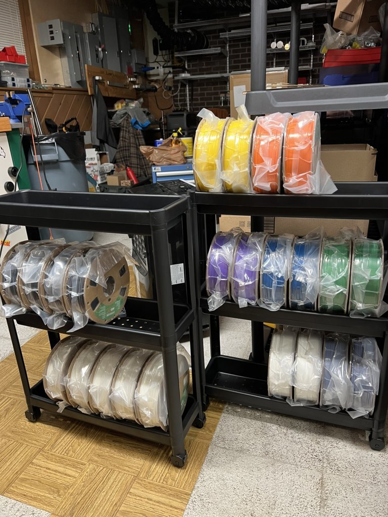

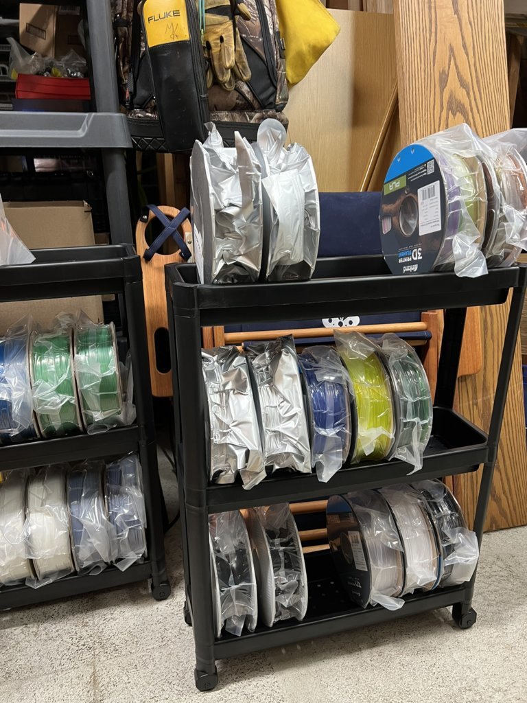

    Not printed parts, but printing adjacent. Got these fabled 'trolley' carts from IKEA that pretty much perfectly hold filament. Love this storage solution. Oh and they're only $10 each.

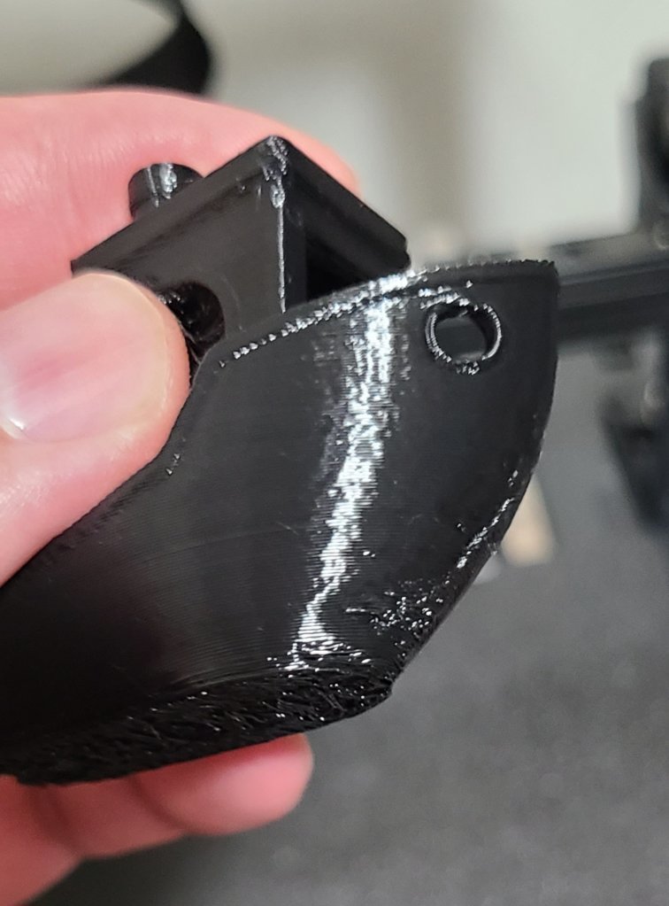

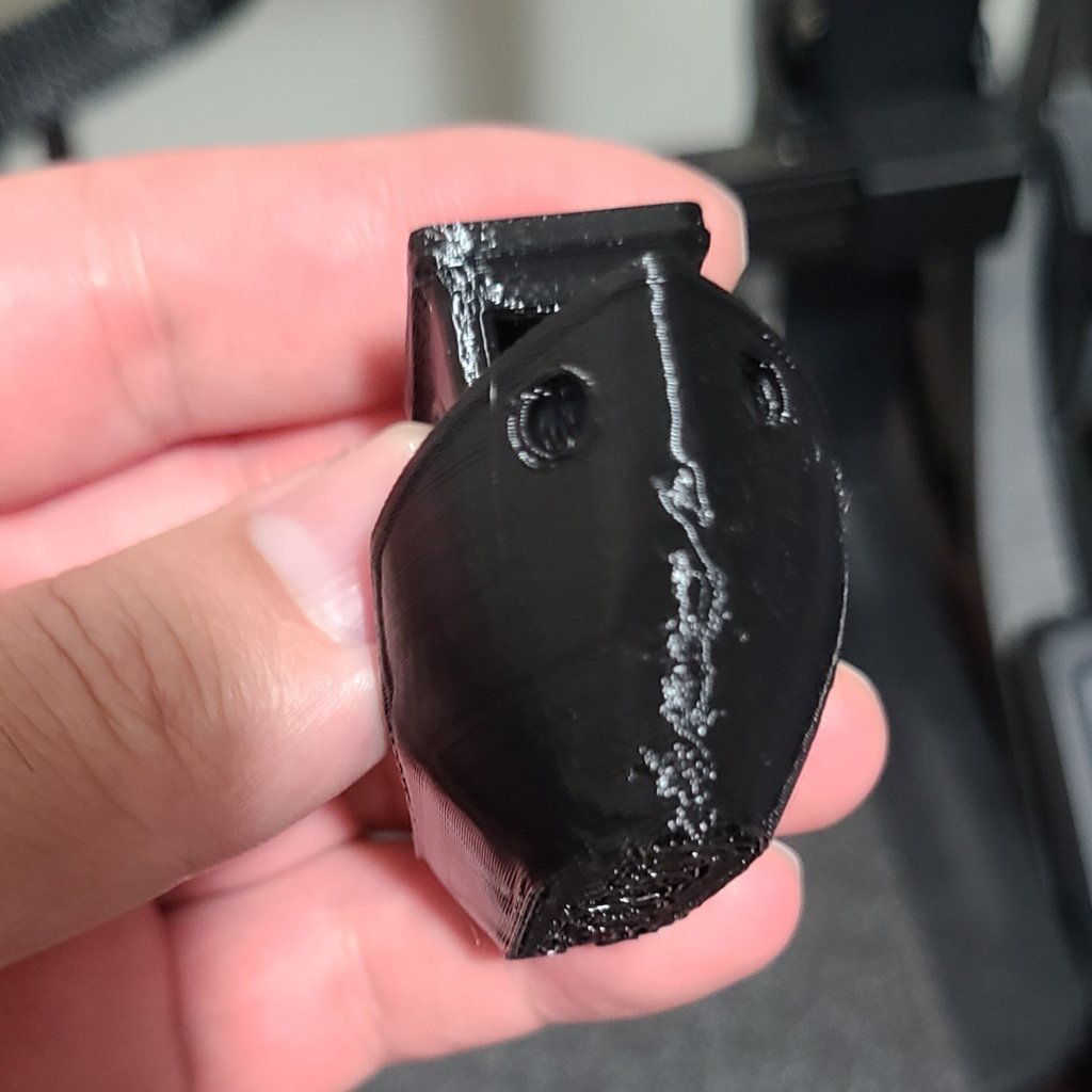

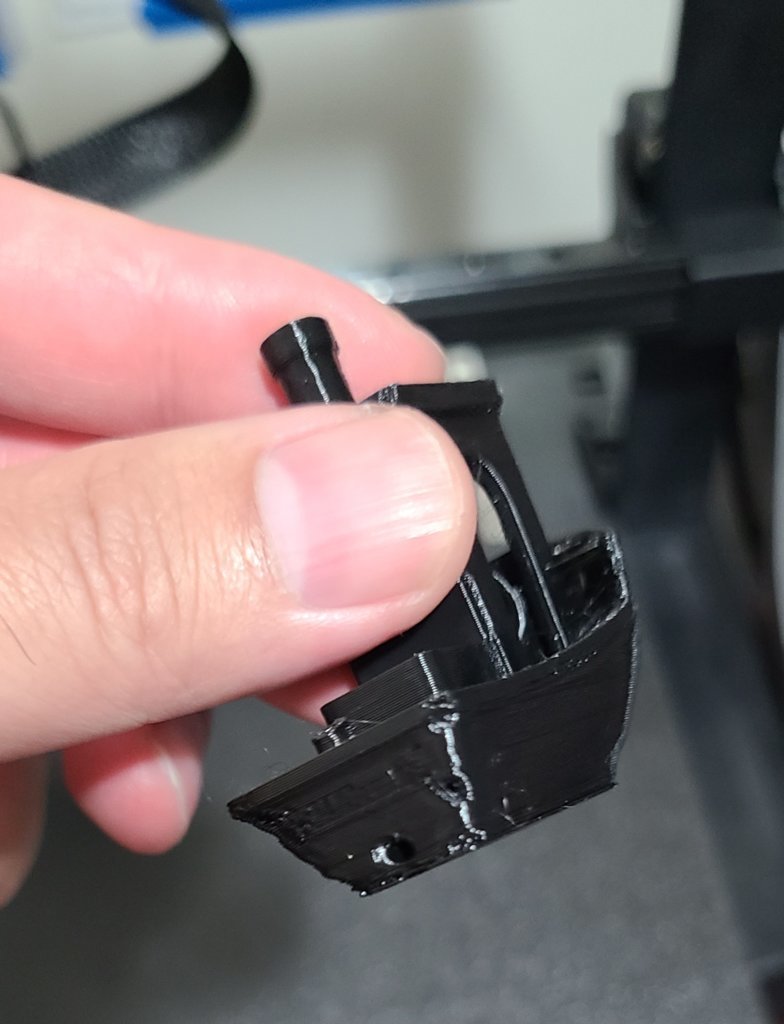

    Any idea why my benchy came out this way?
  18. Sep 29, 2024 at 3:55 PM
    #718
    Revelations
    Revelations Well-Known Member
    Apr 17, 2014
    #127895
    1,125
    2014 MGM DCSB
    Looks like it's having issues at the corners.
  19. Sep 29, 2024 at 3:57 PM
    #719
    ITmaD
    ITmaD Well-Known Member
    Feb 19, 2023
    #418333
    461
    Atlanta
    You might be printing too hot and the parts cooling fans can't keep up. You can try reducing the print temp in 5-10 incriminates and see if it starts looking better.
  20. Sep 29, 2024 at 4:02 PM
    #720
    Revelations
    Apr 17, 2014
    #127895
    1,125
    2014 MGM DCSB
    I'm printing at 235. I could drop it to 230, but usually I don't see that much of a difference in printing with a 5c change. I could up my cooling speed if you think it's too hot. I recently installed a 5015 blower for my part cooling. I had it at 100% cooling before and the part wouldn't stick. I dropped it to 80%.
