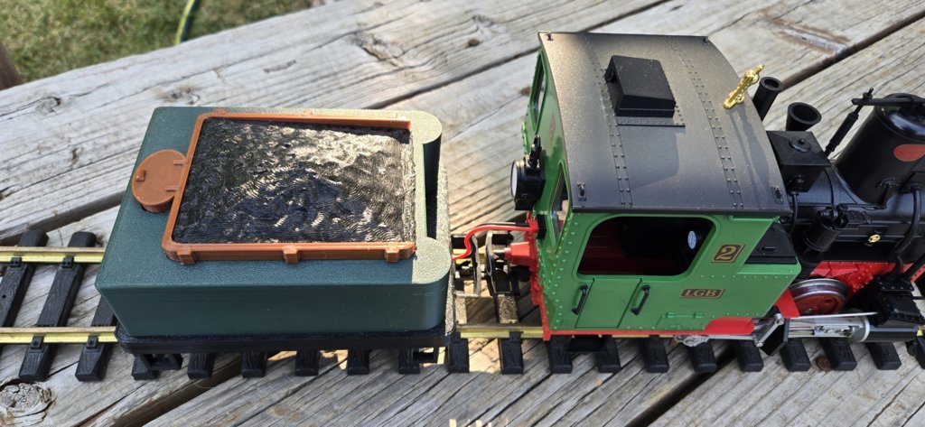

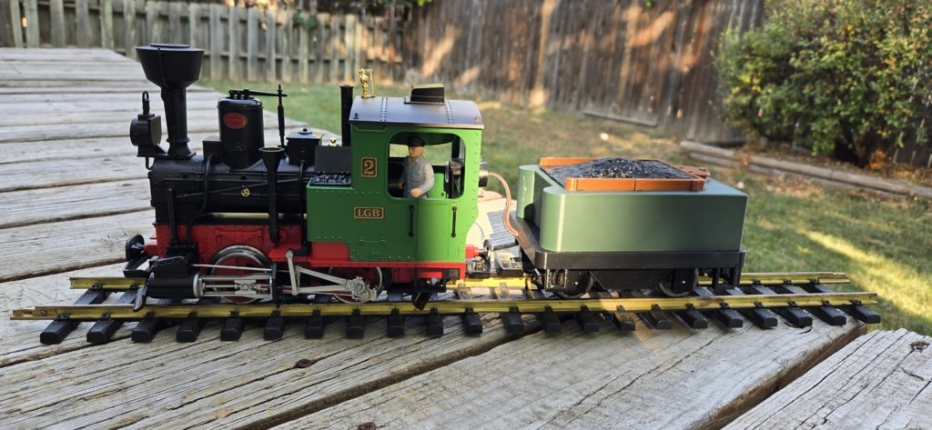

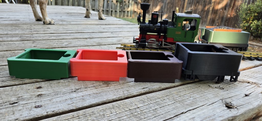

    Picked up a roll of Just Maker Petg for one print. Spent 3 hours trying to just get the first layer to do it's thing. In frustration, I gave up on the new machine and went to the Neo, just to see what would happen. The new machine had been very inconsistent with the Z axis.
    After slicing for the Neo, it printed just fine, absolutely no issues of any kind.
    That prompted the disassembly of the new machine. I had a new hot end on hand, and between that ( it was the nylon sleeve inside that was buggered up) and the proximity sensor being one turn out, it printed better than ever. Ran a test with the new filament and it was a success.
    I think my new machine was assembled on a Friday afternoon. :rofl:
    Neo printed.
    All the flawed prints leading up to it. Really just trying different colors. The brown was a top contender, but that one was flawed where it shows, again the first layer.
    The coal load turned out pretty sweet. I can't seem to find where the file came from. I just remixed it.

    How old is that starter set loco? It looks immaculate.
    That piece was my first one, I got it when I was six years of age. And it definitely shows 40 years worth of collisions, derailments, storages and moves.

    I love this little loco. I've always wanted one of the Stainz models.
    I think that one is fairly new, like somewhere in the last two decades. It has DCC on board.
    That was an Ebay score from an estate sale. It was listed as non running and sold cheap for parts. Part number is 20212. Good luck finding any info on it, I haven't yet.
    Turns out the power switch was just turned off. :p Everything works.

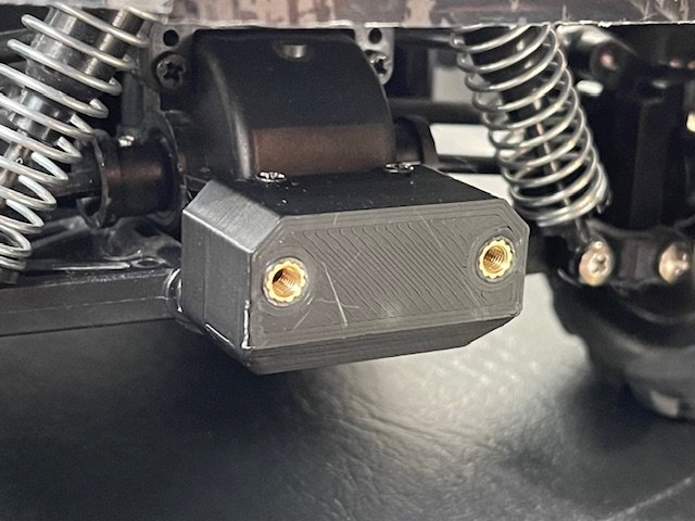

    What haven’t I changed?

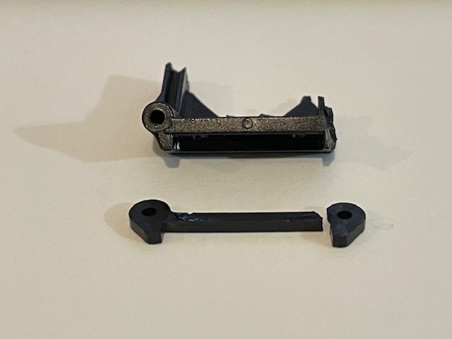

    My kid brought home his friend’s RC truck for me to fix because it had been broken for some time and they weren’t able to fix it. Upon inspection I found the battery pack was dead/bad and also the front LCA mount was broken.
    I drew up the replacement pieces in CAD, but printed parts can be notoriously weak so I changed it into a double shear design and added threaded inserts so I can print different skids/bumpers for customization.
