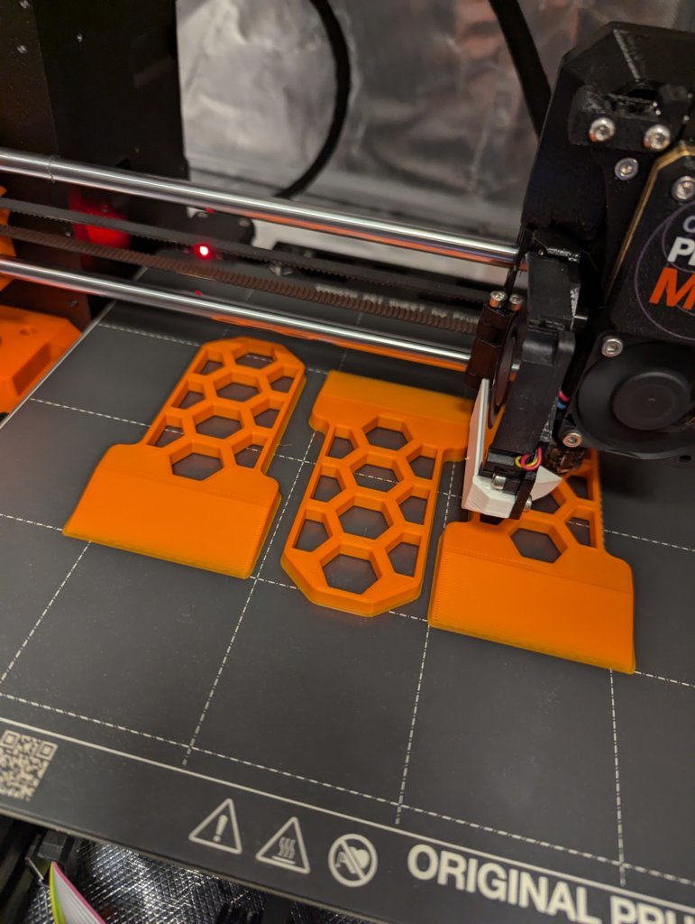

    Nothing crazy but just some scrapers

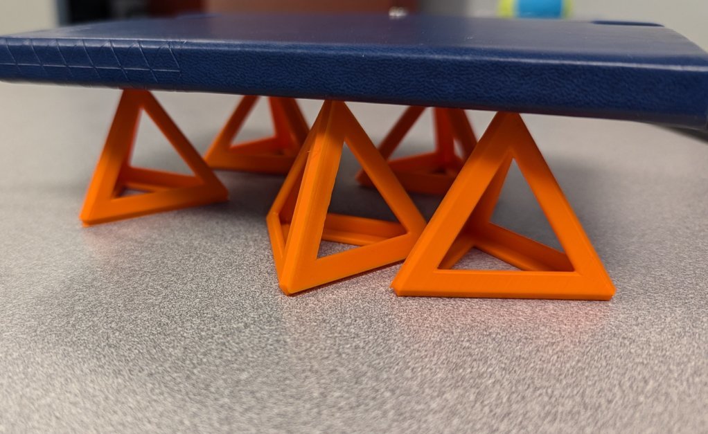

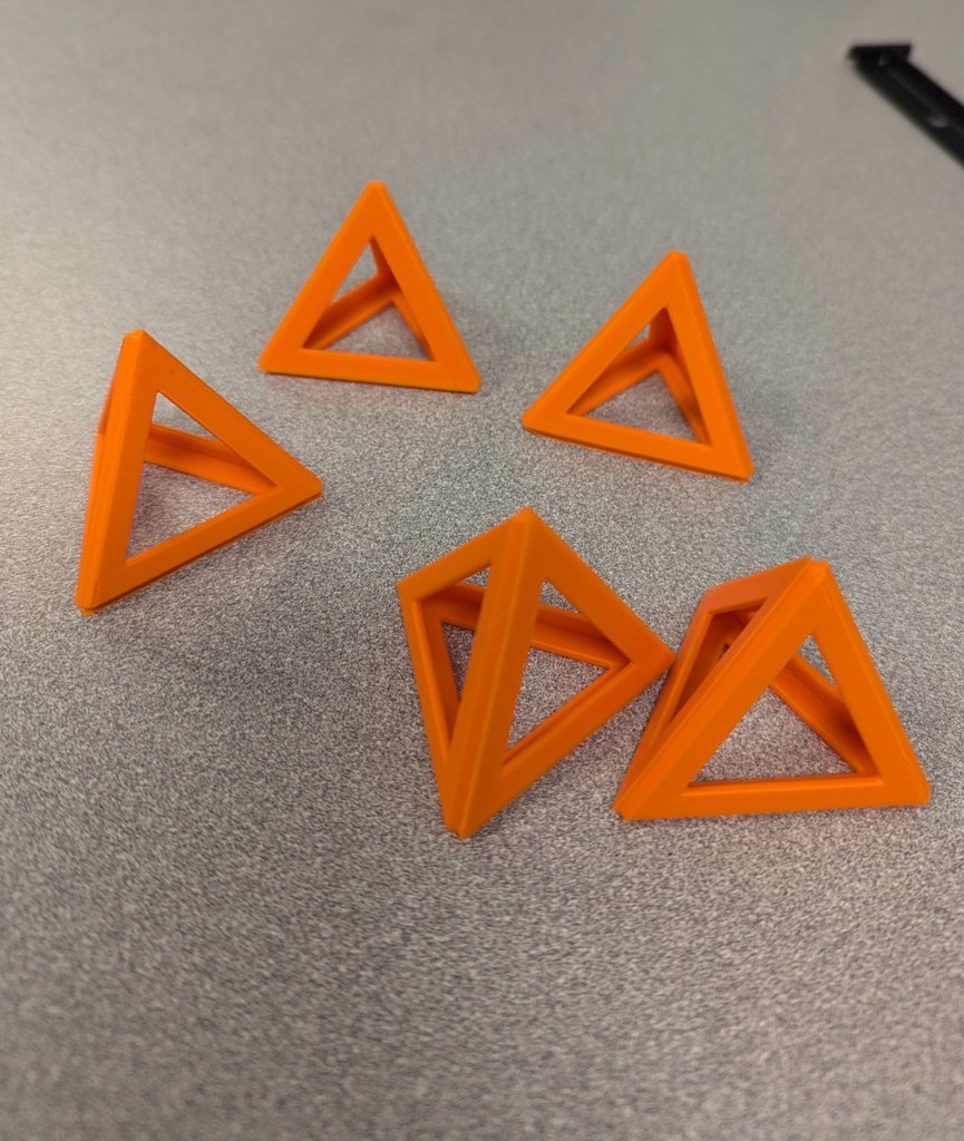

    some holders for when I'm painting or staining.

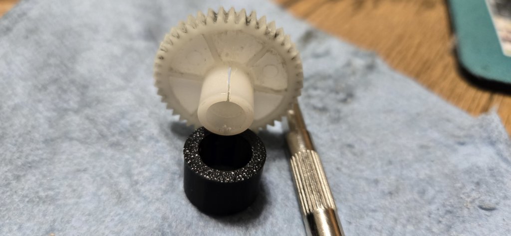

    Do tiny parts count?
    I had a loco that's a few decades old split a final drive gear. Parts no longer exist.
    I added some more relief to the split and made a collar for it to pinch it back tight.. Was able to press the shaft back in with a vise.
    Worked way better than the zip tie fix from a few months ago.:D
