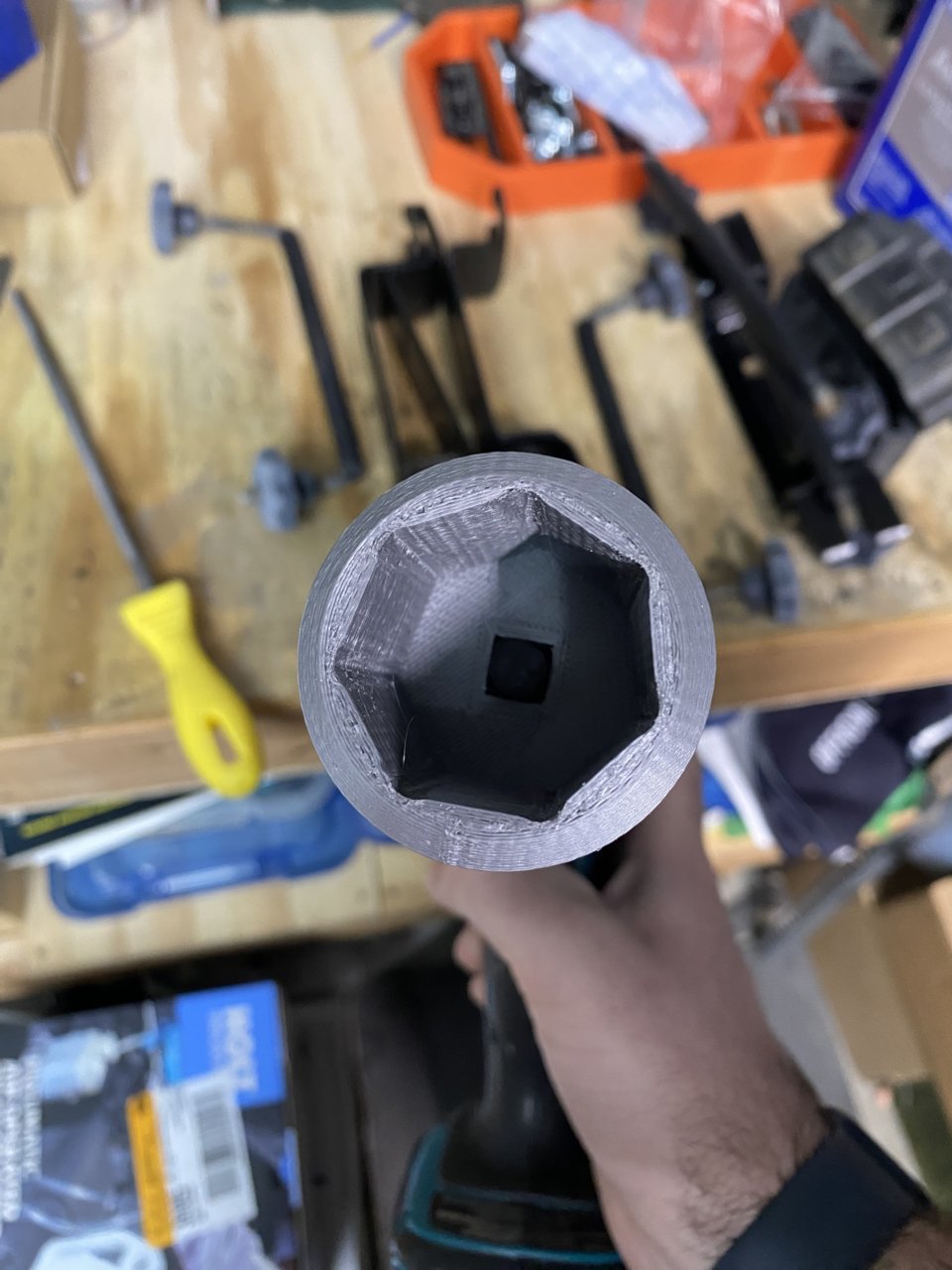

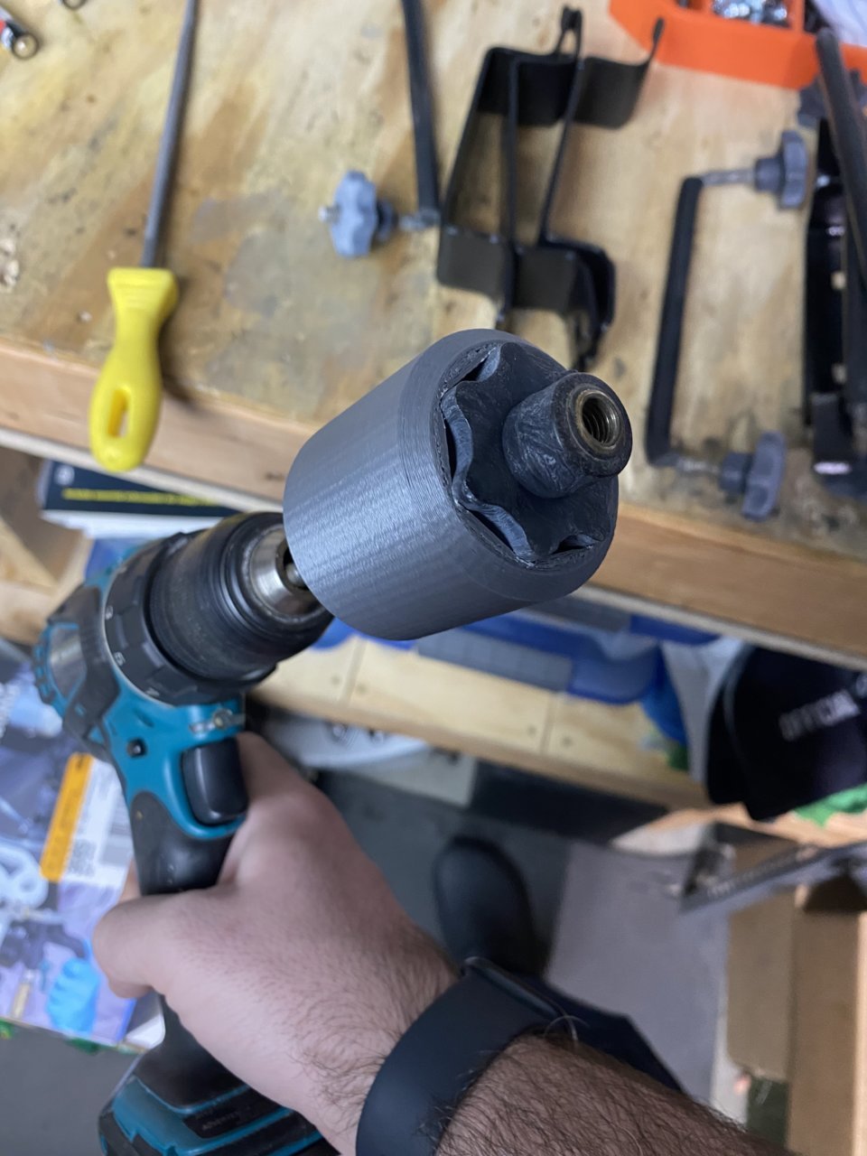

    Printed a socket for my roof basket mounting knobs. They're not tough to turn by any means, the posts are just long and annoying. The knobs are 7 sided, too, so a normal socket wouldn't fit over. Made it so I can chuck it onto a 1/4" hex to 3/8" socket adapter in the drill and go to town.

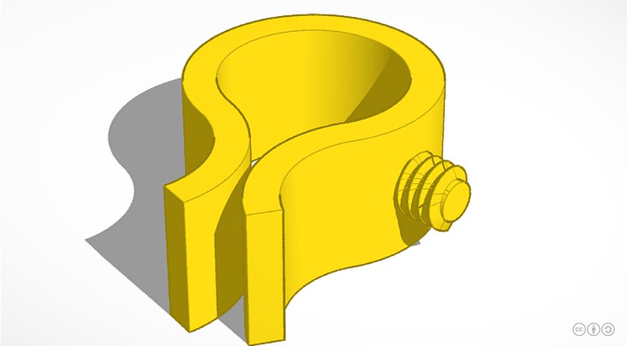

    the mount for my TPM on my motorcycle was too bulky so i just made an abs clip for it, works great.

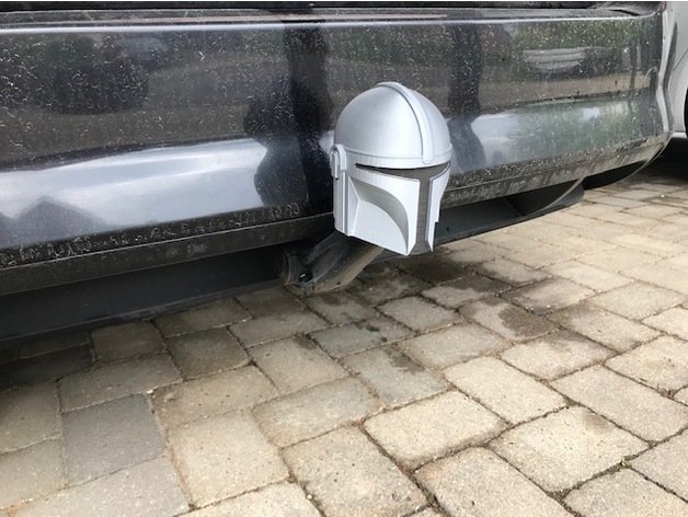

    looking to print a TPU trailer ball cover. any design ideas??

    printing this in blue TPU

    Make it a bobble head design too :rofl:

    that would be funny, but 1st print attempt failed, tpu got stuck in tube.

    Do you have a direct drive extruder? I didn't dare try TPU until I upgraded to one

    no, i dont. Im getting layer shifting a lot now so diagnosing that on a different job
