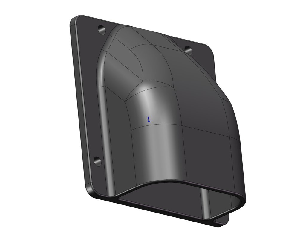

    At work we were having these louvers for our control boxes made from welded stainless sheet metal costing us about $225 each. By printing 4 of them we paid for our new Bambu X-1C printer (1-day ROI). We are using PETG-CF pretty successfully but there were a few growing pains.
