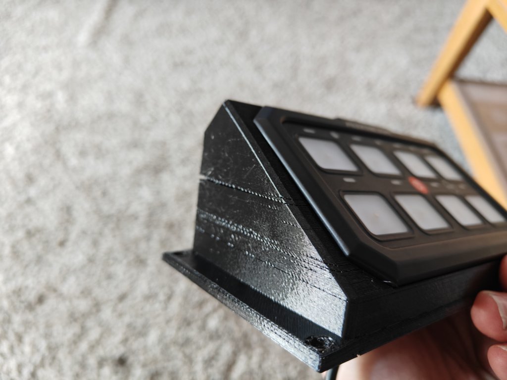

    This is what it did... You can see the pattern on the side was starting to get a little weird even before it cracked

    Yeah that's pretty extreme, you printing in an enclosure or open air?
    It looks like the layer didn't go down consistently in some areas. What slicer are you using btw?
  8. Oct 29, 2024 at 8:04 PM
    #828
    Speedytech7
    Feb 20, 2014
    #123587
    58,250
    FCQM+VG Cheney, Washington
    It's less Tacoma and more mod
    It's open air, and this was an overnight print. Maybe it got too cool since the house heat goes down to 64 overnight. I use the most recent Creality slicer (before it changed to Creality print )
  9. Oct 29, 2024 at 8:11 PM
    #829
    ITmaD
    ITmaD Well-Known Member
    Feb 19, 2023
    #418333
    461
    Atlanta
    Enclosure would help a lot, when I had a a few Creality CR-6 when I was prototyping my panels in the earlier days id get issues with warping and layer separation till I bought one of those black box enclosures for like $50 and it pretty much eliminated warping from there on with petg/asa.
    Also personally I think Creality slicer is kinda trash as someone who's used it when I had a K1 printer when it launched. Give Bambu Slicer a shot it's way more feature rich and the premade print profiles I find are more well tuned they even have the Enter 5 machine as a preset
  10. Oct 29, 2024 at 8:14 PM
    #830
    Speedytech7
    Feb 20, 2014
    #123587
    58,250
    The Old Creality slicer was extremely bad. It's changed a lot since the original version that ended use in like 2020. It's basically just straight cura now. I'll try the bambu one though. I have the prusa one too. I'll pick up some sort of enclosure though first
  11. Oct 29, 2024 at 8:19 PM
    #831
    ITmaD
    Feb 19, 2023
    #418333
    461
    Atlanta
    Slicers are free I'd start there, might even notice some more detail in other prints with pla, ect.
  12. Oct 30, 2024 at 5:14 AM
    #832
    Rock Lobster
    Rock Lobster Thread Derailer
    Dec 14, 2018
    #275833
    13,460
    Dee Eff Dub
    I drive a Miata.
    I've had that happen.
    For me it was intermittent underextrusion from nozzle clogging up. I never could figure out if it was variances in filament or if it was variances in temperature that was causing it.

    Have you tried printing a benchy to see how that turns out? What temp are you printing at?
    Pixeltim likes this.
  14. Oct 30, 2024 at 6:43 AM
    #834
    Speedytech7
    Feb 20, 2014
    #123587
    58,250
    I was running it at 235C, previously had made some other things from this same roll of PETG that were great, including another one of this exact item
  15. Oct 30, 2024 at 6:44 AM
    #835
    Revelations
    Revelations Well-Known Member
    Apr 17, 2014
    #127895
    1,125
    2014 MGM DCSB
    What's the temp range of the filament you're using?
  16. Oct 30, 2024 at 6:46 AM
    #836
    Speedytech7
    Feb 20, 2014
    #123587
    58,250
    CR-PETG from creality, altered the presets for it because they weren't right from the defaults in the slicer. I think it is 230-260 temp range and the slicer wanted to run it too fast and at 220*
    Revelations[QUOTED] likes this.
  17. Oct 30, 2024 at 7:14 AM
    #837
    infantry317
    infantry317 Well-Known Member
    Aug 15, 2019
    #302280
    149
    Minnesota
    2019 Tacoma TRD OR
    None yet
    Our Bambu prints PETG at 255c default enclosed.

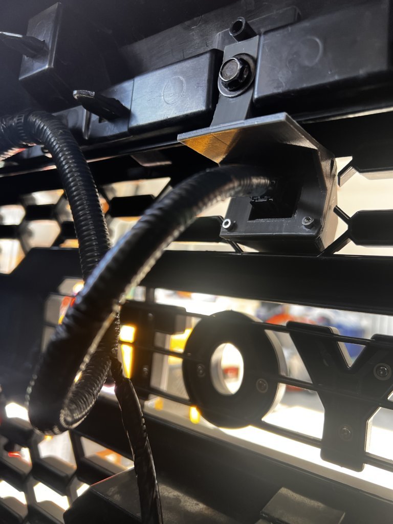

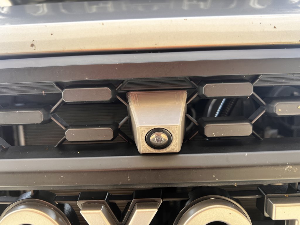

    I’m on my 6th prototype…
    oldgreg, ERod27, ITmaD and 1 other person like this.
  19. Oct 30, 2024 at 10:09 AM
    #839
    ITmaD
    Feb 19, 2023
    #418333
    461
    Atlanta
    Make it hot pink! lol
    I wanted to do the same thing when I got a front cam but I ended up drilling into the under side of the letters and printing out a tall spacer to get the camera mounted.

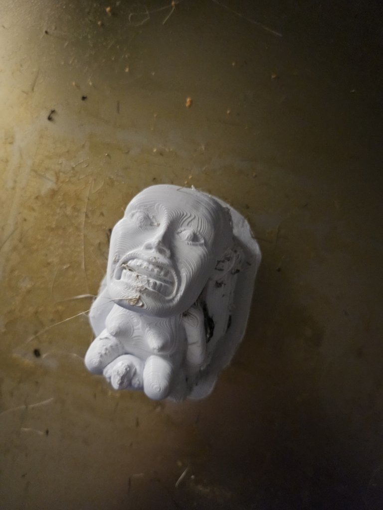

    916
    accessory for my costume..
