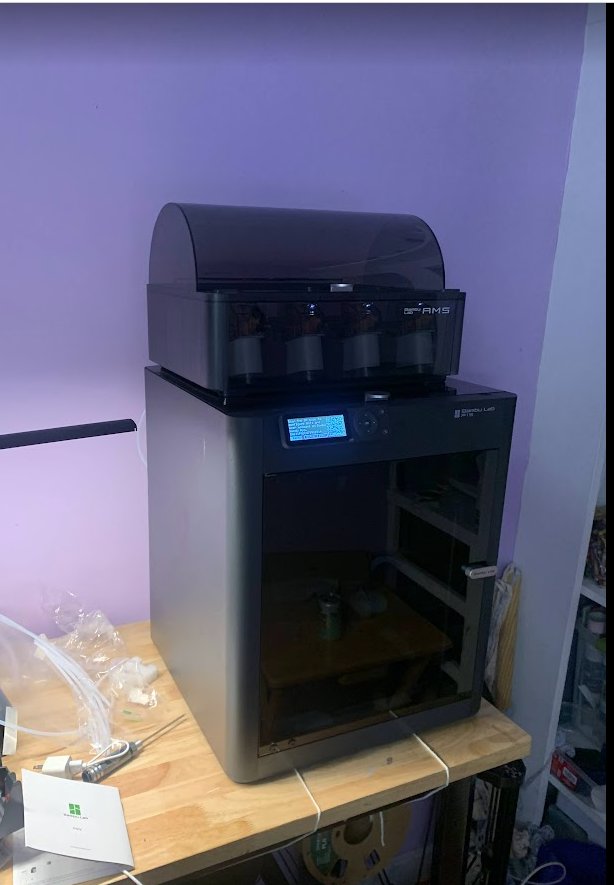

    Picked up a P1S with AMS, amazed by the print quality out of the box with no tuning

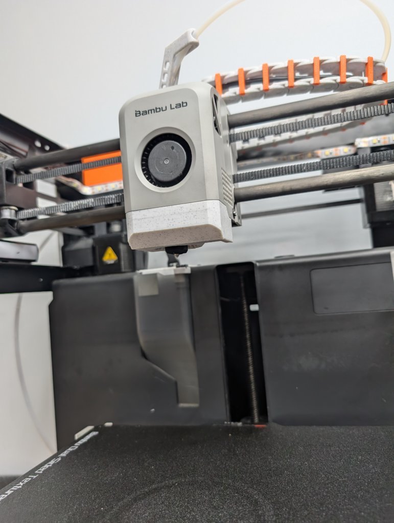

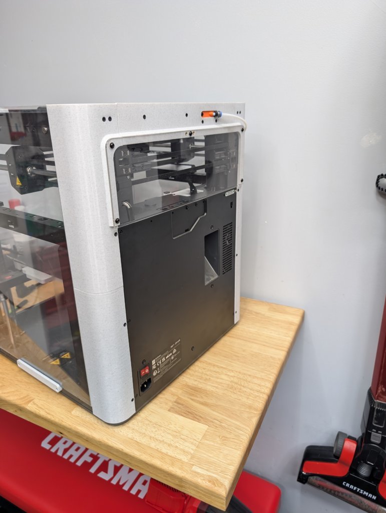

    So this is the P1P I got for super cheap, I put some work into into it over the weekend cleaning it up and giving it a new look with an enclosure.
    Used a white marble PETG filament to print out the frame for the acrylic panels, printed a cable chain from it too with some orange PETG accents, printed a new fan shroud for the parts fan that's more effective then the stock one, a filament guide tube, also swapped out the nozzle to a hardened steel with a spare I had laying around.
    Enclosure called "Vision" can be found here: https://makerworld.com/en/models/18576?from=search#profileId-71771

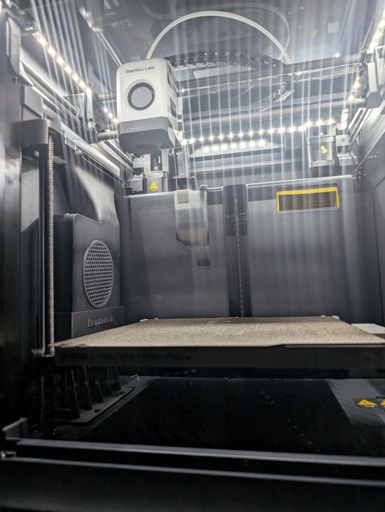

    Highly recommend getting some aftermarket lighting for the chamber along with the fan flow duct + nozzle wiper. Super easy installs and make a big quality off life difference while using the printer!

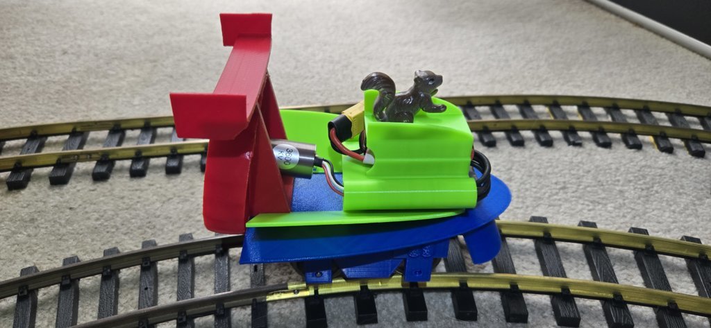

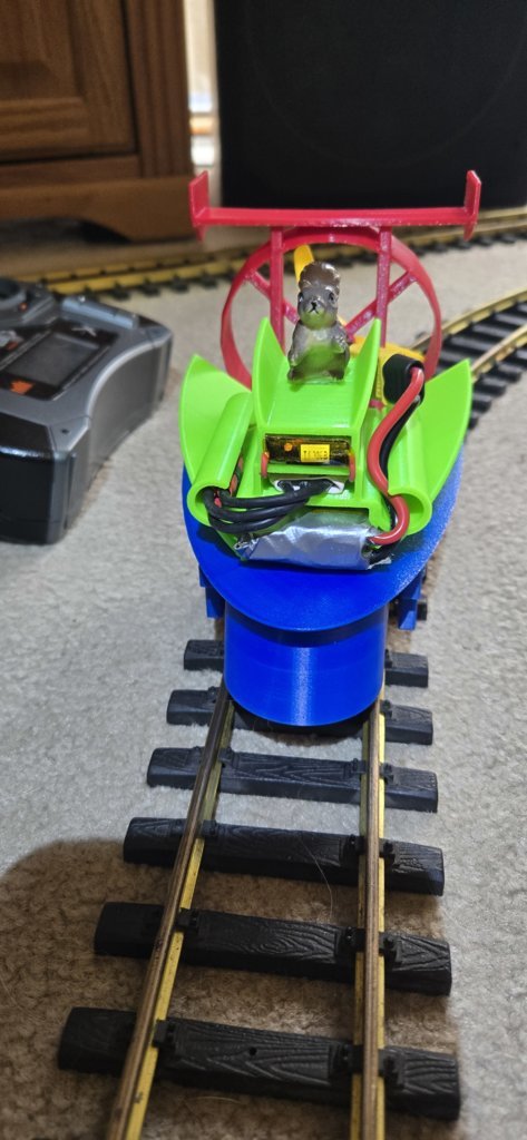

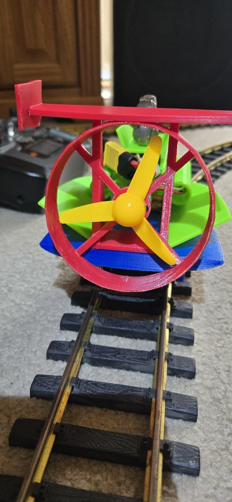

    Made a copy of LGB's lineup of fan powered "Flyer's" for G scale track.
    It's powered with a 3600kv brushless in-runner on 2s pack.
    This was the prototype test before I went all in.

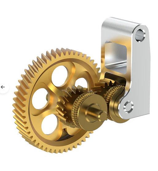

    Did some more updating over the week, I took out the steel/plastic extruder gears are replaced them both with the brass and aluminum BIQU Panda Claw extruder gears since I've seen rusty dust in the gears on the non coated factory gears cause issues for people with feeding before and I updated to the CryoGrip Pro Glacier plate on the P1S purely because I liked the pop of color the blue plate has lol. We'll see if it holds up and performs well also too kthe updated PEI plate from the P1S and put it in the baby P1S I fixed up.

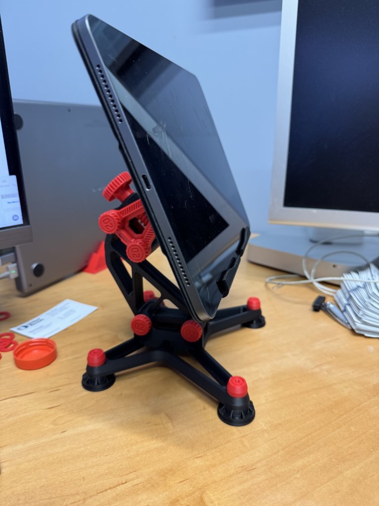

    iPad stand!
    Two of my co-workers saw it and the each want at least one!
