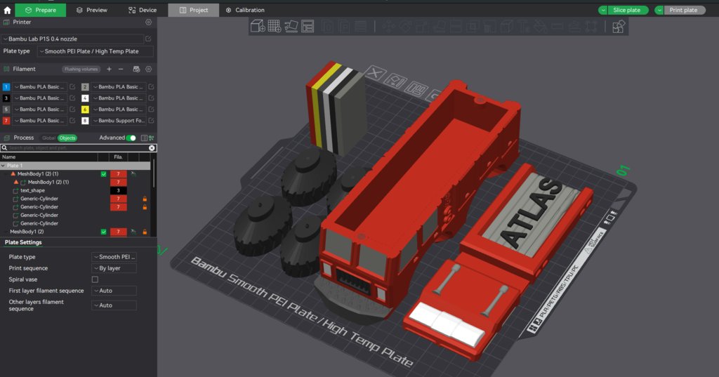

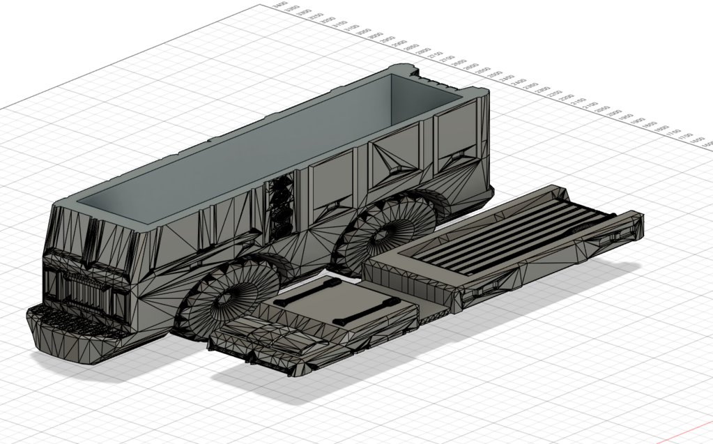

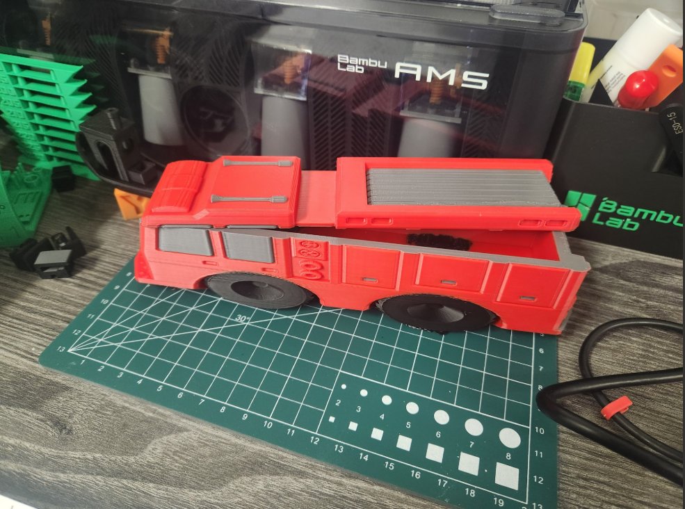

    Depends on what you want to do. I'm learning fusion, but find that most of what I want to do doesn't need it. I take basic 3D models and manipulate them in the Bambu Studio slicer. For example, I'm trying to make my nephew a pencil box that looks like a fire truck (nephew is 5 and likes fire trucks and drawing).
    I took a readily available 3d model, removed the top and hollowed it out in fusion...
    I printed the initial prototype, but the Bambu Studio (slicer that comes with the P1S) compressed the wheels into the body and it came out weird...
    I added some text, painted panels (windows, handles etc) with different colored filaments and a couple of slots so that I can glue magnets in. I even split the wheel sections and the slicer software can cut objects and add connectors so that parts can snap together for assembly. Pay attention to what is printing on the face of the bed and what isn't. I'm using a smooth plate here to help the pieces fit together better. Bambu studio is much more intuitive for me, but fusion is has an astounding amount of functionality. Learning curve for both the slicer and fusion are pretty steep in the beginning...

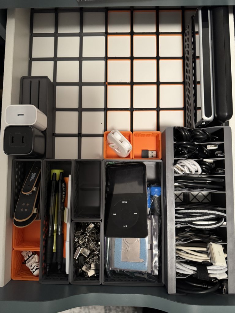

    One plate of bins later..

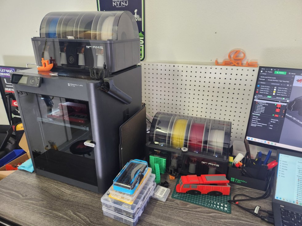

    For me, it seemed like a pretty good deal to add the AMS as the combo. P1S by itself was $599 and with the AMS as a combo it was $799. The AMS alone is $349 from Bambu. I liked the AMS so much that I added another...
    That said, enjoy the printer. Like many others have pointed out, you'll be printing near perfect models within 30 minutes of unboxing. Pretty badass machine for the price.

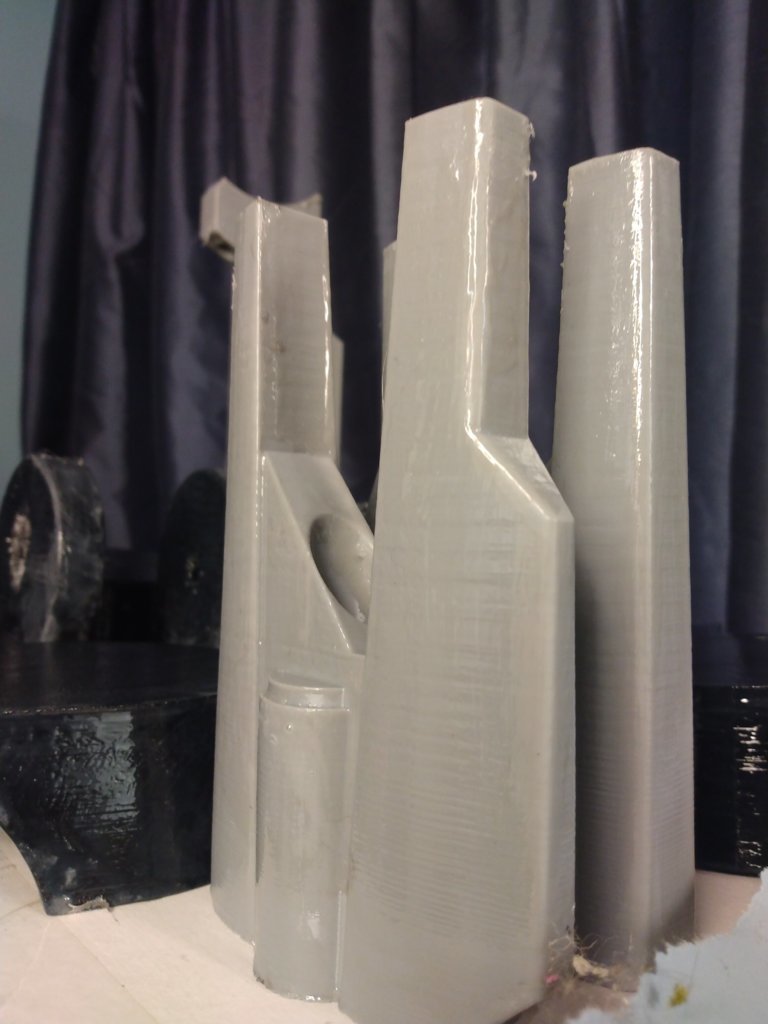

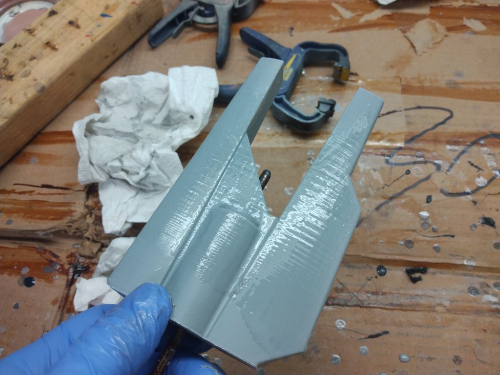

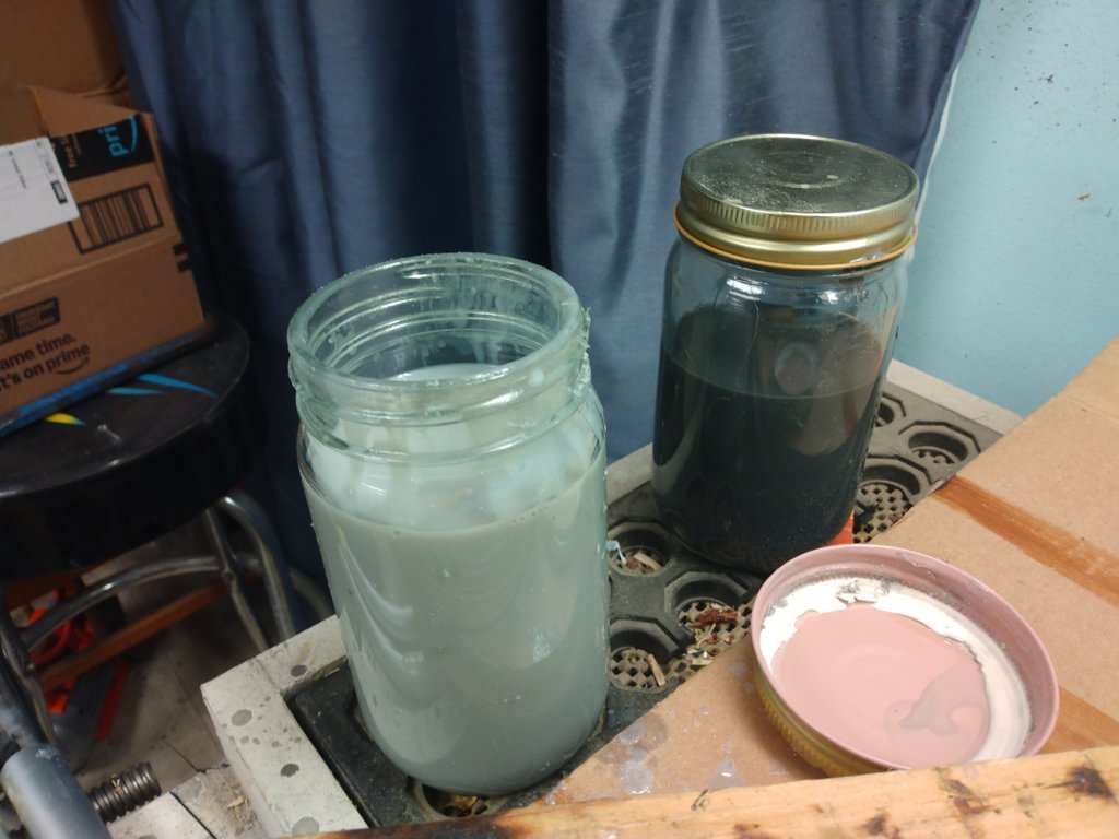

    Got back to work on the 1:1 scale life size B1 droid.......

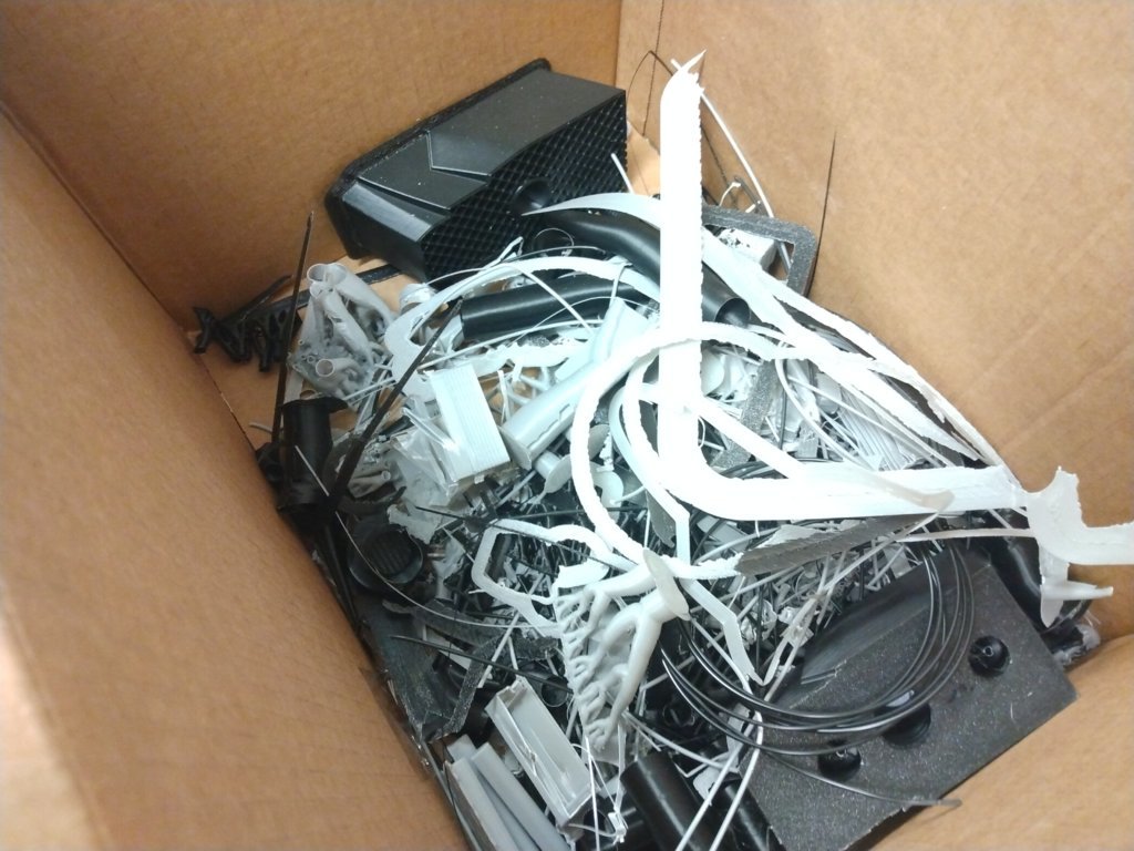

    Since I now have all of the 100+ parts printed out in ABS, I have now entered the first stage of applying the ABS "goop". Its effectively varying amounts of ABS off-cuts, supports and reject parts combined with acetone.
    The light gray jar is a thin-ish mixture of gray supports and acetone and is about the consistency of thick house paint, and I use a thin layer of that one for all of the overall parts. The dark gray jar is mix of black supports, but a much higher ratio of ABS to acetone, as it has the consistency of very thick honey and is great for filling major goofs, or layer line shifting.
    All ABS gets recycled back into the most effective glue you can use to glue ABS parts together, as well as a smoothing agent to help sanding:
    Once dry, this means you are effectively sanding on that layer instead of sanding through your 3D print, as well as the main purpose of filling nearly all the print layers on the 1st go-round.
    Once brushed on, it almost immediately starts to melt into the surface and make the print lines much less sharp, and prepped for sanding:
    Here we see a lot of the wrist/hand and upper arm parts being coated. Once these are dry, Ill take them upstairs and start the 1st stage of the sanding process, then take the next box of parts down to be coated:
    onward and upward, as there is still a TON of work left on my droid.

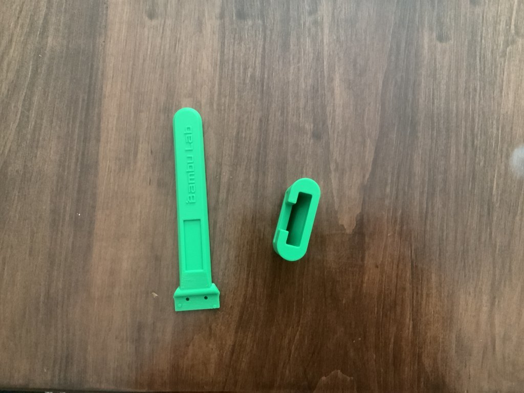

    Obligatory photo of my first print. Second was a benchy.
