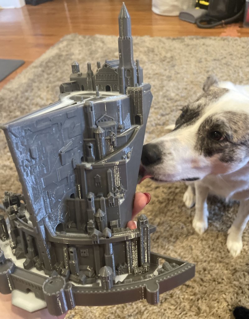

    Minas Tirith with SUNLU elite gray. Very brittle, filament broke over 100 times in one spool. Only able to use about 1/2the spool.

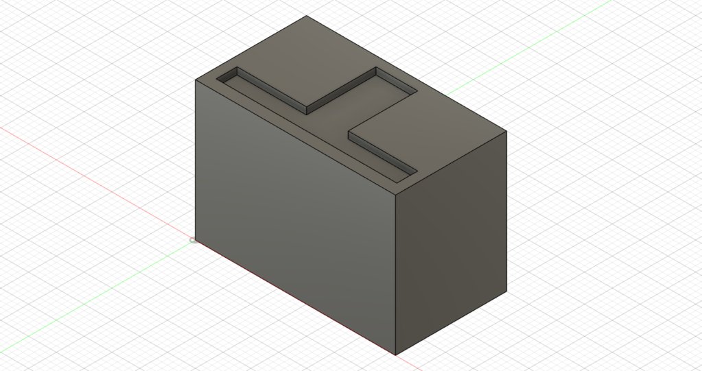

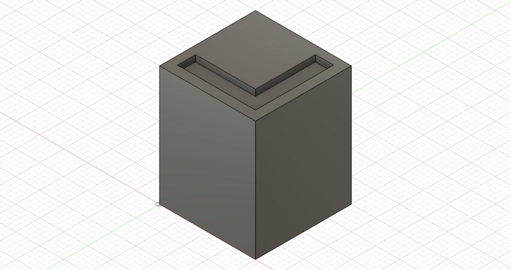

    Bought a shelving unit to be my 'permanent' work station, or as @Pixeltim calls it: My future printer farm. Not sure I'm going to be happy with a 36" height permanently, that's what my temporary setup is. So, into Fusion I went and shortly later, I'm printing these. The 'L' shaped one is for the perimeter legs, the other will support the center 4 legs, where the two halves come together. We'll try 2 1/2" rise to see how that works out, adjustments can easily be made.

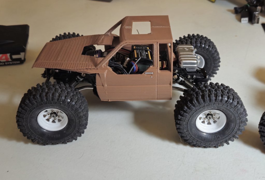

    Going to try some PETG-CF for a print this week. It'll be here tomorrow along with some hardened steel tips.
    Any tips or suggestions to increase my success?
    Printer is open air and most likely will be in the heated garage for this endeavor.

    You may have trouble with open air? Change your support attachment (base and part) to 1 layer or they are hard to break off in my experience.

    This is my main concern as the print is 90% supported and I prefer to use the grid supports on this one. So that makes it even more challenging.
    Thanks for the advice, gives me somewhere to start.
    I have made a few out of regular PETG that turned out decent, just looking to try this and see what happens.
    It's just a small RC car body, and I am prepared to use the entire roll, experimenting until it works out. :) Buying one (not available anyway) is more than a roll of filament.

    This little guy. It started out at 45 grams, now down to 28 grams, which is fine for weight.
    I've read the CF makes a cleaner print as well as stronger. Hoping it maintains it's weight.

    It does usually, you got a link to the files for the model? A lot of times print orientation will save you material and time.
