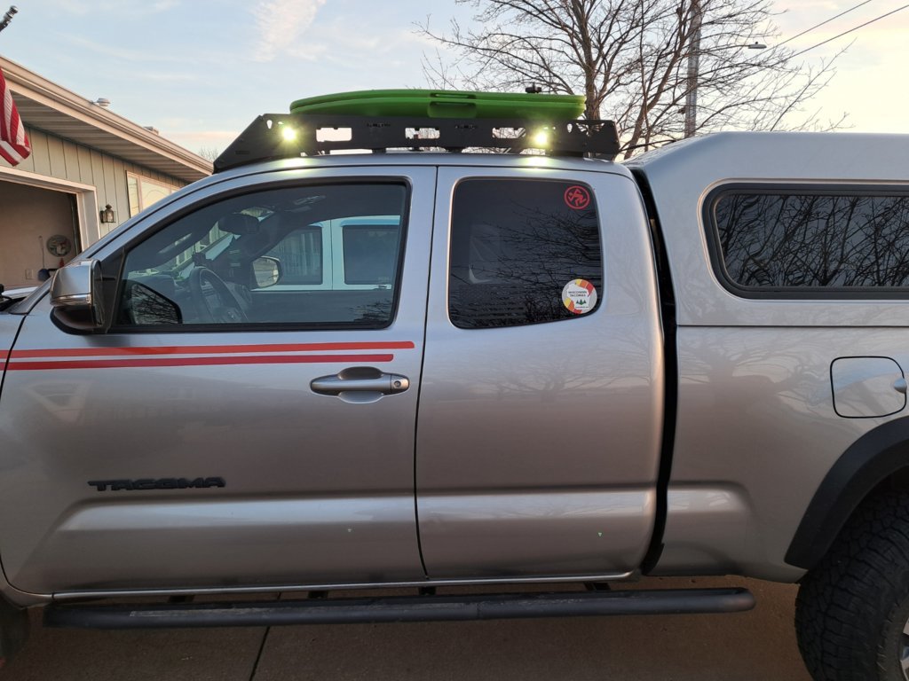

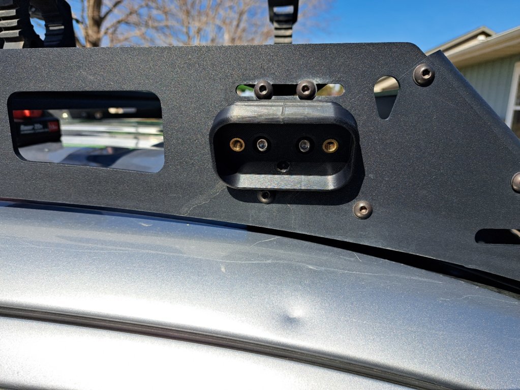

    Printed these a while back, finally got them mounted:
    Printed with ASA for better durability.

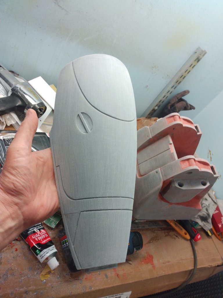

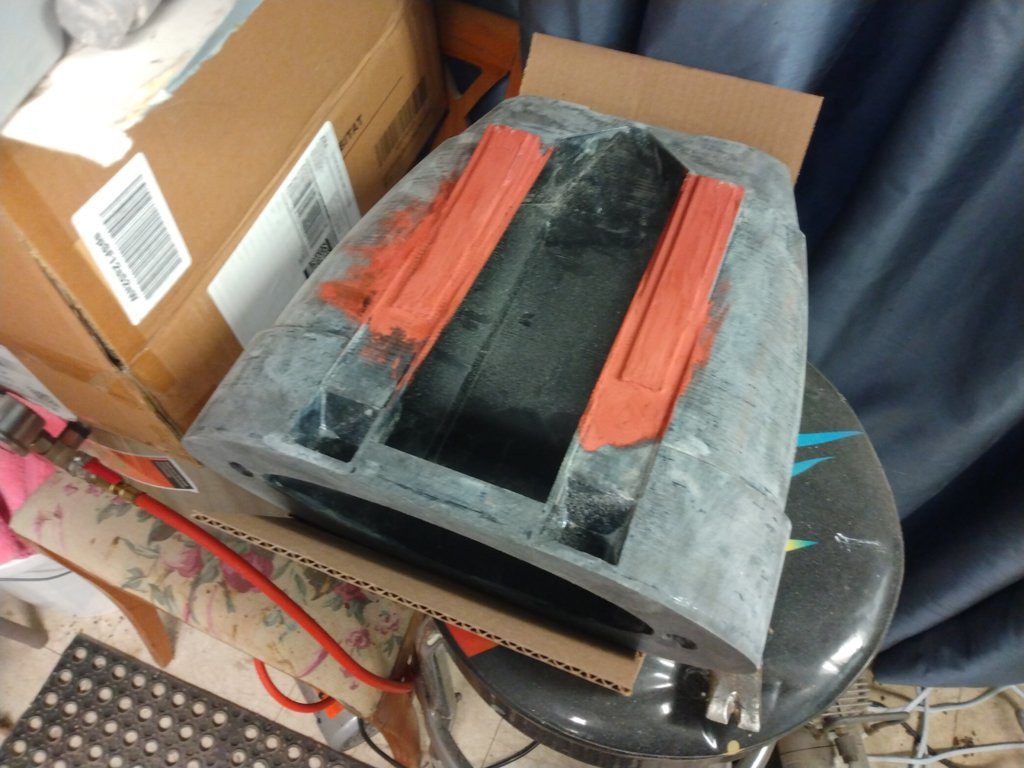

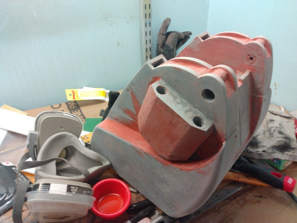

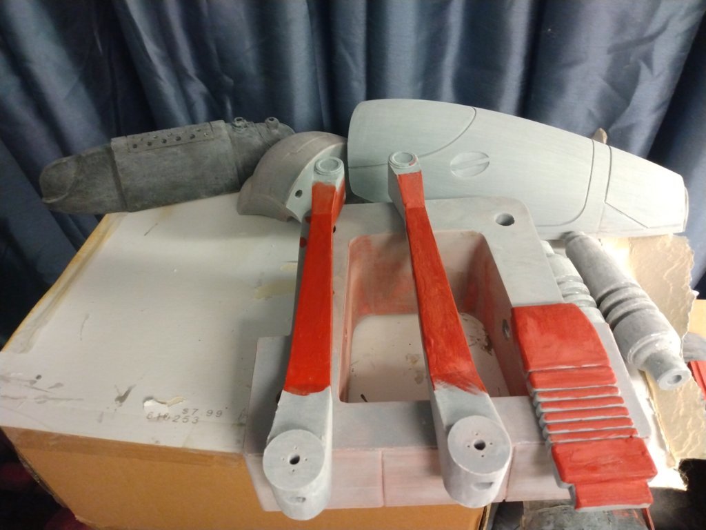

    Progress on my full size 1:1 scale B1 Battle Droid continues......
    Keeping the 90/10 work rule about paint in mind is hard.......post processing is a killer!
    The chest piece is the single largest part in the droid, and is huge, with a ton of crevices and hard to reach areas.
    The head turned out great with minimal filling and sanding. Using some acetone and ABS for smoothing, and then some spot putty for final filling.
    Next up it will some rounds of spray filler primer.......

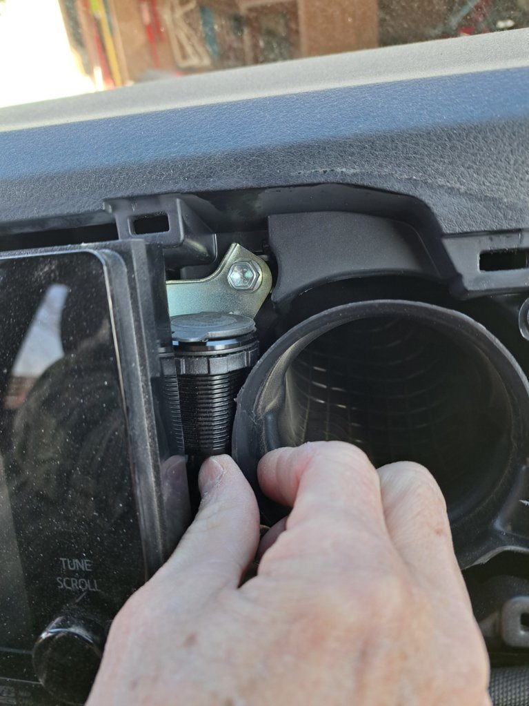

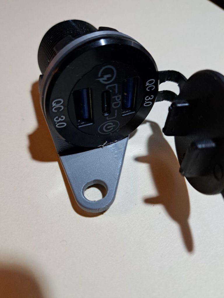

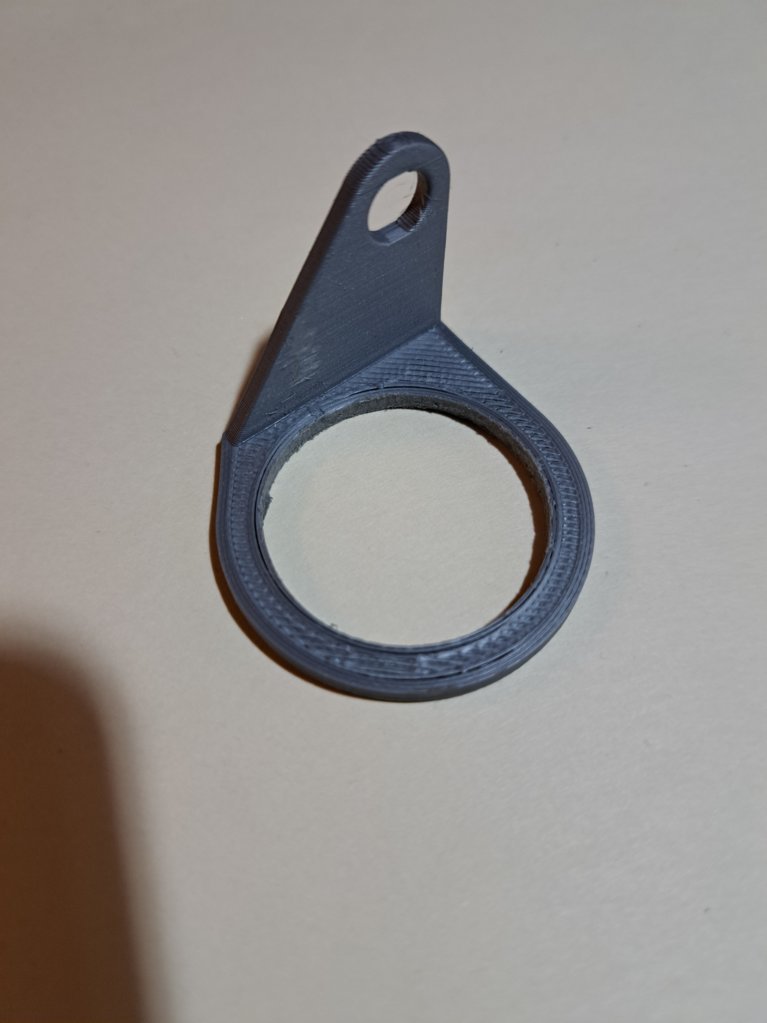

    Quick little design/print project this evening:
    It goes here:
    Hidden USB power for the things I have on my DMM. The Taco Garage wants $35 for a stamped metal bracket w/USB port. The USB cost me something like $6. Still have to source power for it, but that's minor. I'll probably pull it from the unused Qi charger.

    Thats what I did. I had the USB powered on when I pressed the Qi button. I wish I could remember what wires I used from the Qi, it wasn't as straight forward as I was expecting.

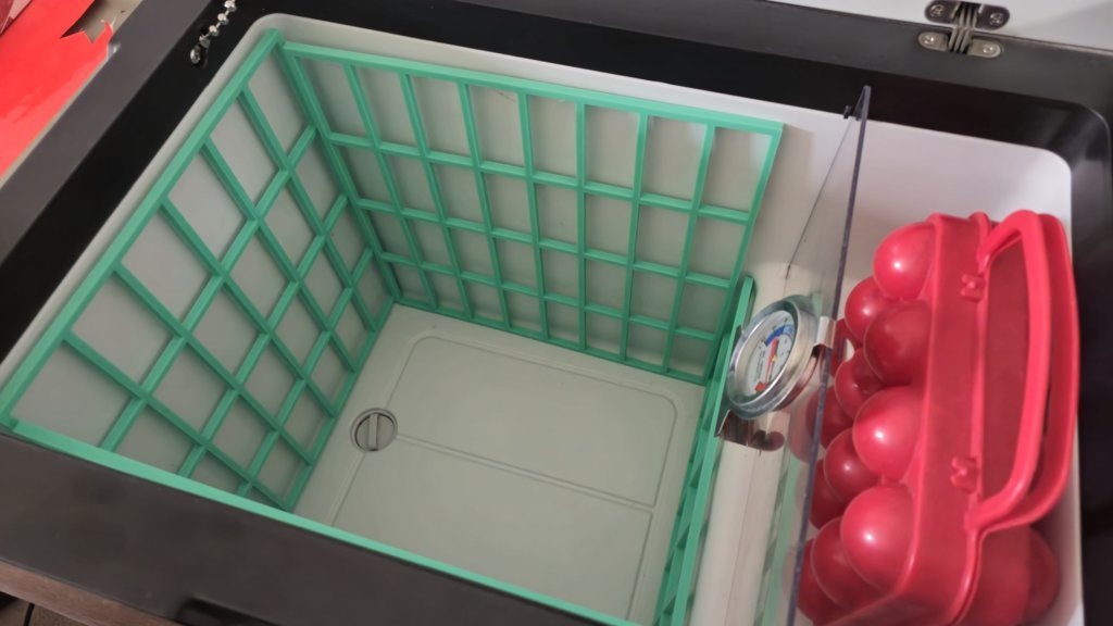

    Spacer grids for the portable fridge to get some airflow along the sides. I learned thru trial and error that a pack of brats against the side where the t-stat is will cause it to not cool efficiently. :D
