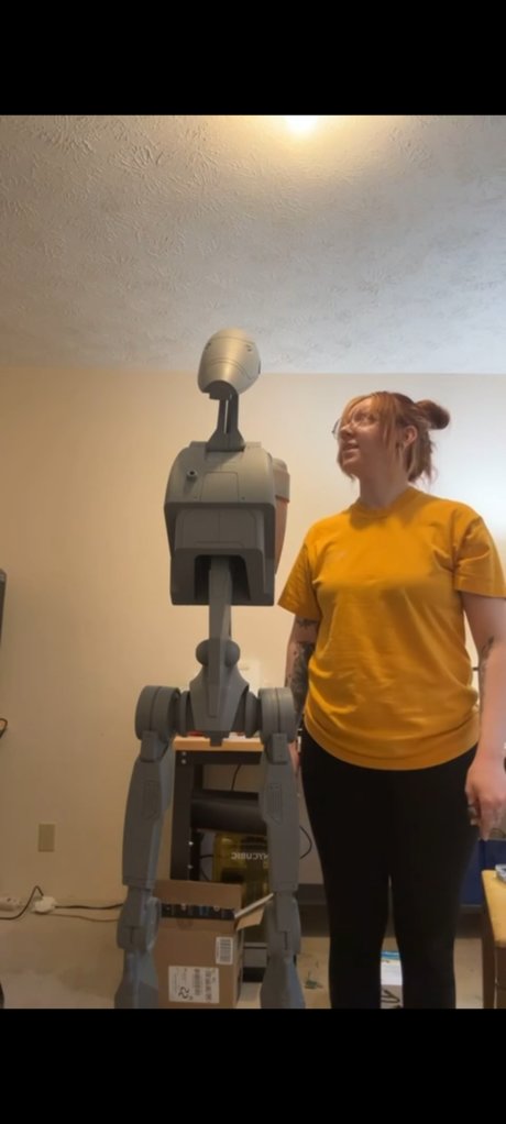

    He's a lot taller than you might expect....
    Here is Scout with my 5'8" daughter;

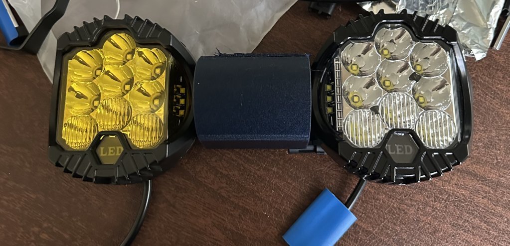

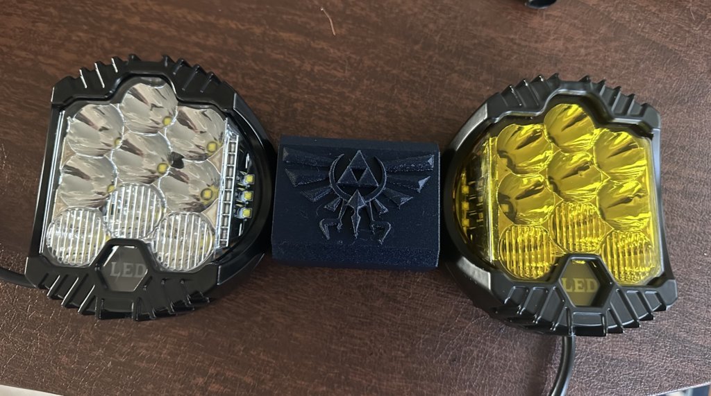

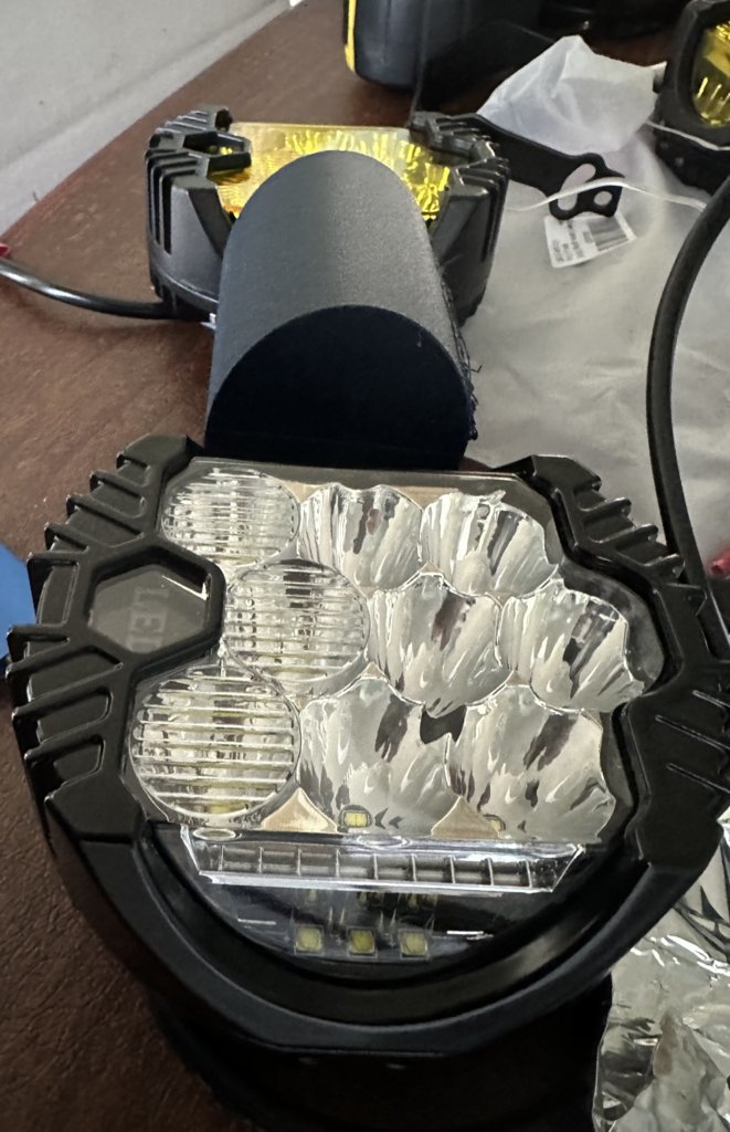

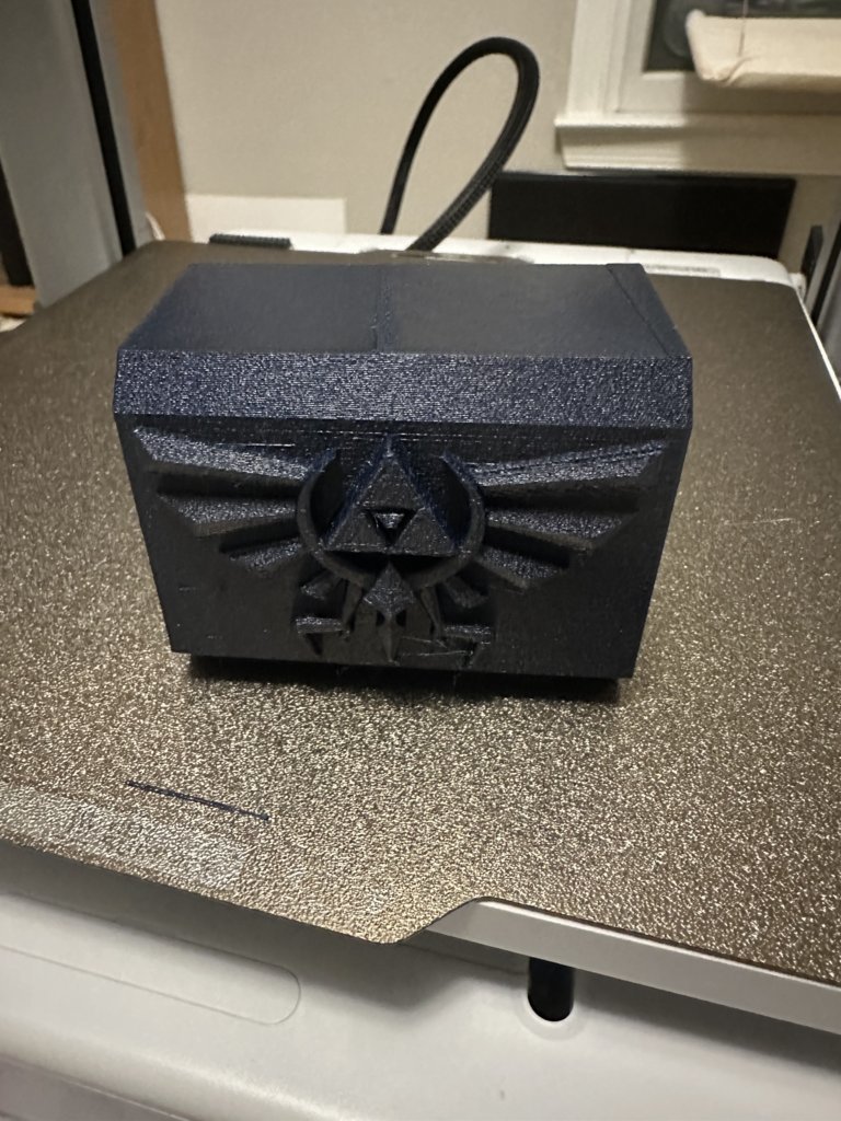

    Made a spacer block for new led light pods for the Prinsu rack. Found a model Hyrule crest to add for a finishing touch. Prototype of that one turned out well, will just have to check it tomorrow.
    First two prototypes were not quite right. First had a rounded front but looked funny. Second was a block but needed a few edits. Third should be good enough. After the test fit tomorrow, I’ll print the 4 others I need.

    It fit pretty well, just made a tiny change to the hole size and have the other 4 printing now.

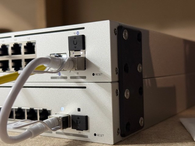

    I haven’t printed much of anything lately but recent events have prompted me to revamp the networking in my house so I printed some brackets to keep my new equipment aligned until I decide on a rackmount solution.

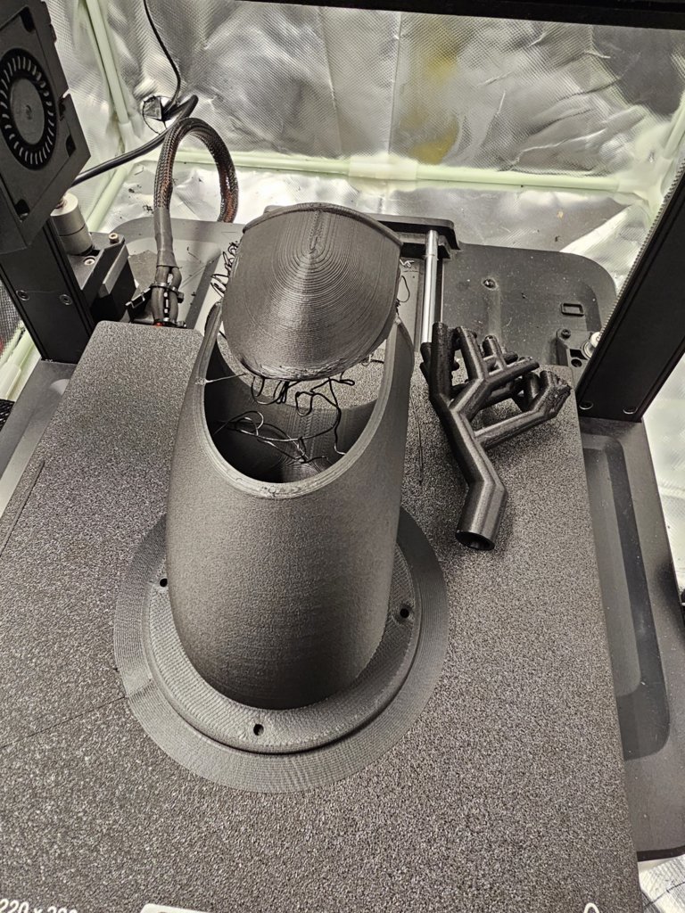

    Been working on diesel heater ports for my trailer. Started a print last night for an elbow... once again my tree supports were knocked loose by the nozzle. This has been an ongoing issue with tree supports.
    Positive note, it appears I dont NEED supports since the top still printed without anything supporting it, its just in the wrong spot lol
    I think I can salvage this print though. I should be able to glue the top into the correct place. Its just for attaching a flexible vent hose.

    I have switched to grid supports, 3mm spacing, no sheath, and no longer worry about the tree supports getting knocked off. The trees tend to collect a "drip" after the nozzle makes a pass and this builds up, then the tip knocks them over. Using retract does help with the trees, but after having wasted the equivalent of a few rolls of filament over the last year, I try to not use the trees anymore.

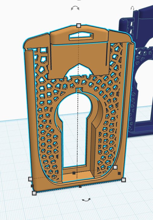

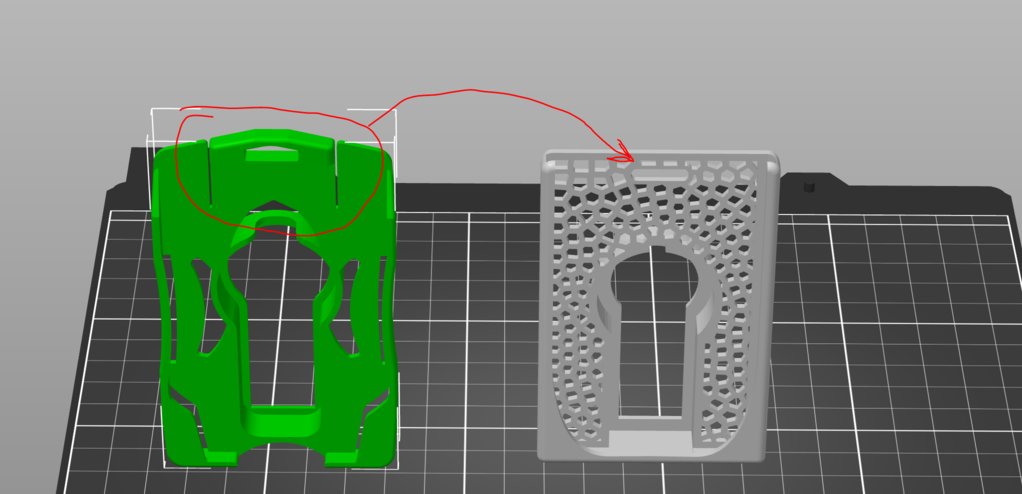

    Here is my dirty attempt: https://www.tinkercad.com/things/k6XFPGV7K5T/edit?returnTo=/dashboard&sharecode=pmOxNwkyco4WiAQ9TQAhMlpR3zkkzxvU8Mbh9AL0hLY
    Bless Tinkercad.

    I'm already using a decent amount of retract. Also set it to avoid supports when traversing and only move withing the print when possible to limit stringing.
    I have been using zigzag supports lately because they seem to be the easiest to remove while still providing good support. Only reason I went with tree this time around was it wanted to fill the tube with zigzags.

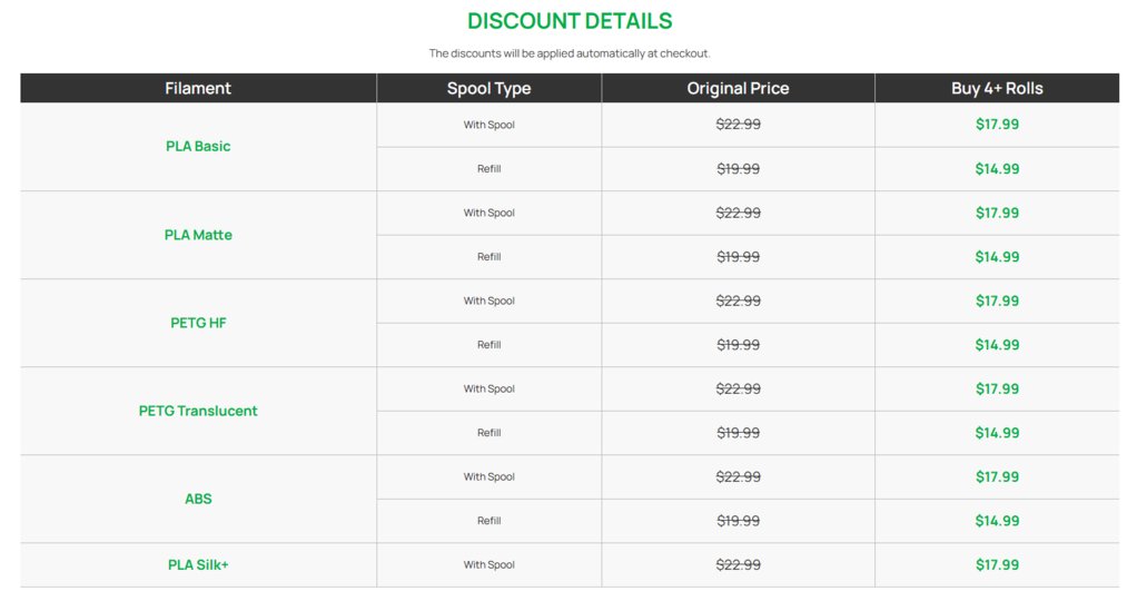

    Those of y'all with Bambu Lab printers, they have a filament sale going on, 4+ roll refills are $14.99, with spool 17.99
