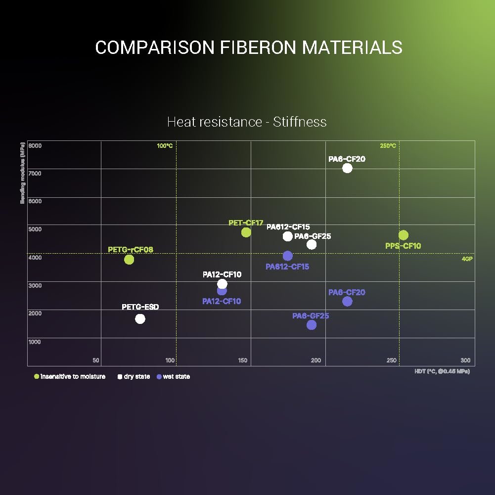

    Question for you experts.
    I've been throwing around some designs for a 3D printable intake plenum and manifold. Think a 3-4 piece design that bolts into the factory intake manifold of a 5VZ-FE.
    Temperature-wise, I'm not sure if I 100% need to make the entire thing out of PA6-GF, or if I can get away with PET-CF at half the price. Any of my designs will seemingly take around 2kg of filament, so PET-CF would be the price point closer to reality. Do I risk it? Or do I just make sure the areas contacting metal are PA6 and let anything with radiant heat be PET?
    Keep in mind the inside will be constantly flowing air that's gone through an intercooler, so the inside will be under 150*F, but the outside will likely see above radiator temps in some locations (230*F/110*C). PET-CF is supposedly good above 140C and PA6-GF above 180C. Mainly I'm worried about hot spots I can't predict.

    My spool of ABS-GF was $26 (1kg). It's relatively cheap and will have better warp resistance than PETG. It's only downside is that it's also going to be the least flexible of the filaments.

    PETG and even ABS/ASA heat deflection temps are too weak to be considered here. This is PET

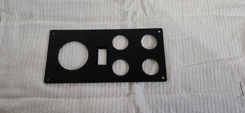

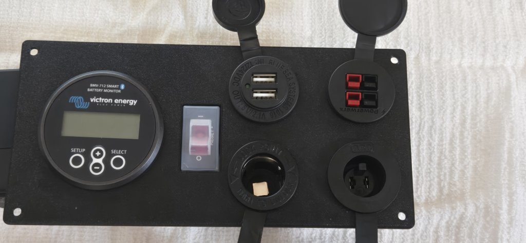

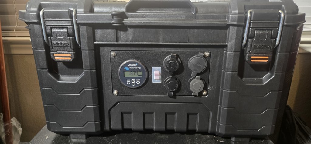

    Picked up another QIDI Q1 Pro, the first one died a terrible death, due to circumstances. Later i picked up a replacement an after some careful tunning got it to print decent.
    one of the first things I did was design a switch blank panel for the front of a Rigid toolbox, that will house the new portable battery system.
    After several iterations, the above was the final design...

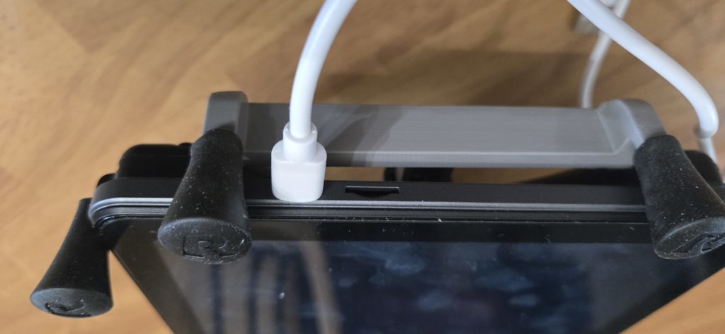

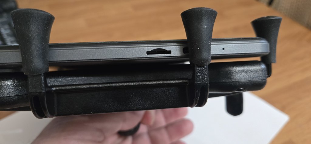

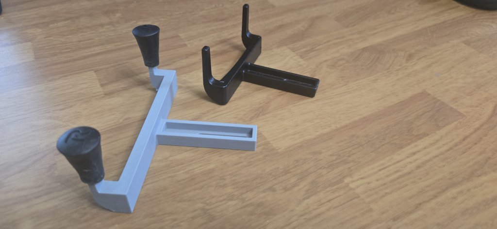

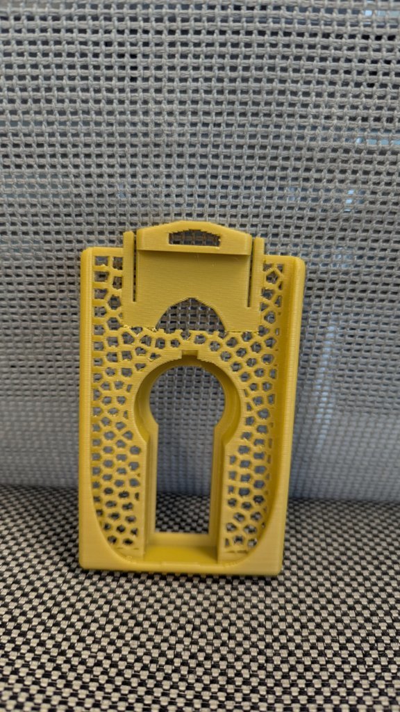

    I also decided to pick up a new 10" android tablet for offroad navigation use. which also meant buying a new mount. I am big fan of the Ram X-grip. I went with the RAM-B-101-C-U9U an quickly discovered that the end arms that come with it block the Charge port.
    I ended up staying up late and modeled up a replacement.
    the long tabs where the rubber bumper is, is a bit fragile but I think that will be resolved with a different print orientation.
    But it does the solve the issue it was meant to...

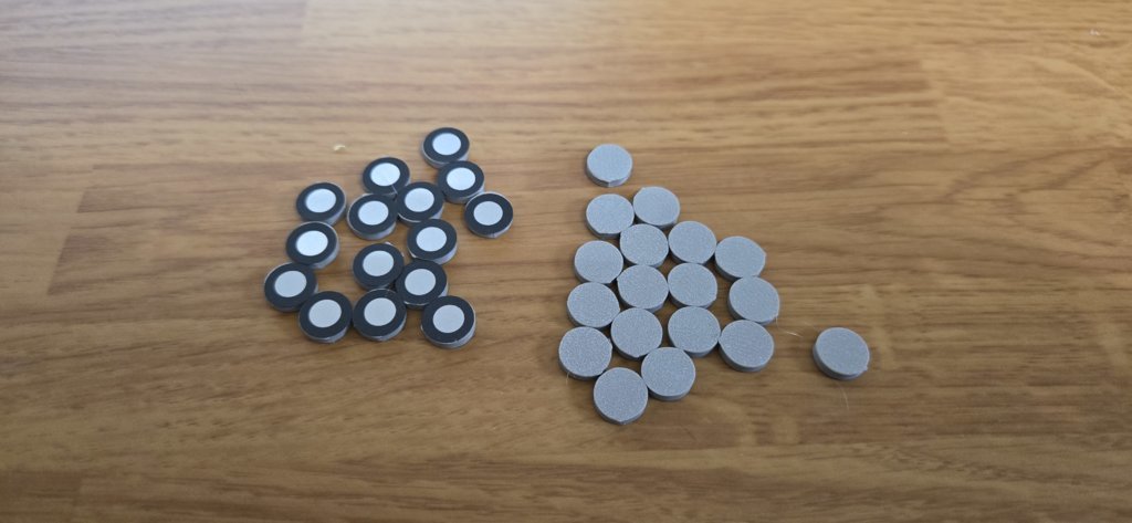

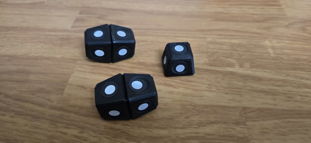

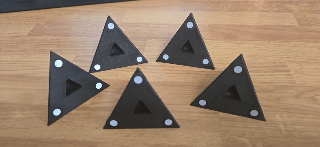

    the most recent prints are some 3d Scanner marker blocks. I just ordered the revopoint metroX 3d Scanner, and I was not about to pay over $200 for a hand full of scanner blocks. A quick search on printables and found I was not the only one.

    As a self-reply, I just stumbled on this thing made of Delrin, which has a heat deflection temp of only 120*C. So based on that, PET-CF would easily be good enough
