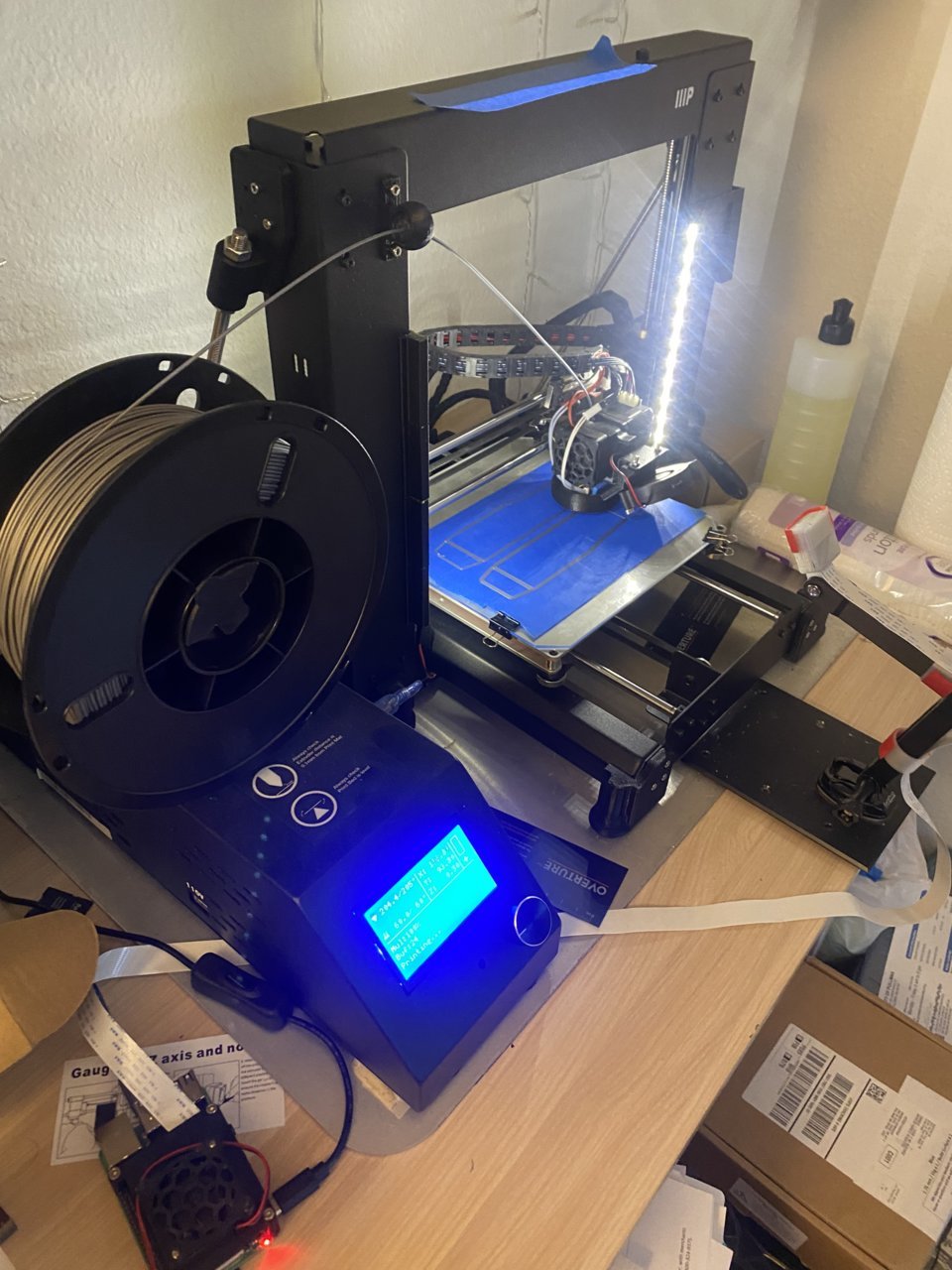

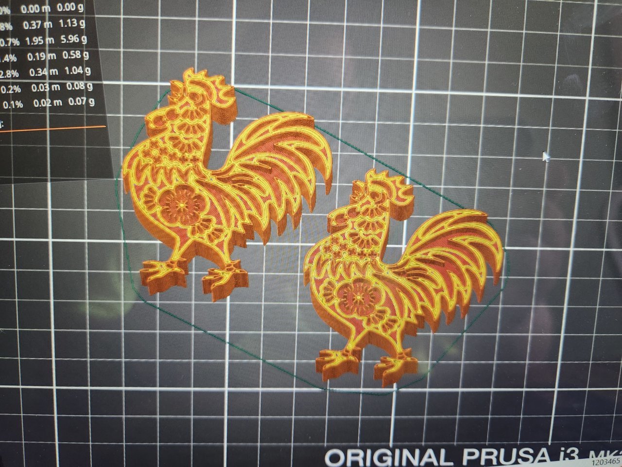

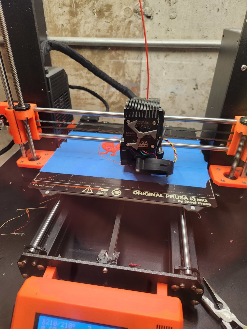

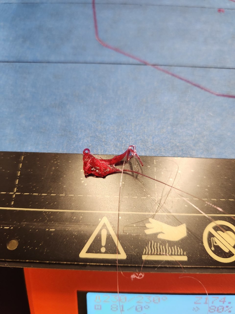

    Trying to print these today out of Taulman T-Glass as a father day present for some relatives. Third time trying to get it to adhere well. 1st ended in a glob and smearing or something like that. 2nd it wouldn't stay on and made this huge glob on the nozzle. Good thing I have a silicone hot end sleeve to keep it clean. Gonna try slowing it down a bit, raising it a bit and turning the temp down a bit...

    Said screw it and changed to PLA. It was over extruding so I turned down the flow rate and slowed it down for the first few layers so it got a few good layers...

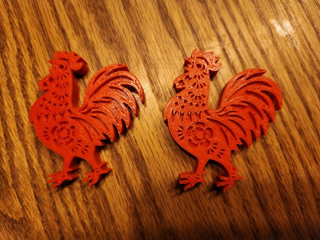

    Done! Little sanding and string removal and they'll be ready to be given as gifts!

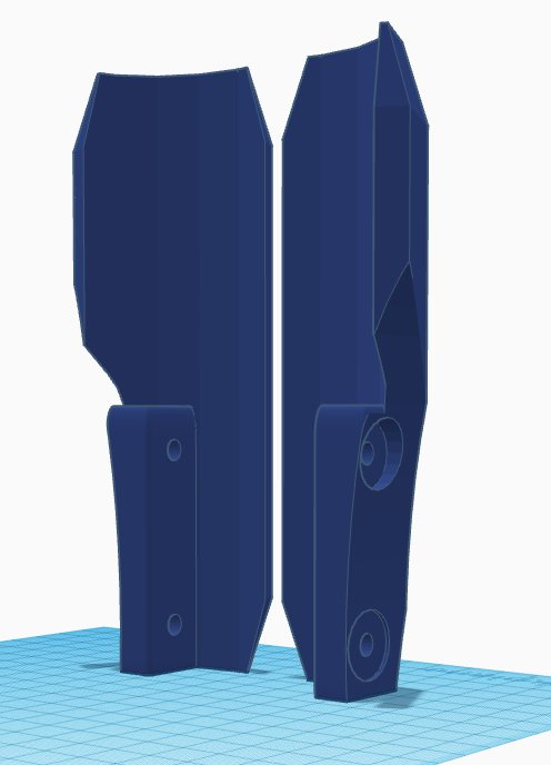

    Amazing what you can do in tinkercad.
    Trying to print a set of fork guards for my Grom, we'll see how it turns out in about 7 hours.

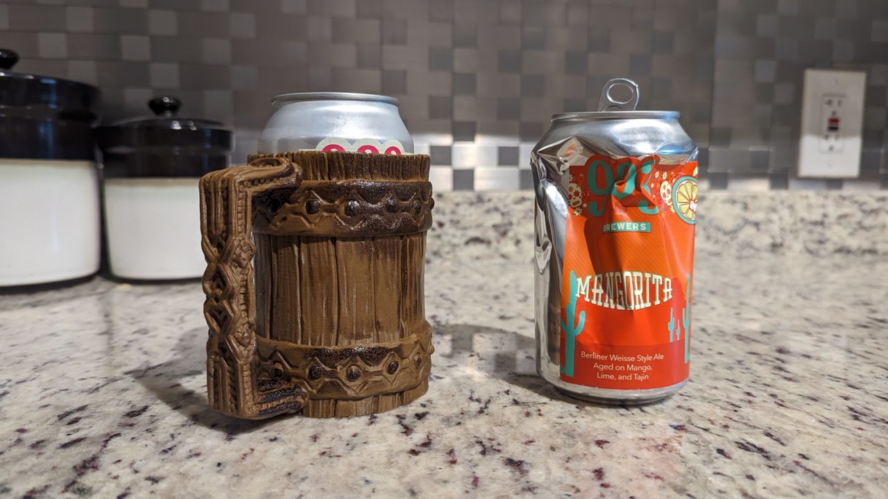

    Good idea: torching wood PLA can produce really interesting char effects, just like real wood.
    Bad idea: I shrinkidinked my can coozie around my can, resulting in 90 minutes of reworking the damn thing in the oven.
    But hey, I'm happy with the nerdiest can coozie ever. I might do another.

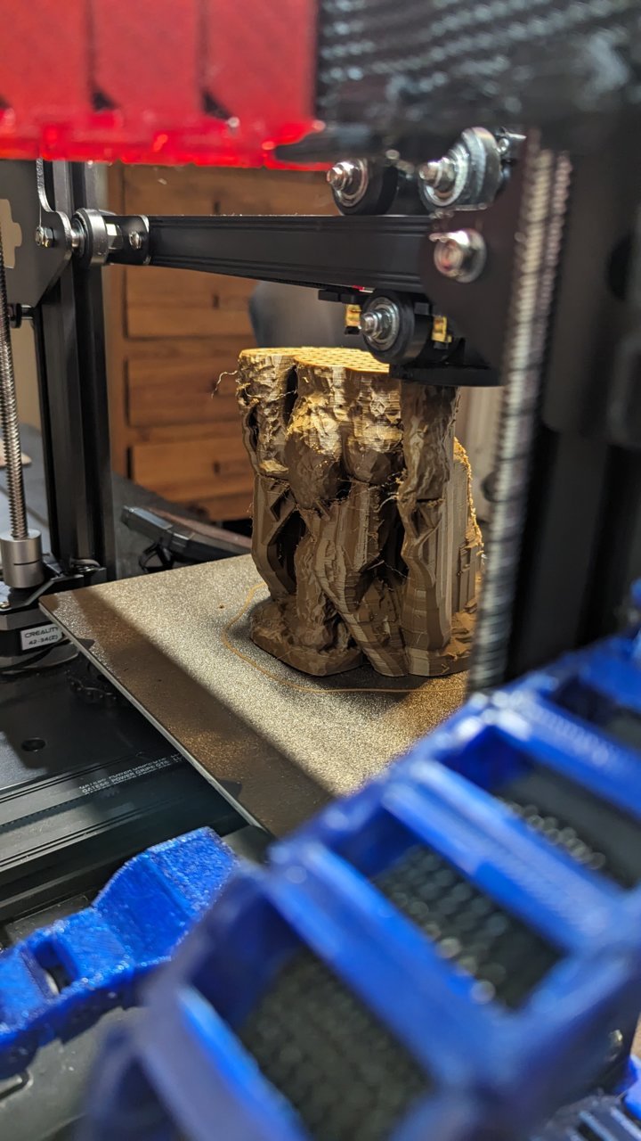

    Well we just completed Bigfoot's chiseled ass. Maybe by this time tomorrow I'll have a new mascot for the camper.

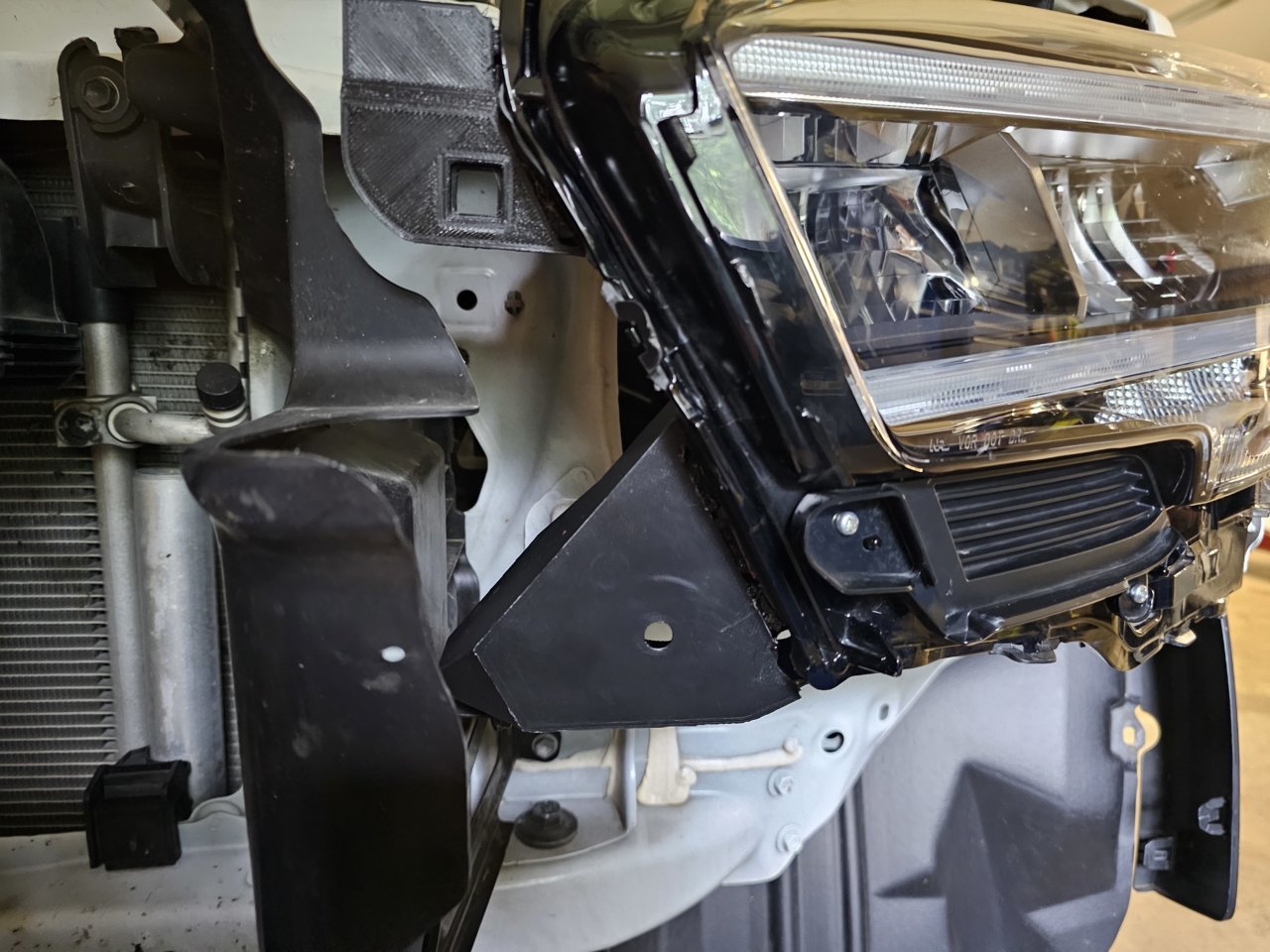

    Led headlight mounts.
    FINALLY have my leds installed

    What filament did you use?

    Inland ABS

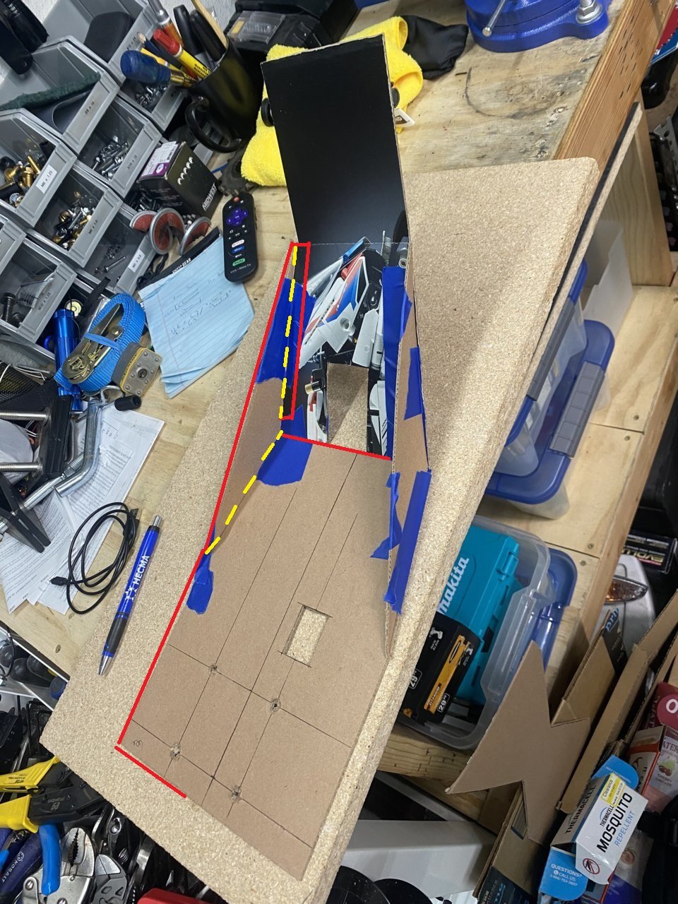

    I worked on it today! Even broke out the good cardboard for it. Might actually end up printing a spacer for the rear of it so I don’t have to fold/weld up a mount to space it off the engine. And I need to figure out how I want to attach the two halves of it. I need it to come apart at the big hole in the middle. Sounds back-asswords, but it’ll actually go above my exhaust. The exhaust on a grom hangs so low I think it looks awful having a plate that far down, and the skid plate is more for looks and rock kick-ups than actual bashing through a rock garden or anything.

    I'd incorporate those side "wings" into one of your pieces with a lip extending from each one and a nut welded on the inside.
    That way you can attach the other plate to the lips on each side with small M6 or M8 bolts.

    Funny, I had actually thought about welding a nut on the inside, but wasn't sure if I wanted to do a slightly recessed plate with rivnuts instead. I'm probably going to end up not having the big flap up top, either. I don't want to run giant braces up to it. Might print something for that space, too, since it's way above the header and won't be getting hot, it could flap around and just block debris with relatively little strength needed.

    Simple!
    Red outline is all one piece.
    Yellow lines depict bends.
    The black part is your first part of your skid and will mount to the second part of your skid with that overlap.
    The overlap would have nuts welded on the inside for you to run bolts through.
    Just an idea of course!
