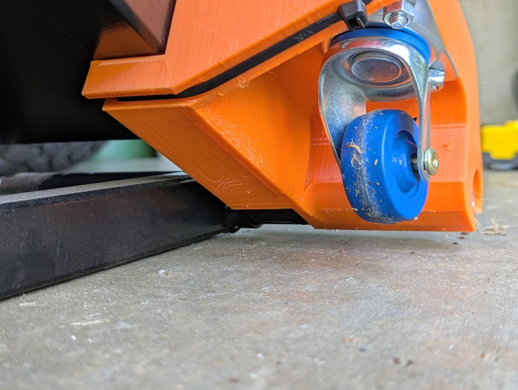

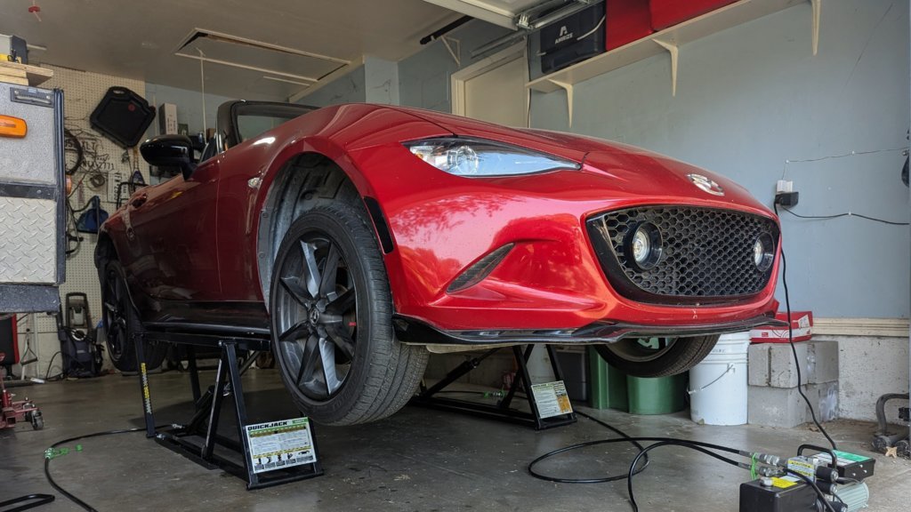

    I picked up a QuickJack so I can squeeze my fat ass under the Miata a little easier. It must be modded, because of course it does
    The problem, all of the fine positioning tends to scratch up the floor pretty good. Plus, the jack is heavy. Especially if you're moving it while leaning and crouched. That sound was my L3 disc ricocheting against the ceiling.

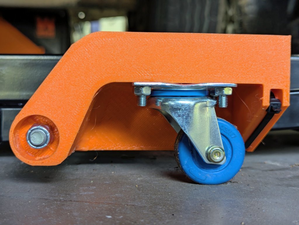

    I found a model for caster wheels that I really liked, but it was for a different frame size. The model was for the 7000 frame, and I have a girly-man 5000 pound lift. Whelp, it's time to practice some tinkercad editing.
    I went through many iterations and so far have thrown out at least two spools of filament. By the time I'm done, it will have taken me 2.5kgs to print the final, and I'll probably have thrown away 3kgs. I just bought Anycubic a nice dinner.
    Here's version 1, rear, next to version 3, front. There are a few obvious differences, but there was also a lot of fine tweaking to the internal structure and hardware locations, to make the geometry work.
    And then the rest run. This is the version 2 setup, but here's what I'm after. Make that bastard roll across an unswept floor like a high dollar creeper.
    There are two absolute requirements:
    A) make the jack frames easily rollable/positionable while keeping the added height under 1/2" (the lower the better)
    B) I absolutely positively have to see daylight between the ground and the printed part before the jack makes contact with the car. This ensures that the jack frame is solidly planted on concrete as originally designed.
    Yeah, it's obvious my garage is way overdue for a good broom pushing. I'm procrastinating by doing this stupid crap. :anonymous:

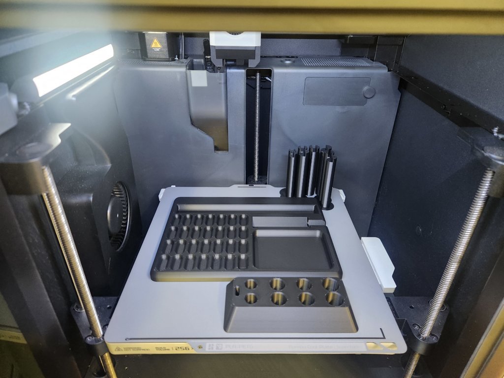

    Been getting into locksport (the art of lock picking) and needed some accessories. Printed a pinning pad and some plug followers/stand.

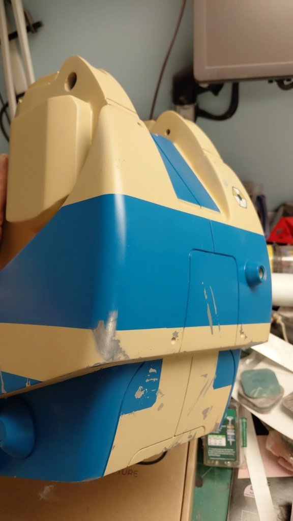

    Got a splash of paint and have the very beginning of the weathering process started on my 3D printed life-size B1 Battle Droid

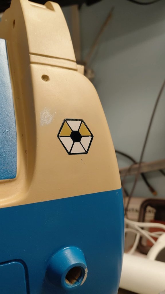

    After a few months of leisurely 3D printing, priming, painting and weathering my 1:1 life size B1 battle droid scout is now complete!
    We put Scout in our fireplace room so he can check for Clone troopers.....
    (Hint, they're closer than he thinks)
    The infrared PIR motion sensor in his chest also activates a micro SD card in his chest, hooked to a speaker in his back that randomly spouts 1 of 105 B1-isms. It's a good laugh when he says something "appropriate".
