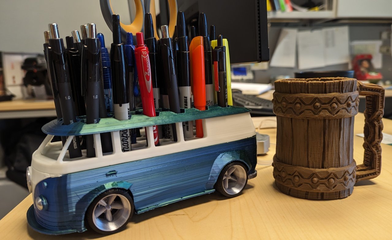

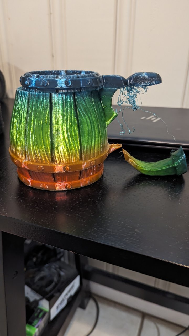

    These are two recent examples. The van probably exhibits every possible mistake one could make, but I love it anyway. The wood beercan coozie is a little more realistic on the resolution that I'm getting as a beginner, on a standard 0.4mm nozzle. I could swap to a finer nozzle to smooth out those layers, but as was said before, it's never going to match resin quality.

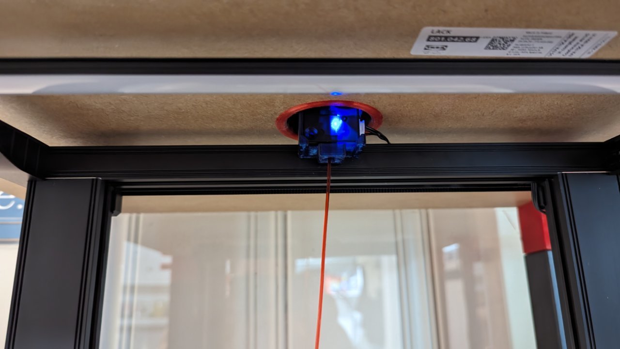

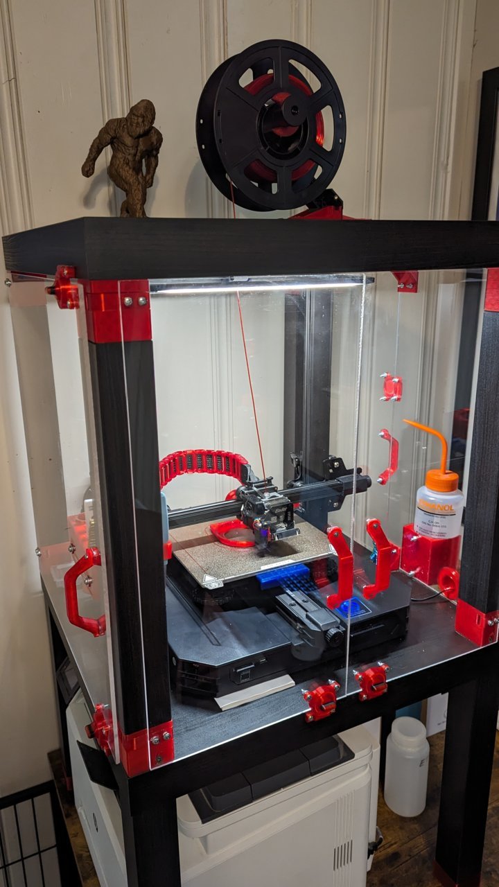

    Been building all week. I just now started hanging plexiglass.
    Finding a place for the filament sensor has been a challenge. I'm not sure I like this setup. It gets chattery on even medium sized prints. I'm thinking of making a recessed can so that the sensor mount sits halfway up into the ceiling, then let a couple centimeters of Bowden tube hang underneath so that it's not tugging laterally on the sensor brass. Think that will work?

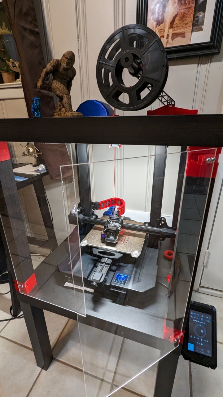

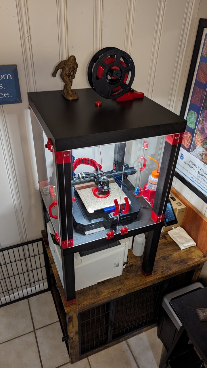

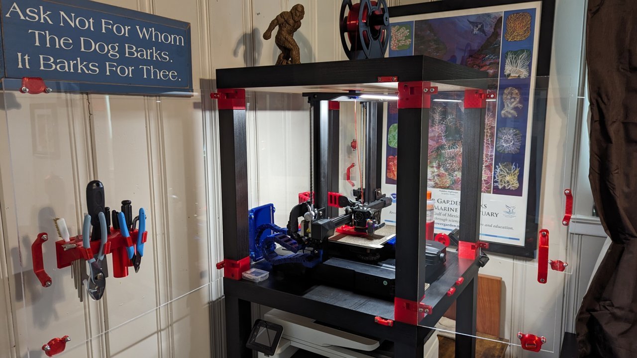

    For a complete improvise-as-you-go, manic frankenstein smash job, I'm pleased as punch at how the enclosure build went. It's a little, uh, taller than I intended, but it's a righteous utilization of the office/mud/dog/craft room.
    I still have some fine tuning to go, but I love that the little machine is not heating the room nearly as much.
    Doors on three sides, tool rack tucked neatly on the inside.

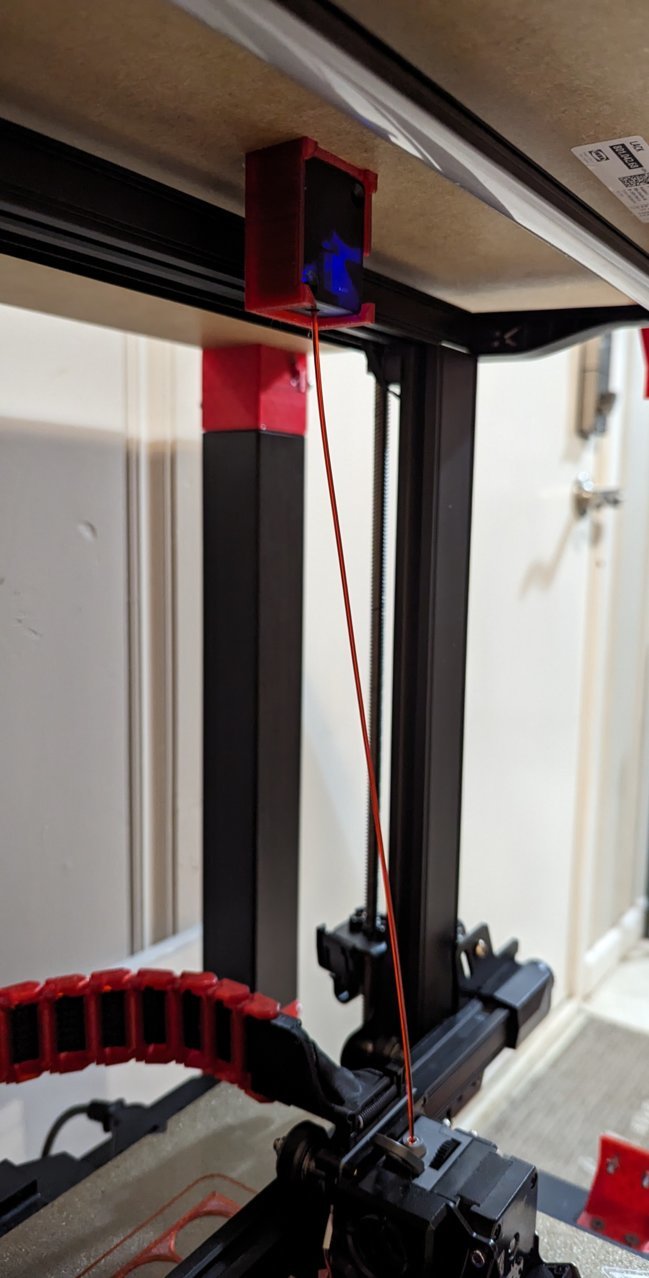

    I recessed the runout sensor into the ceiling and added a socket for installing a Bowden fitting. Raising it those two inches smoothed it out so much that I might not after all. I'll see how it does on the taller prints for a while.

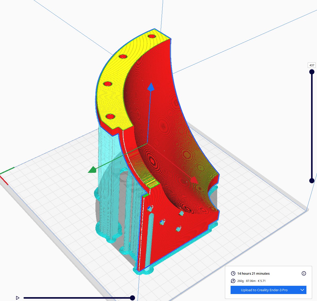

    14 hours for 1/8th of a 10" Ulbricht Sphere? Sure, why not! Been wanting to mess with one and this is easier than the other methods of making one, and cheaper.
    Just a test this round as the layers are likely FAR too thick near the bottom, actually likely all the way around.
    The design is set up so you can print the whole sphere just by mirroring 4 of the 8 parts, however that isn't going to work for the holes with threads....so maybe threaded inserts for the final.
    Still need to do the buffer and the fill plugs/adapters for the four ports.

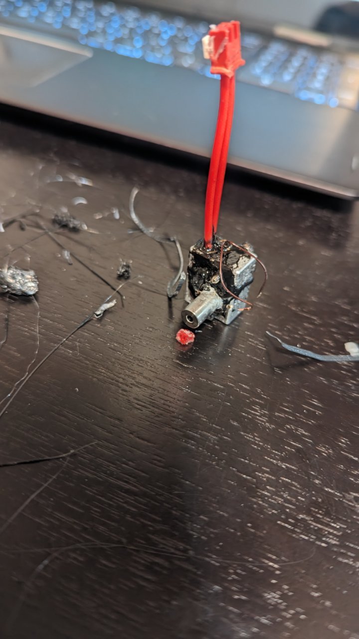

    Ok. I'm curious about expensive lessons - whether everyone does it, whether my printer is weaksauce, or whether I'm just a dumbass.
    So first I drilled a trench in my bed due to z offset malfunction. Cool. 25 dollars for a new bed.
    Then I had a print where the PLA curled up and wedged into my touch sensor, putting a hairline crack on the sensor mounts. 40 bucks for a new sensor, plus about two thirds of a spool wasted. Let's just say it took a minute to figure out why I couldn't seem to find level. :anonymous:
    And today... well fuck today. After a solid week of perfect prints, blobs the size of Buicks started showing up in my prints. Turns out the nozzle threads in my hotend were slightly boogered. And a pool of molten plastic had been apparently accumulating between extruder and hotend all week, only to be unleashed all at once Dante's Peak style.
    Kay. Fuck. 40 bucks for a hotend. Fortunately I narrowly escaped paying 110 bucks for said hotend after I clumsily discovered that the connectors are rubber-cemented to the circuit board by default.
    :bananadead:
    Is this learning curve of hard knocks par for the course, or am I a big galoot in a china shop?

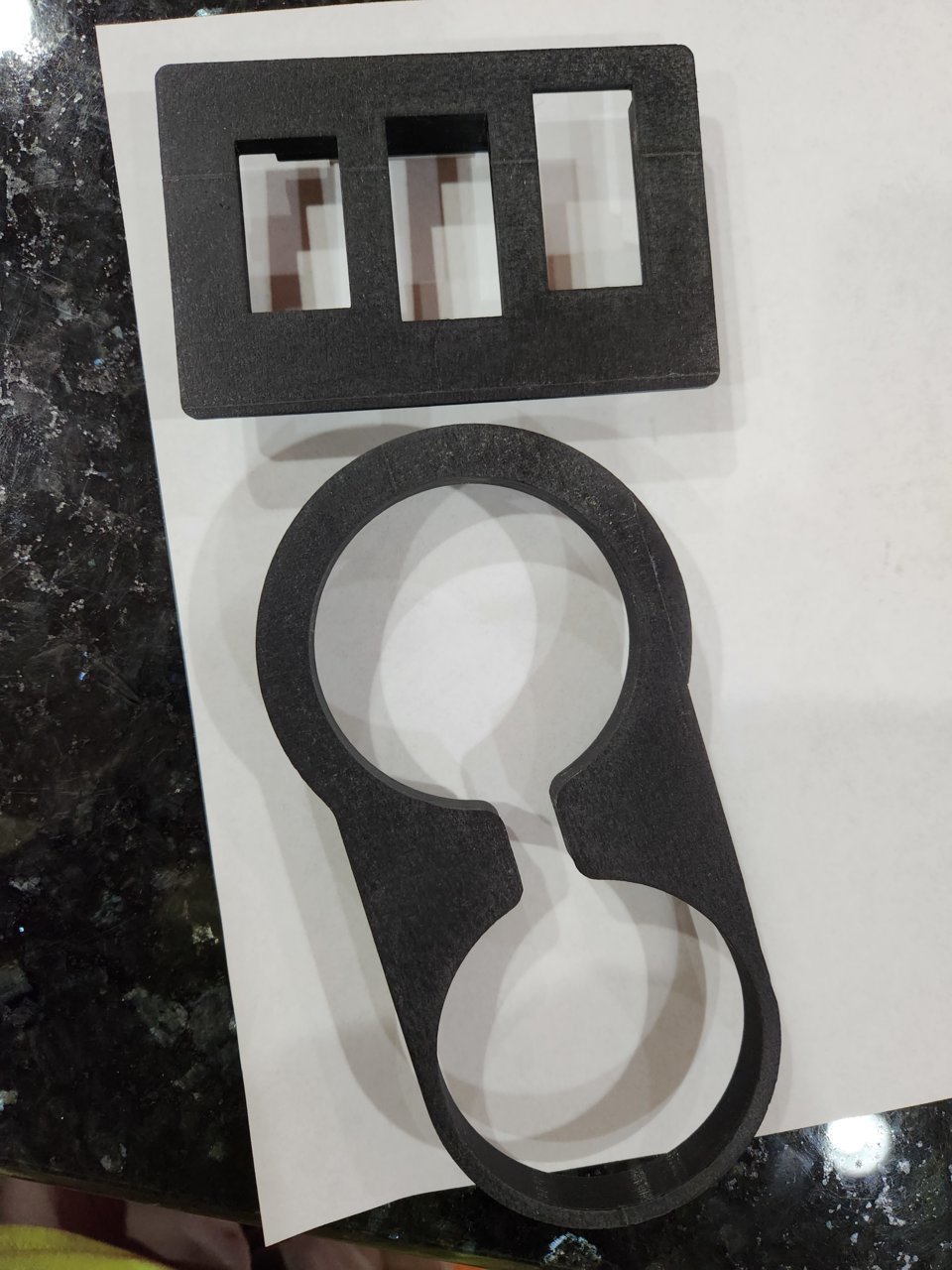

    Printed these the other day for someone...

    I always stick around until the first two layers are down. Failed prints don't sting as bad as broken equipment though. I'll own the hotend as my fault - I swapped a nozzle when it was at temperature, which i suspect is the reason why the threads got stripped.
