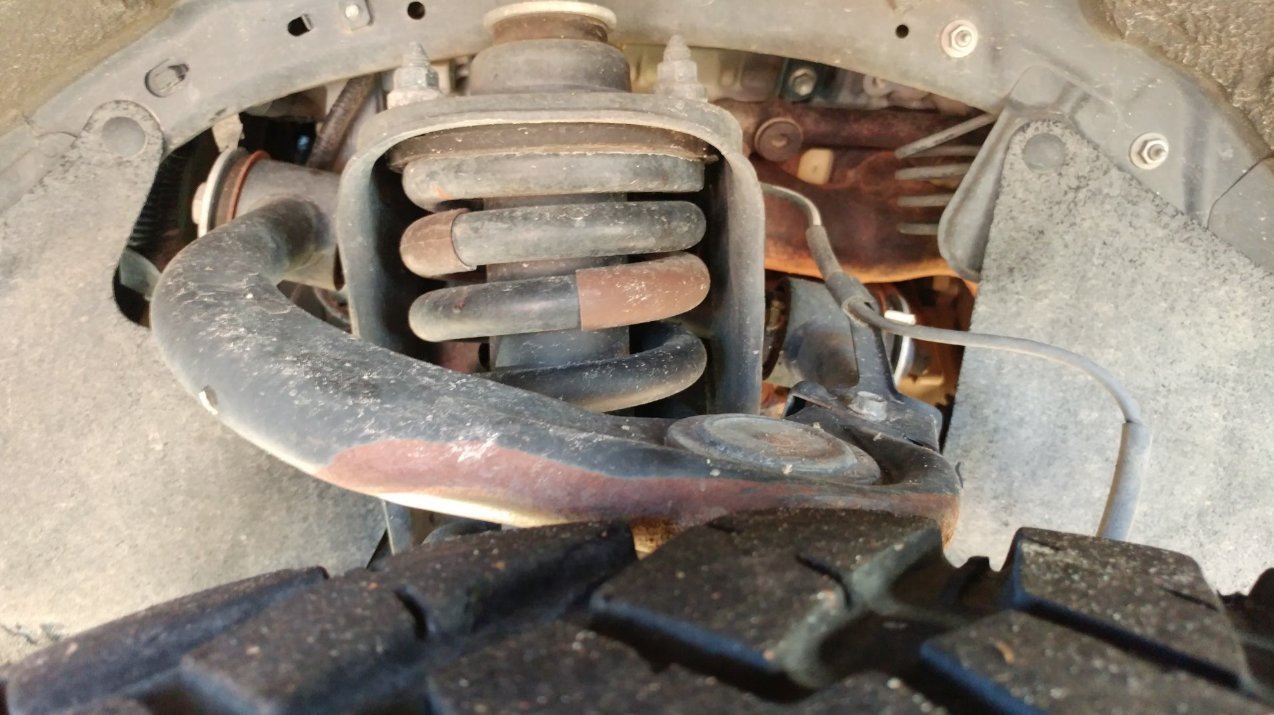

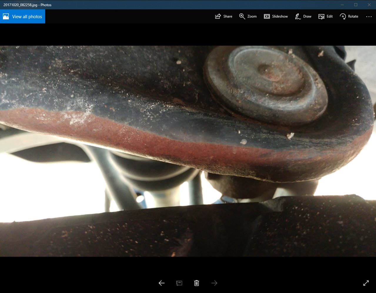

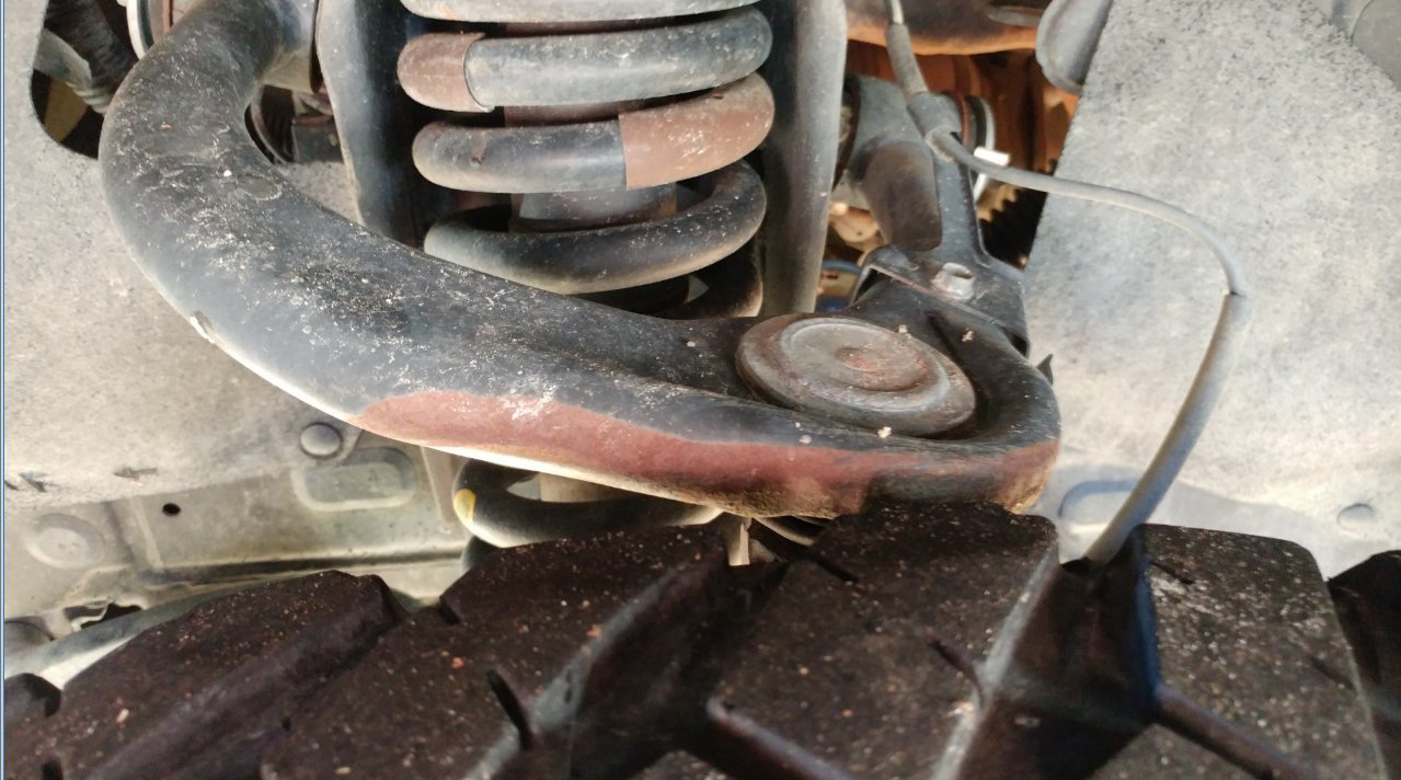

    I have 285's that came with the truck when I bought it. I like the height and the look, but it rubs my UCA if I turn hard. I am new to trucks, lifts, tacomas. So what do I need to do to clear the UCA? leveling kit? lift kit?

    What suspension is currently on the truck? Pics help..

    Wheels with less backspacing/ more offset than stock
    ~2.5” lift
    Ucas
    :sawzall:

    Lifting it 3/4" more won't really help with rubbing. It's more about finding the sweet spot for the tire in the wheel well. 4.5" backspacing wheels seem to work for most to clear the UCA. But then you may rub on the fenders or body mount. Fenders are no big deal, you can use a razor knife to trim away the extra plastic and it's not even noticeable unless you were specifically looking for it. The body mount is a bit more involved and may or may not be necessary. Search CMC (cab mount chop). Basically the body mount protrudes into the back side of the front wheel well and can rub on larger tires. It can be cut back by about 1" to make more room with no effect on it's function as a body mount. If you do cut it back, you'll need a cut off wheel and then most people end up welding in a plate to cover up the exposed body mount guts but that's just cosmetic.
