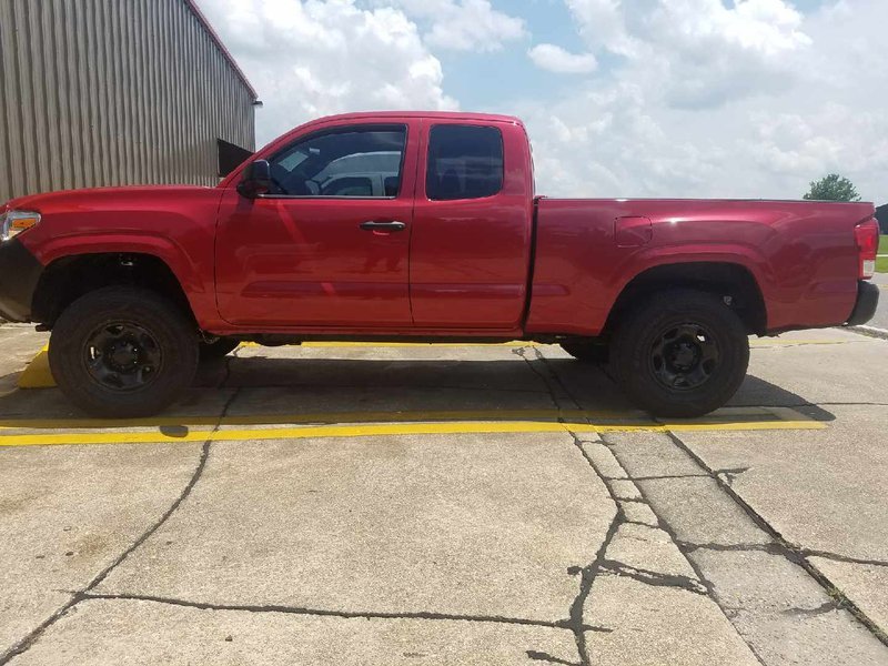

    I did spacers and they work great for me. Granted my truck will never be a serious offroader.
