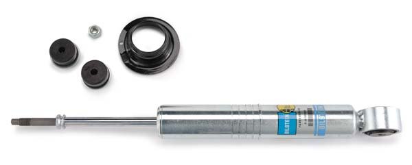

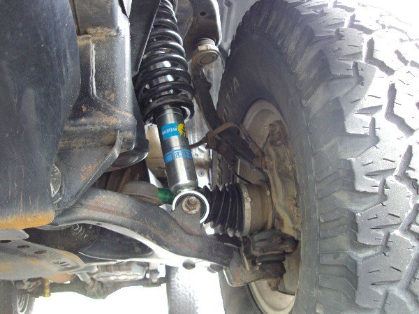

    My 5100's came with new grommets (bushings) & washers for install, below are a few pics.......:cool:
    The one picture of the new shock is exactly how it came w/ new hardware,etc;...:cool: If you've never replaced "coil over" shocks you need to fully understand the dangers involved, notr the nut I'm pointing at in pic, this nut should NEVER be removed until the coil spring is safely & adequately compressed w/ coil spring compressor, anyway the nut in question is the nut that holds the "pre-load".
    If you just try to take it off without doing the afore mentioned proceedure, you stand a very good chance of being severely injured or in some cases, fatalities have occured. If you already know this, I'm sorry for boring you with it & if not then take heed in everything I mentioned to you, hope this helps...........

    one more note: There are no specific applications for 5100's for 1st gen. The shock is really spec. for the earlier Tundras, also my 5100's have 4, thats right ,,, 4 settings from stock(bottom groove) up to 2.75" (top groove) alot of guys here think that 2.50" is the 3rd & final setting, I'd tell them to look again. (count your grooves in shock body)

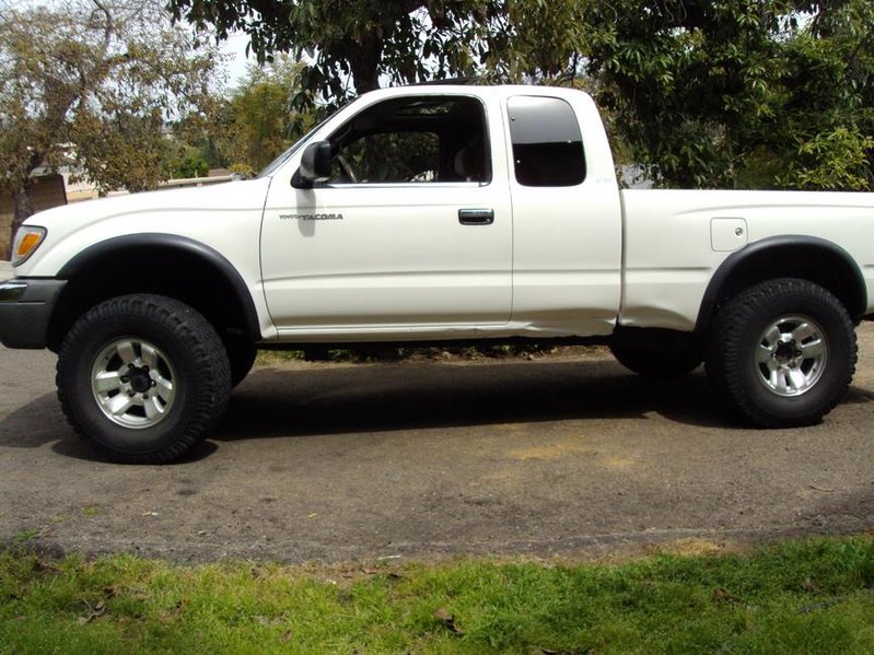

    The front looks higher than the rear...maybe it's just the pic...

    No, you are correct theres a little rake to it seeing how I'm still stock in the rear, I had to listen to all this shit about how I have a "bro'" truck now.
    I didn't even know what a bro' truck was...haha:D
    Hey, at least it isn't an F-150....:D
